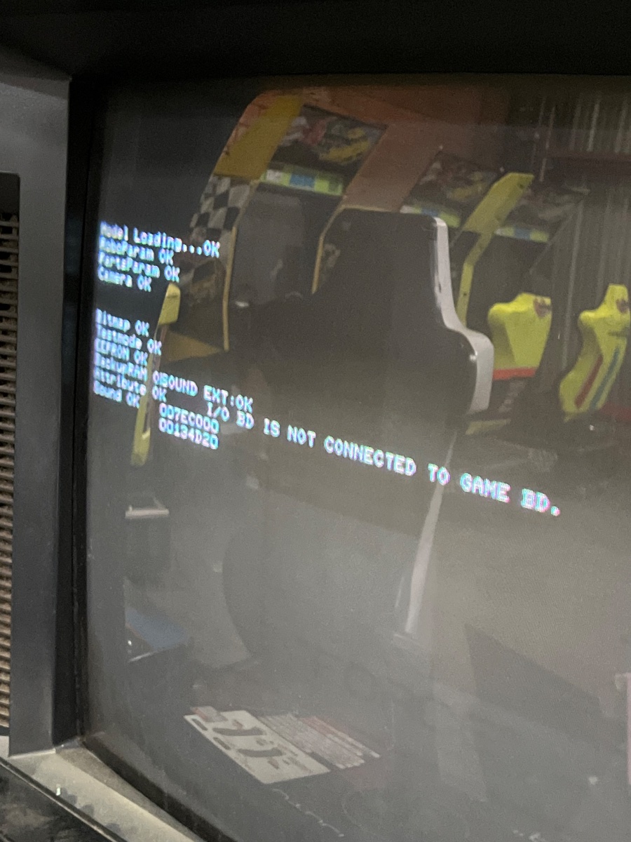

When I turn on my Virtual-On Force twin, the master site boots up fine.
Seat two however gives me the error:
“I/O BD not connected to game BD”
I rechecked all the cables on the back of the cab and the ones that go directly to the Hikaru. What might cause this error?

you'll get this error if anything wrong in the chain: 315-6146 I/O MCU -> ADM485 IC80 -> CN2 connector -> filter board -> JVS connector -> cable -> JVS I/O board.
in 1st place worth try to replace JVS I/O and its cable, if it doesn't solve the problem worth to check if JVS connector at filter board is not lossy/broken, and also reseat filter board and make sure mobo's CN2 sits well with it.
if this will not helps it's probably something really broken in described above chain, like fried ADM485 transceiver or something else.
btw, may I ask you about small favor? take a photo of BIOS CRT test page 2 (the one with full screen grid)
