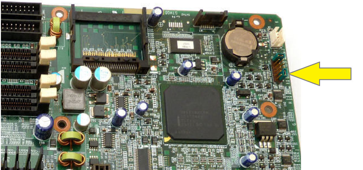

Try setting this jumper like this, boot it and then put back as it was.

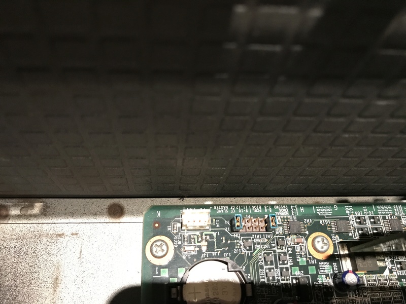

Figured it out, the reset position is as pictured here, the image you sent is the default that it should be in. All is working now!
