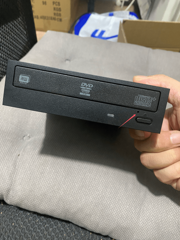

Every DVD drive has a hole on the door when it leaves the factory. This hole is prepared for the convenience of the drive when it does not come out of the door in the future. So we need to prepare a pin.

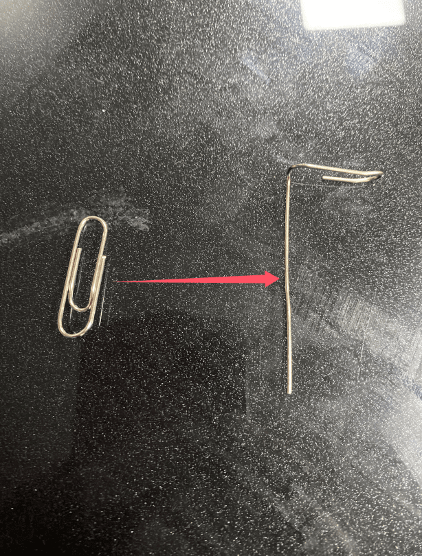

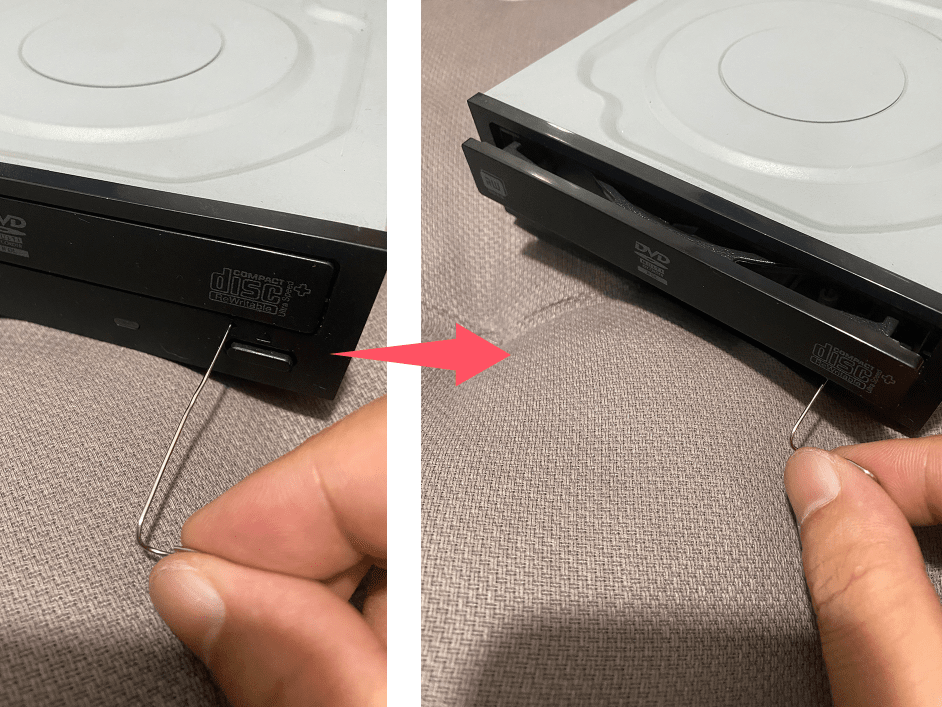

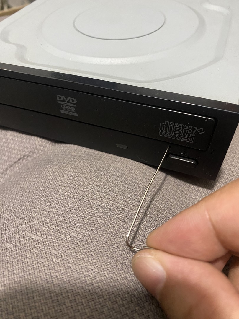

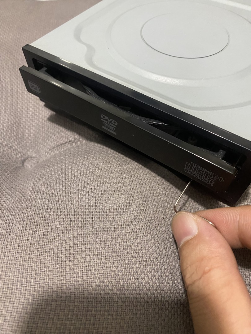

Then modify the pin to be long and insert it through the hole. This action is the same as taking your SIM card out of your iPhone.
If your DVD drive sometimes opens its door and sometimes does not, you can wait for it to open and then perform the end-break process to keep the door open as long as possible.

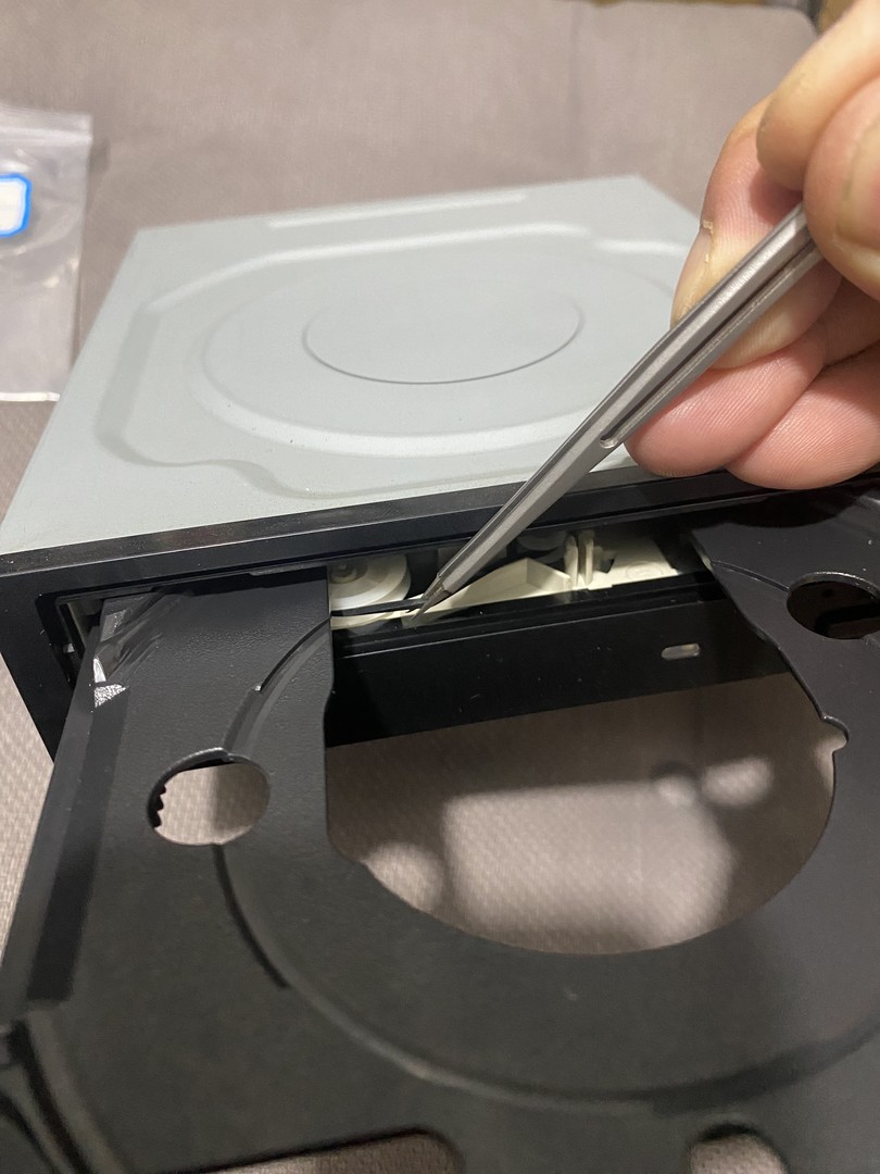

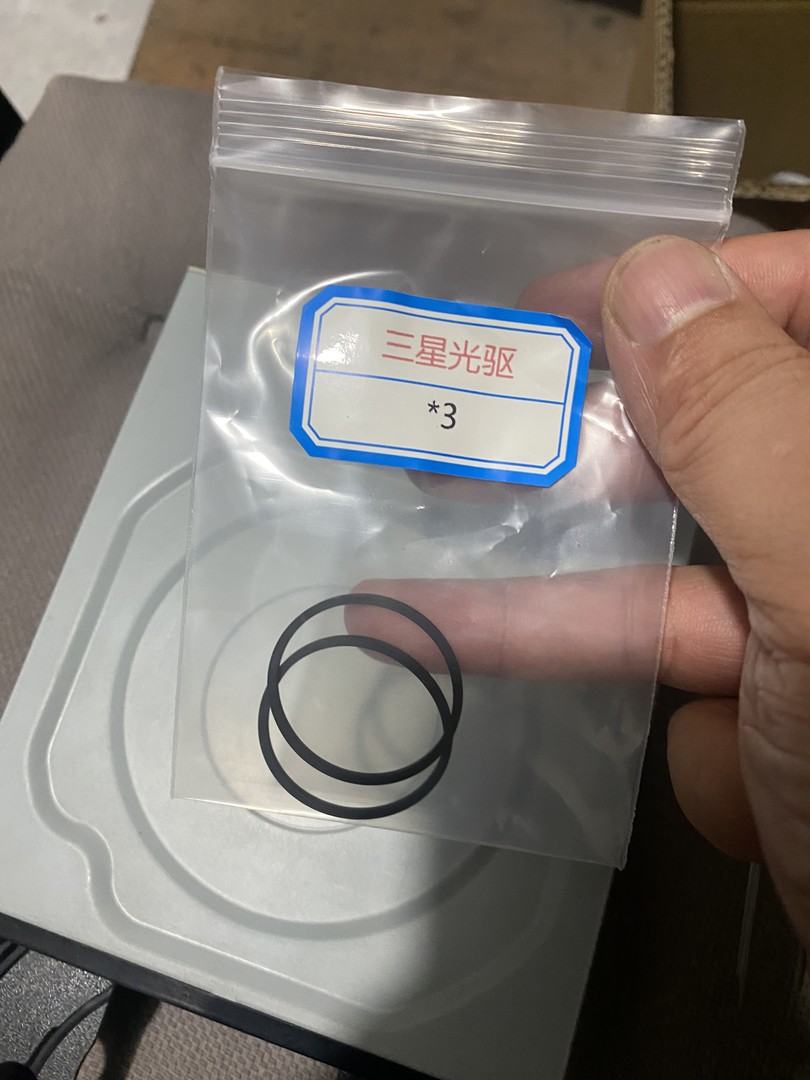

Prepare the black belt and tweezers, replace the old belt and it will be back to normal. This process does not require you to disassemble the entire DVD drive, you can quickly replace the belt and keep your DVD drive in the same condition as when you bought it.
The length of the DVD drive belt is divided into two length specifications. When purchasing, be sure to make sure that both length specifications are available.
