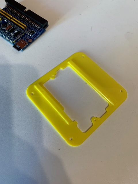

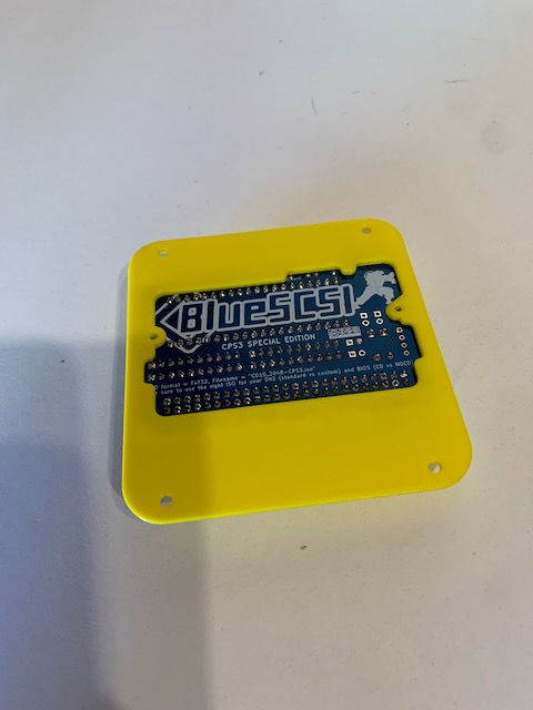

Hi Team;

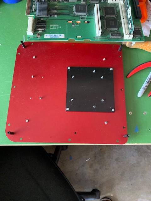

The CPS3 custom metal case from TRfightstick is absolutely awesome. Underneath the board is a mounting plate for SD2SCSI.
But I don't have SD2SCSI - I have BlueSCSI(v1) what to do?

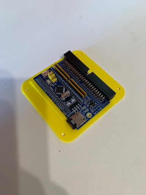

I drew this adapter which fits in the SD2SCSI mounting holes and adapts for BlueSCSI(v1). Unfortunately I'm still addicted to Sketchup Make (2017!?!) need to move my workflow to Blender/CAD Sketcher...
You will need
4 SD2SCSI mounting screws (supplied with the TRfightstick case)
2 x M2 or M2.5 bolts 5mm in length
2 x M2 or M2.5 nuts
Printed adapter, Capcom Yellow and Blue colour scheme
STL's attached in "TRCPS3bracketv3.zip"
