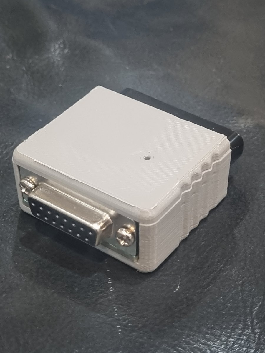

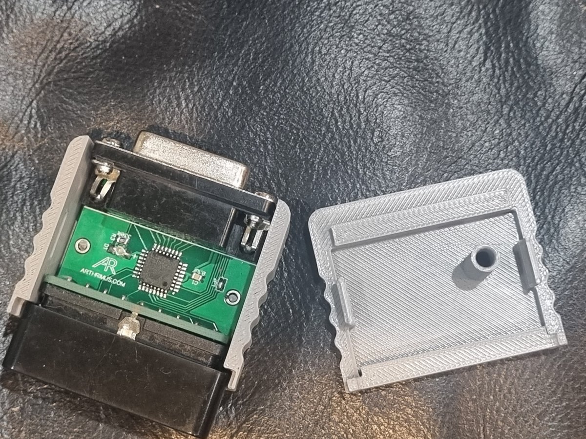

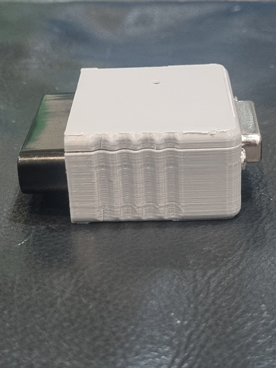

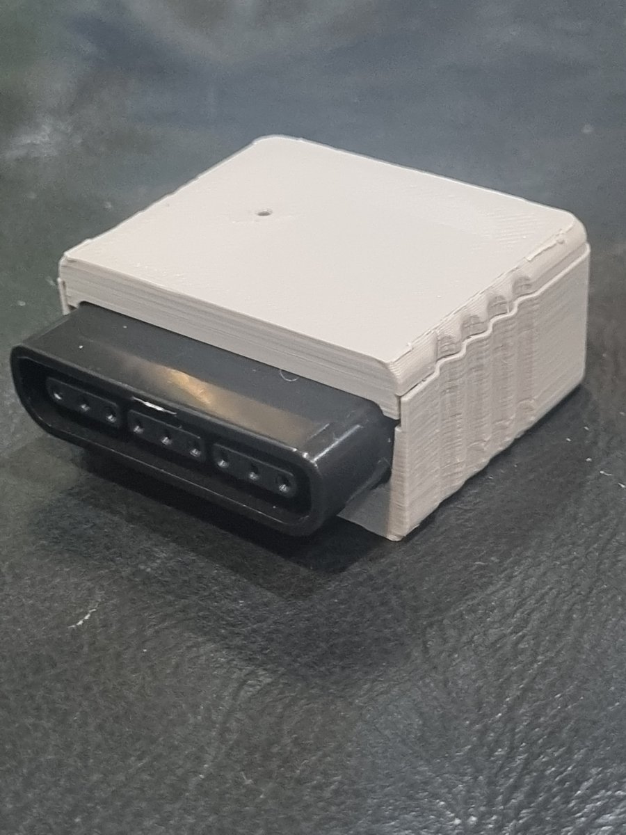

I couldn't find a case for this open source project. So I made one.
Snap together because i don.t like how screws look. Not sure how well the led tube is positioned it works ok on mine but I used really old SMD LED's I had on hand, other designs may need a slight adjustment. The tube is designed for 4mm flex pipe but works without faintly. The pipe should run the whole length of the tube and sits just below the hole on the top. If anyone has problems seeing the LED let me know and ill relook at it.
