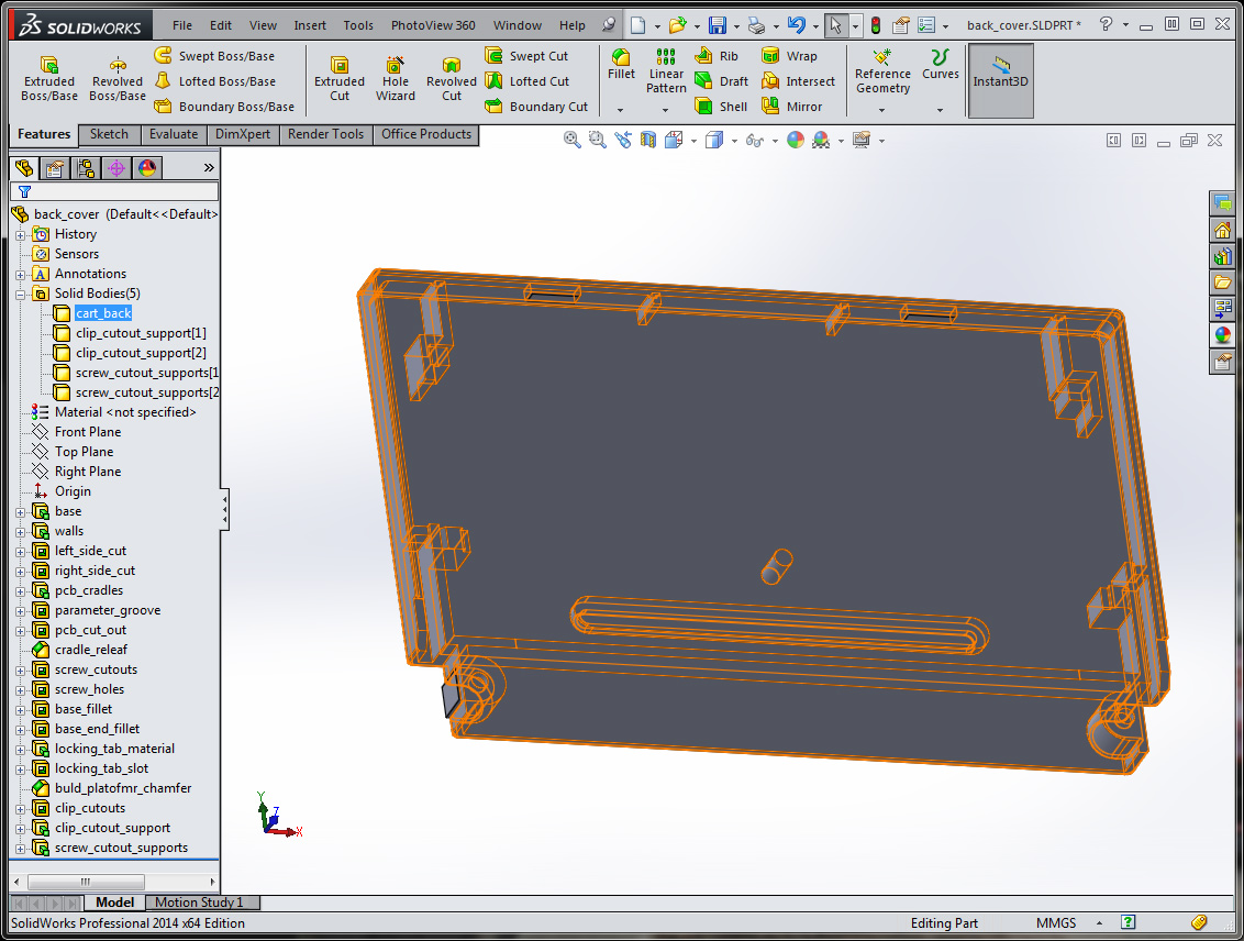

I started designing a 3D printable replacement cart housing for ST-V so we can use that instead of de-casing otherwise working games.
I've got the first revision of the back cover done so far (it's printing as I type this):

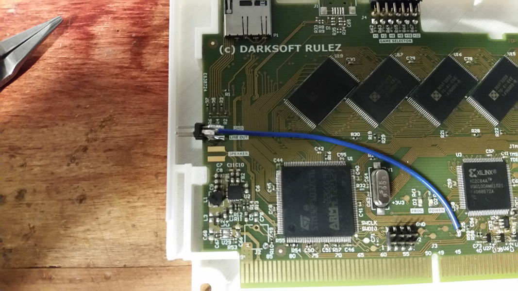

I'm thinking if you take a 2 pin header and solder one pin to the line out with the other pin in some dead space that would give you a decently strong mounting point and you could then route the other side of the second pin to the solder point for the reset. that would give you a 2 pin connector off of the side.

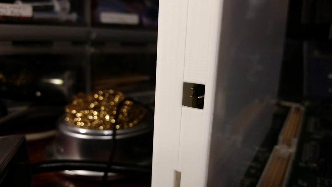

Here is what I've done to support externalizing the "optional" pins...
I took a remanent piece of some pin headers I had lying around and soldered them sideways off the edge of the PCB. The two pins on the bottom are soldered to the GND and Line out pads while the top pin has a wire run to the reset solder pad.
Then in the front cover I supply a notch along the edge so you can access the pins.

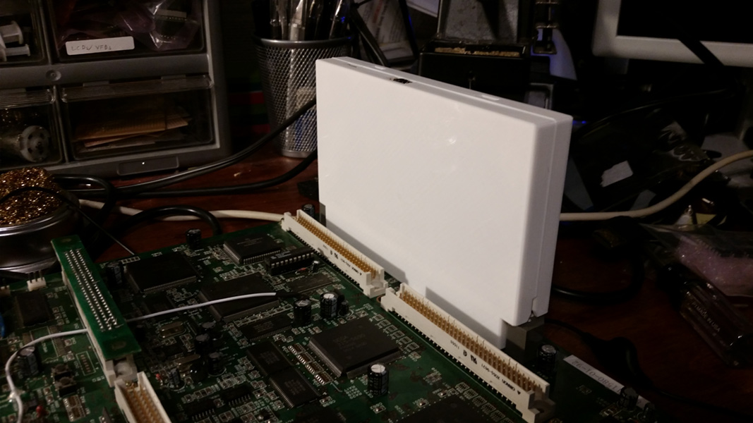

Here's an update where I'm at.
fitment of the PCB internally and the case with the main board is excellent. fitment of the two halves is perfect with each other and when matched up with the matching halves of an original ST-V case except for a small issue with the clips along the top which is causing a small misalignmentalong that edge. the material thickness along the cut outs in the back half is too much so I've removed some material there which should make everything snap together better.
You'll notice that I got rid of the big ugly notches in the top o the case, that's part of the reason for the misalignment because I had to guess at the clearances and was off a hair.
I'm pretty happy with where I am with this, I have the next revision with adjusted clip clearances printing now so we'll see how that goes.
Yup, that was almost what I had in mind. :thumbup:
