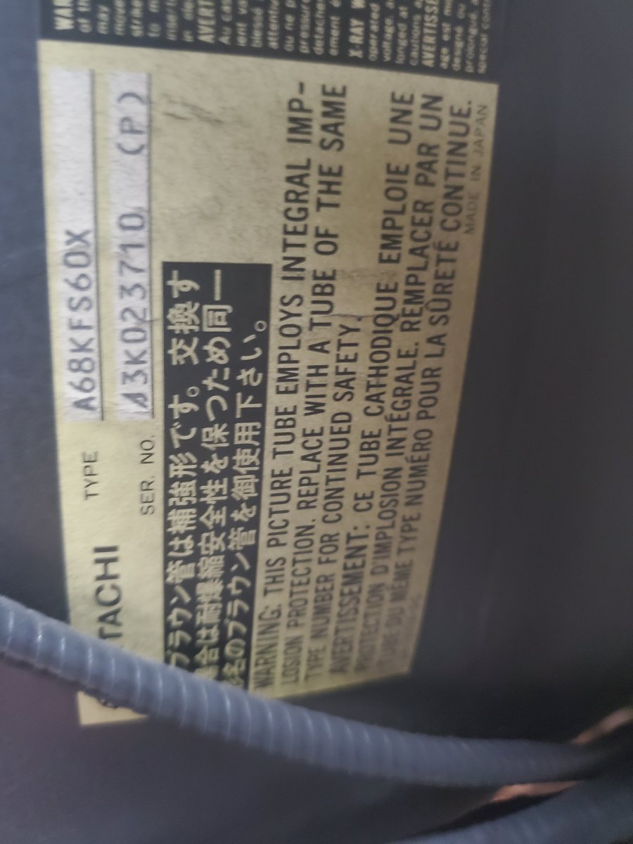

darksofter Enthusiast Joined Aug 24, 2015 Messages 295 Reaction score 111 Dec 22, 2023 #24 I found this in my candy cab A68LFP227X. My goal is to pair it with a nanao chassis and eventually mod it to a 31khz monitor. Attachments IMG_5487.jpeg 211.2 KB · Views: 91
