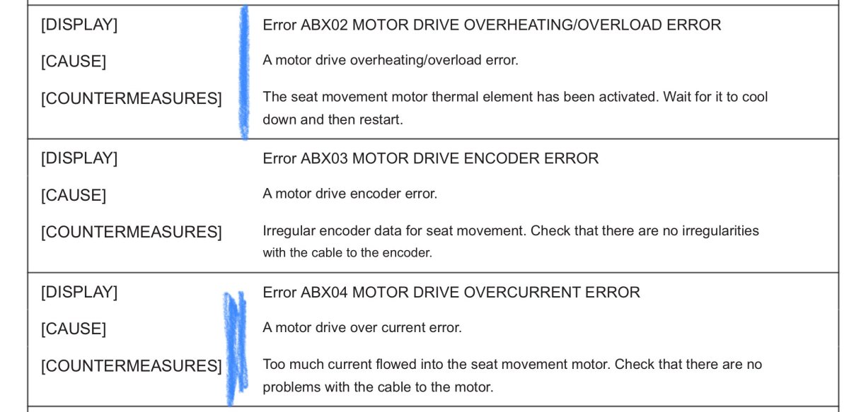

We got in an after burner climax deluxe where the seat will not move and on started up I just get "Error ABX03 MOTOR DRIVE ENCODER ERROR". I think it might be an issue with the RS232 to 422 BD 839 - 1256R board but I dont know for sure.

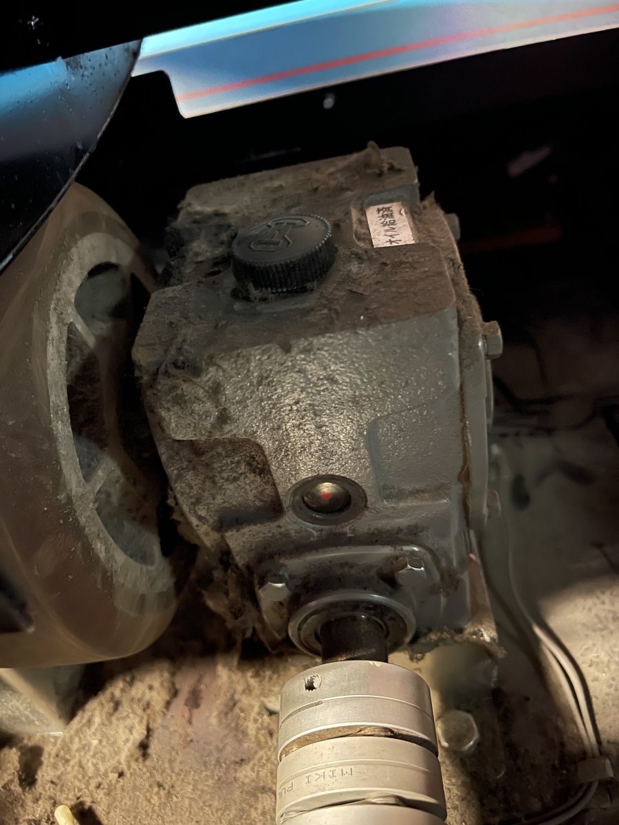

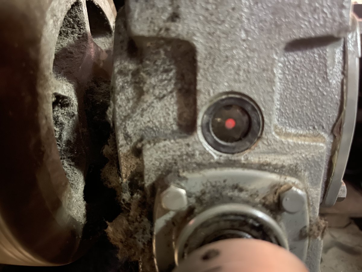

Looking at a similar issue and I am wondering if oil of some kind is required in there?
The game was giving error abx04 when I arrived. Unplugged and Replugged and now giving abx02

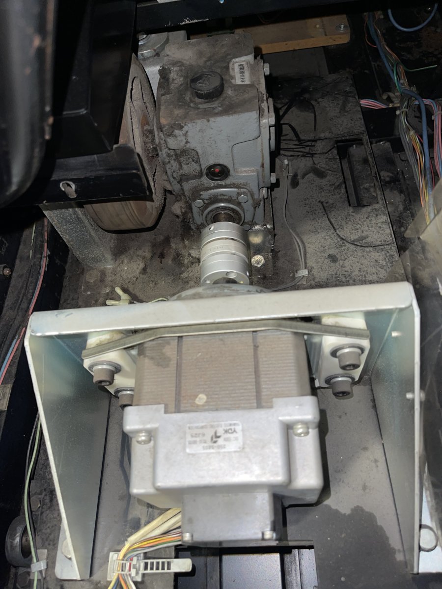

Motor appears to be hard stuck. Edit: I am now thinking perhaps the brake is stuck on?

Ps : I can hear the motor “trying” here it is:
