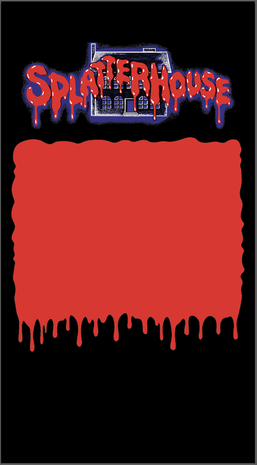

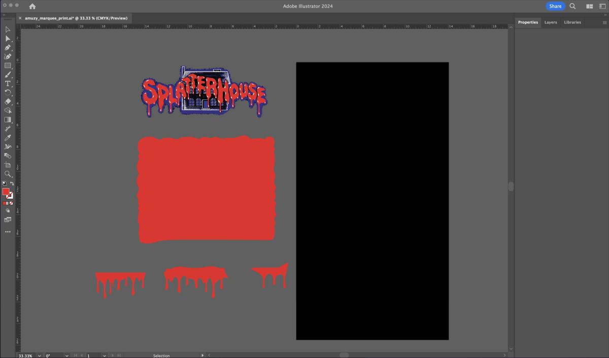

While that was drying I worked up a marquee/CPO in Illustrator. Since the current plexi is reverse printed with the Amuzy art I'm going to get it printed on laminated CPO vinyl and slap it over the top to cover the existing art.
This is what I came up with. Here's a test print on paper. I need to adjust the red monitor border and I'm thinking I'll leave the CPO black since I'm using red buttons and a red ball top. With the drips it looks a bit too busy.

Sure, the process was pretty straightforward. I measured the existing Amuzy acrylic bezel plus the control panel and then added some bleed. Mine ended up 14 inches by 26 inches. I'm pretty handy with Photoshop and Illustrator, but I'm not great, so the creation of the actual graphics was just time-consuming trial and error. When I had something I liked, I printed it out on 8.5 x 11-inch regular paper sheets so I could tape them together and do a test fitting. This part was crucial, as I had to tweak things a few times. This was my final product:
For the actual graphics, I found a high-DPI image of the Splatterhouse marquee and removed the black background using Photoshop. I created the red blood monitor surround by hand in Illustrator and then found some drip graphics online that I vectorized and modified.
If you can't find any suitable high-DPI images for your project then you can take a lower resolution image and trace it by hand. The time to do this varies wildly based on your skill with Illustrator and it can be a painstaking process. I traced a move strip and sign over here and I'm probably 35 hours deep in that project due to the endless tweaking.

Once you get all the artwork vectorized you can move/stretch/scale it however you want with no loss of quality, so it'll be really easy to use it in other projects. I haven't had mine printed on vinyl yet so I can't comment on the finished product. Mine is one solid piece, so I think cutting out the square monitor opening in the center might be a bit challenging to get it centered with straight cuts. You could add some cutlines in Illustrator and have the shop do it but I didn't bother with that.
