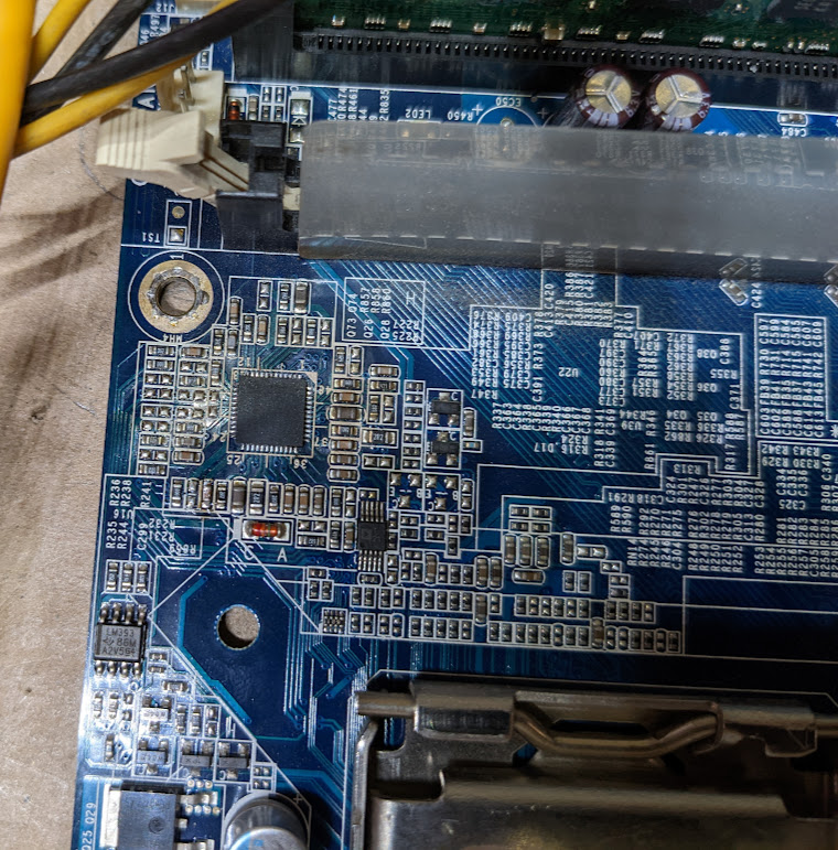

- CMOS Reset => no change
- CPU swapped => no change
- Checked the voltages on the CPU MOSFETs: Only one of the four power stages delivered a proper output (drain) voltage. => Issue with the CPU power regulation.
- Checked the MOSFET circuits for shortages => no issue found
- With a scope I could see some of the MOSFETs pulsing, but not regulating to a proper voltage. => Obviously a PWM issue.
- Checked all resistors and diodes around the buck converter circuits => no issue found.
- Replaced the PWM buck converter ISL6312 CRZ => Problem solved
- This repair requires expert SMD soldering skills and proper equipment. Always apply good flux before soldering and only a little solder tin.
- The motherboard needs a lot of steady heat for the solder to get molten. And the buck converter has a big grounding plate on the bottom, so it needed easily 5 mins at 340°C with the hot air gun before I could carefully remove the part.
- The replacement part has to be aligned with a hot air gun so the grounding plate can be affixed exactly in position. After that apply flux around the contact rows and carefully drag-solder the IC. Double-check for possible shortages with microscope and multimeter.
