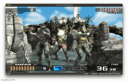

Hey, reviving this thread! I've been trying to do this for my Time Crisis 3 DX cab! And I believe it is very possible:
See https://twitter.com/steeve/status/1584192357737517056?s=20&t=5EnJsNaCzwVR3RFjRBx_3A and https://twitter.com/steeve/status/1584471380992544768?s=20&t=5EnJsNaCzwVR3RFjRBx_3A

Yo! What the hell! TC3 arcade widescreen hack!!??? Oh I’m definitely going to try this soon! @steeve Do I edit the dongle or the DVD file and burn it to a blank disc? I do have the multi dongle and the original bin files, I could probably try this today.
Also, I recommend getting the Crisis Zone MIU pcb over the rays pcb as it’s more affordable/reliable unless you want to play vampire night.
Be aware though, the aim is off! I just discovered that!
I'm gonna try to fix it, although not sure yet how, but it seems doable.
Also, the TC3LOAD image comes from timecrs3-tst1vera.bin, but I can try my luck on timecrs3e-tst2vera.bin if you want.
The patch is, at offset 0x002d082e, replace 0x80 by 0x40.

Be aware though, the aim is off! I just discovered that! I'm gonna try to fix it, although not sure yet how, but it seems doable.
Code:
0x002d082c
That’s fine, I believe I have both versions in my dongle files folder but I’ll have to check. if you can, check the other versions out and let me know if the offsets are the same :)
Alright, for TC3LOAD of timecrs3e-tst2vera.bin, the offset is 0x002d302e, replace 0x80 with 0x40. Remember the aim is off!
For easier testing, the offset inside timecrs3e-tst2vera.bin itself is 0x00227CAE, same replacement: 0x80 -> 0x40.
I stand corrected with the offsets inside the TC3LOAD! These are EE addresses! Try it with the 0x00227CAE offset, which is inside the dongle image itself.

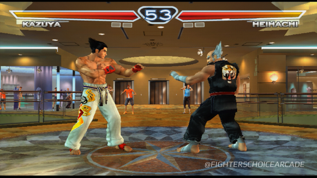

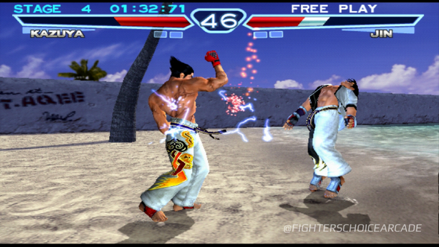

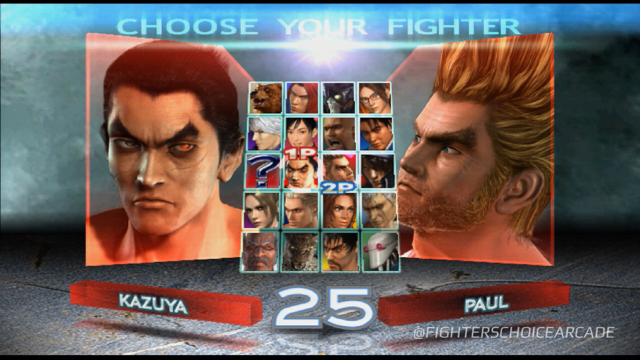

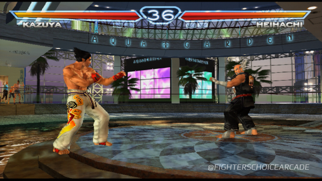

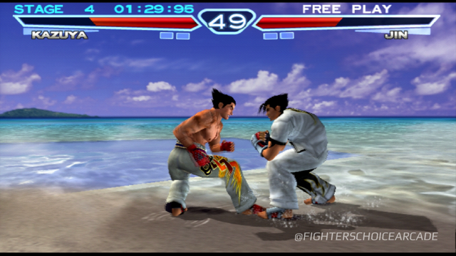

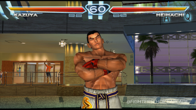

Cool update post! A friend of mine @lorizzuoso made a cool widescreen patch for the arcade version of Tekken 4, got to capture some footage and images to share here. So, it is indeed possible to make hacks but it seems very difficult and time consuming, there’s also some bugs atm but it’s all WIP! Huge thanks again to @lorizzuoso!
Tekken 4 arcade Widescreen patch (Namco System 246)
View: https://youtu.be/aL8g9OoMHQE
