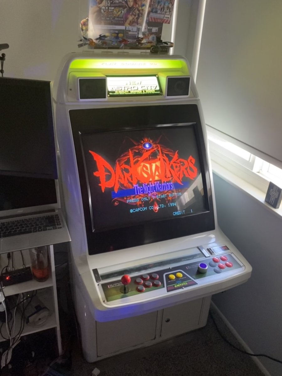

Arkanoid board and spinner on Astro City?
Don’s Arcade
Oct 31, 2016
34
23
Astro City located in a garage in Torrance, CA

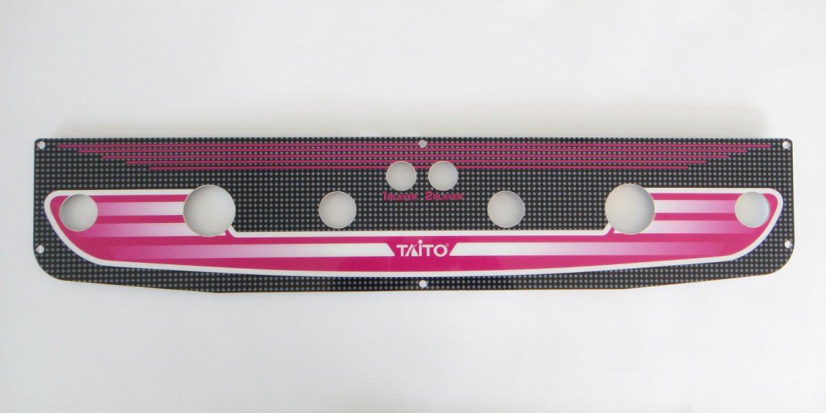

Hello I recently bought an Arkanoid board and I’m wondering what’s the best/cleanest way to put in a spinner on an Astro City. I don’t want it to be janky. I know first of all I have to get a Taito to Jamma adapter.
Someone also pointed out to me that there is a Taito Sega Panel (pictures) for the 1997 game Arkanoid Returns that I could use for an Astro City to put a spinner.

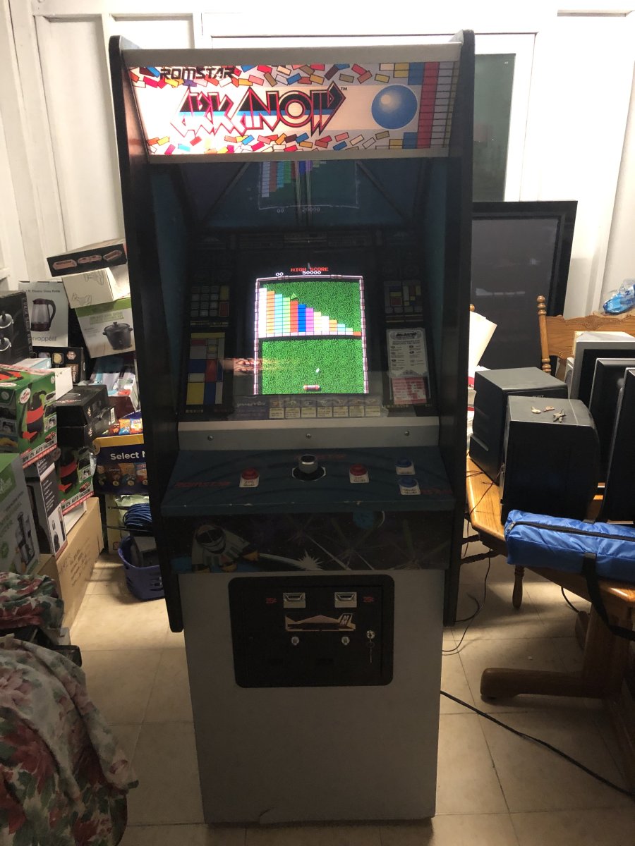

the original arkanoid was never in a candy cab, but a table. so later versions i assume there was some sort of panel as mentioned. good questions though as well. anyone know of a good astro/blast panel original setup or template?

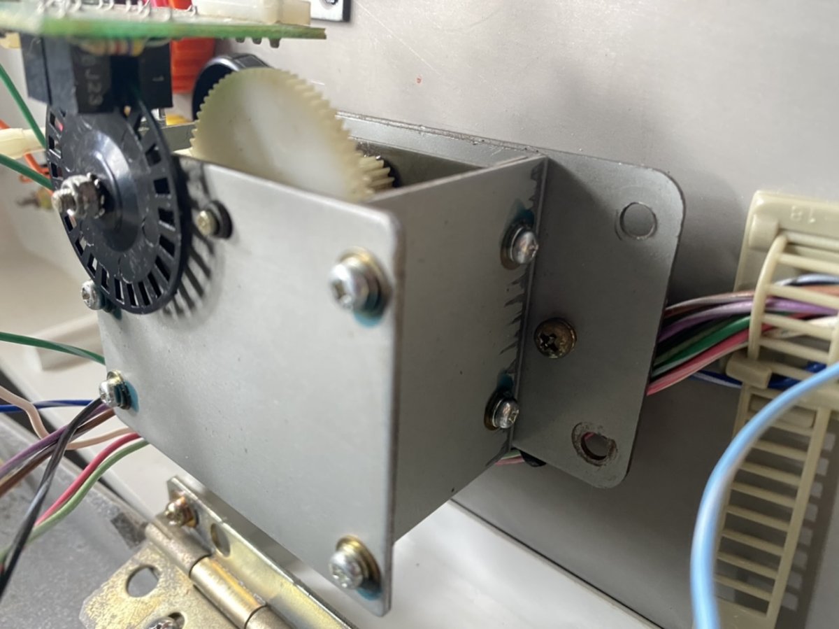

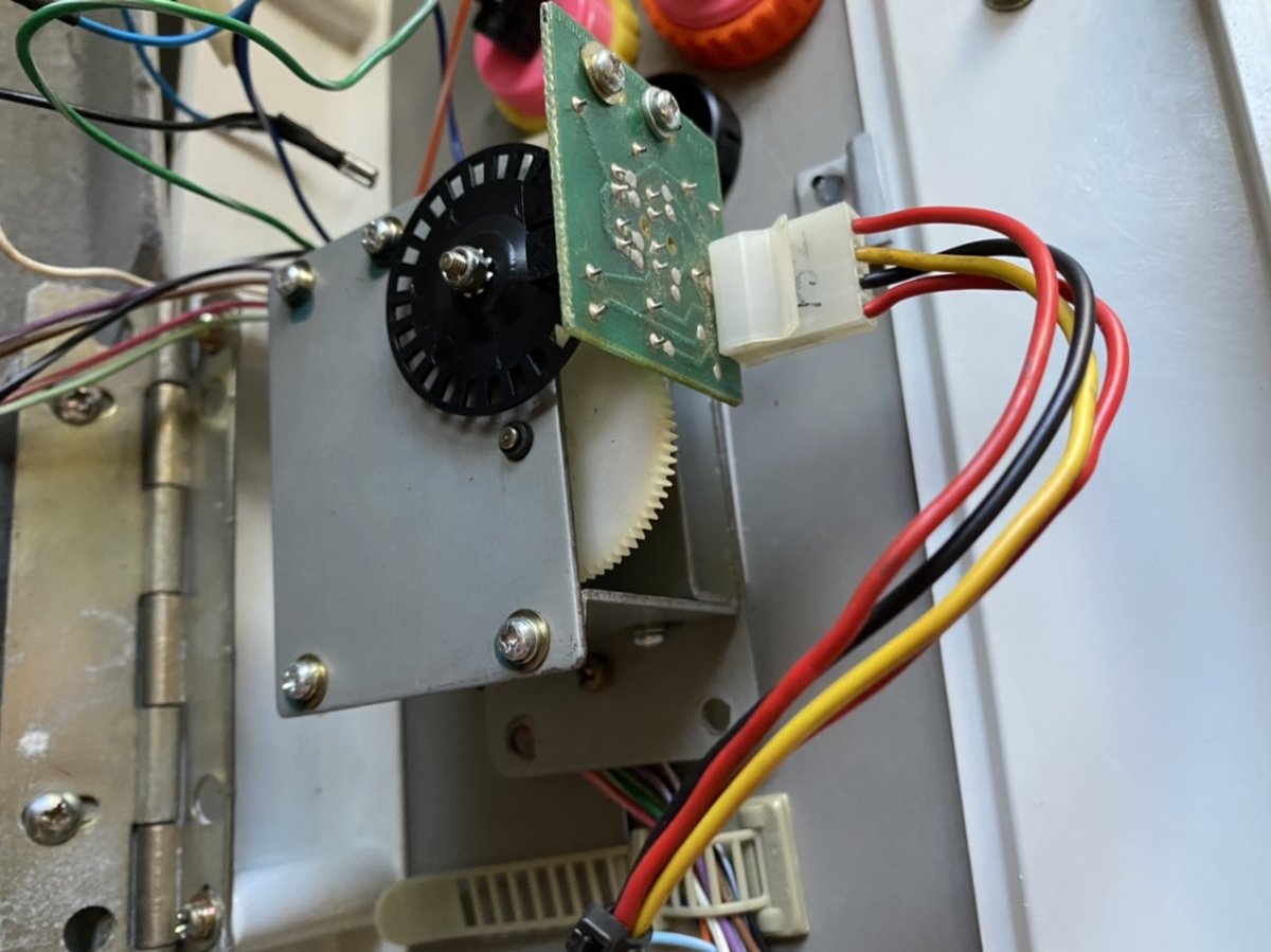

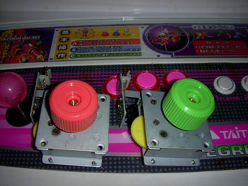

Original Taito spinners can be installed in an Astro City (or New Astro City) cleanly, depending on the CP you have. I installed into my 2P panel a while ago, and replace p2’s joystick (I’m right handed, spinners should go in the right hand).
If you have an original Sanwa CP, you’ll have to drill two mounting holes into the spinner’s mounting plate to get them to attach to the CP. Not a big deal.
Newer repro panels can use the stock holes for mounting.
There is plenty of space beneath the spinner to fit in the panel when closed, and you can either run the connection wires straight to the board, or do it neatly and make a harness that plugs into the control wiring (using those AMP UP connectors).
The spinner sits just about right above the CP.
Personally, I feel nothing beats the original Taito Spinners for Arkanoid-like games, especially if you’ve cleaned and re-greased the gears.

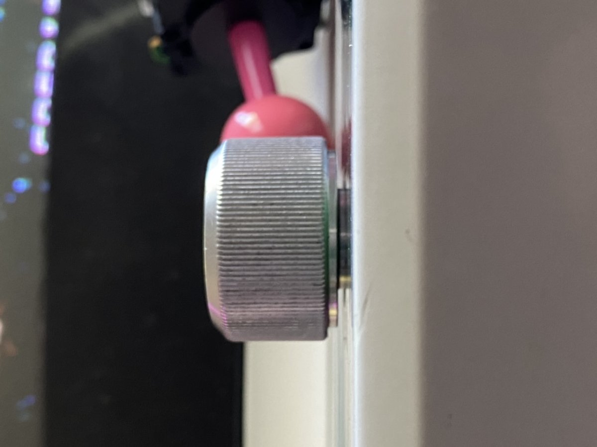

If you want it to look like it matches the Astro, try hunting down a set of Seimitsu LS-29 (they pop up on YAJ regularly) and put them in an Astro 2L6B panel (almost always easily found on YAJ). They're very similar to the Taito ones, but the dial itself is not metal. Build quality is what you'd expect for somenthing meant for arcade use, they are easily serviced and brought back to new-feeling condition.
Not my pics, the bottom one has faded and looks orange but in reality they match Astro pink

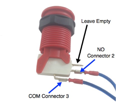

So anybody know why the fire button is stuck on my Arkanoid? Lol
I bought new buttons and checked the wires but no result. It’s like the button is locked and permanently press down. The start button works fine but the fire buttons just don’t work.
Do you have the connectors on the right?
You want Ground (COM) and NO (Normally Open) connected, like so:
