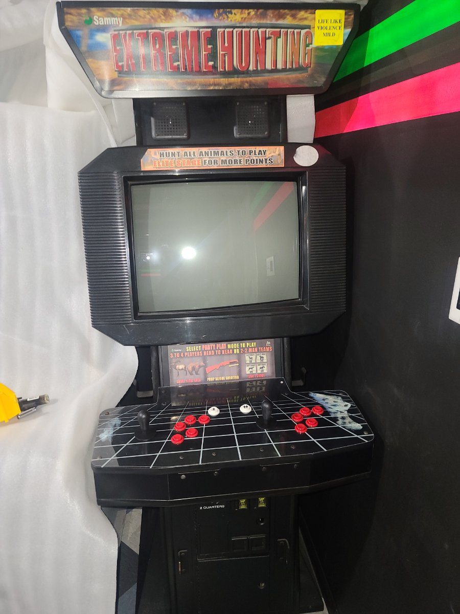

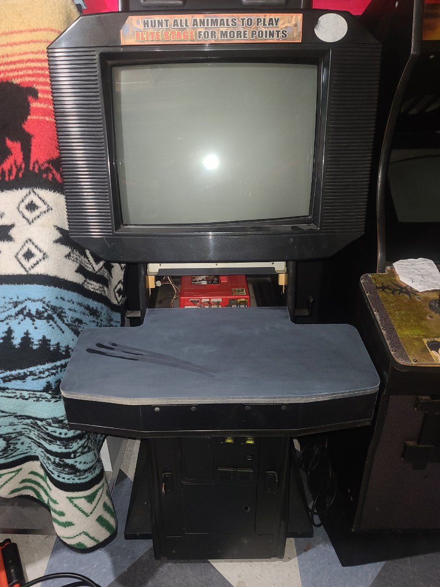

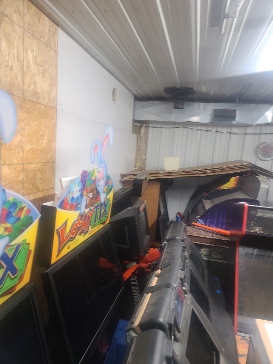

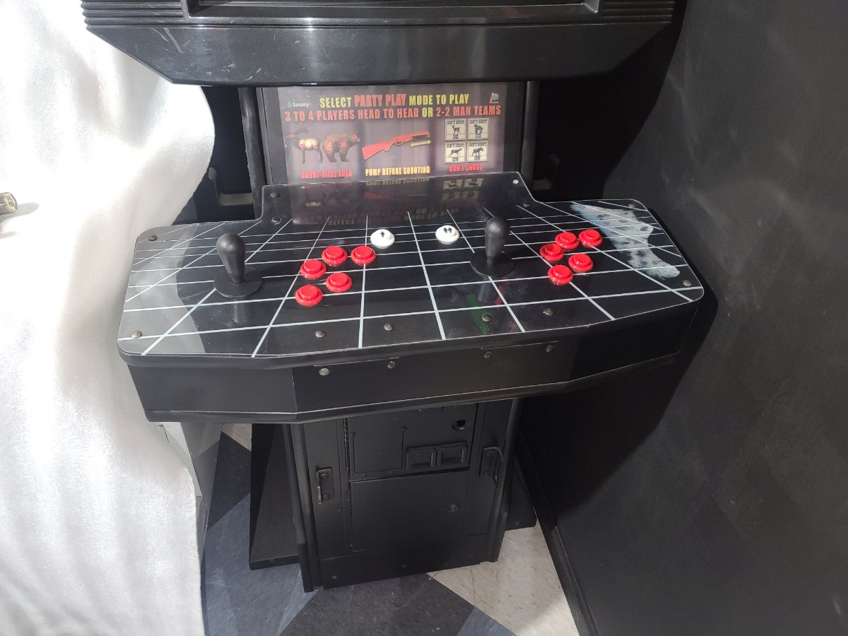

Rummaging around in somebody's storage unit while a friend picked up a cab

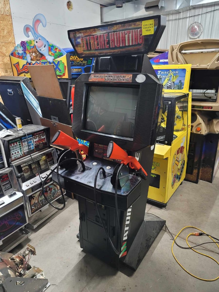

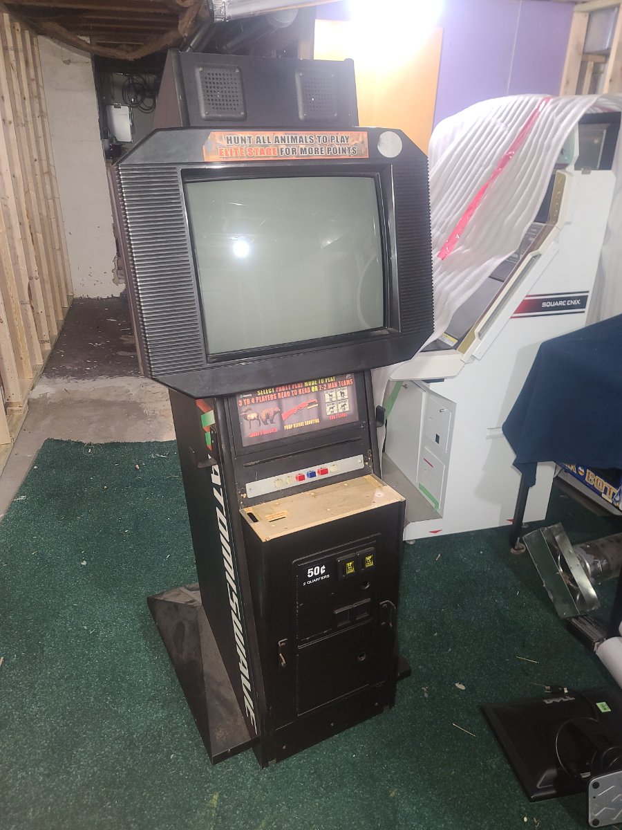

Found an atomiswave, extreme hunting tucked in the back,
Moniter, totally burnt was first to go
Working on converting to a fighting panel
But couldn't find a fighting panel
Work in progress

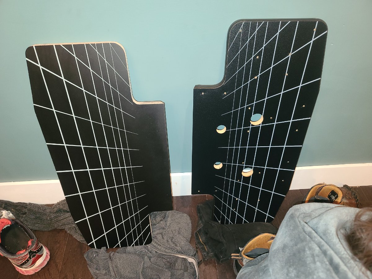

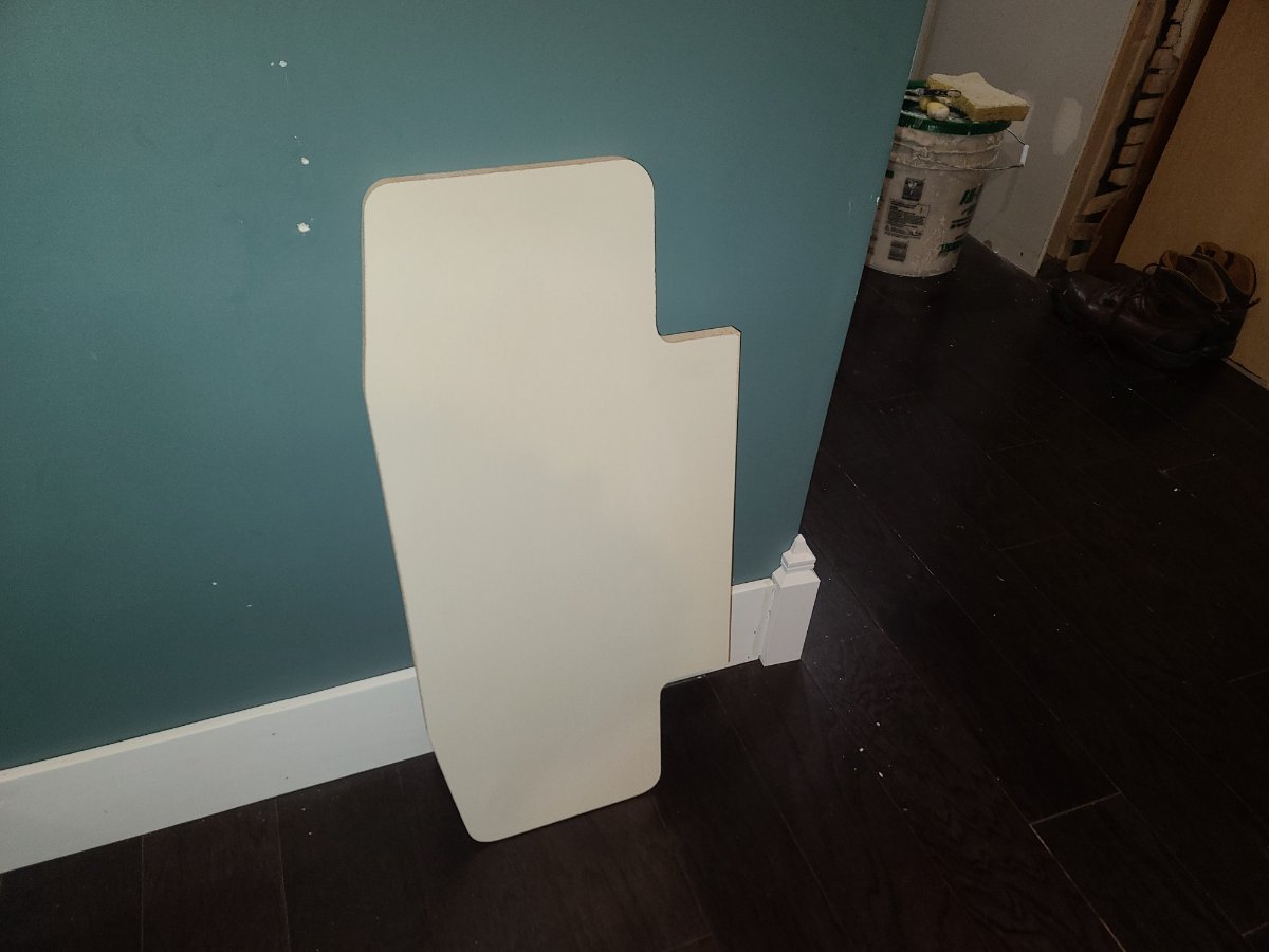

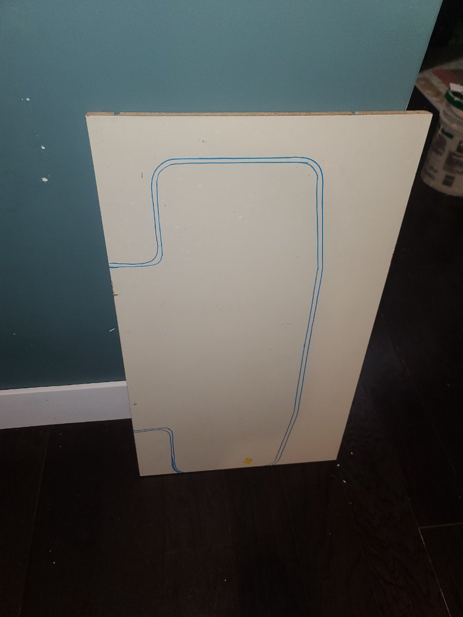

Guess I got to make a control panel

Yes, it seems the joystick panel for this cabinet is quite rare!
The overlay would be in demand i think if you had a good scan done for it.
Hunting is actually really good game when you get into it! At least by making a second panel it's possible to swap back.
Ranger mission also works well with the shotguns , worth grabbing it's quite cheap.
I don't think i've seen that "elite stage" top sticker before either, on mine has a "pump to reload" one taken from one of the older wing shooting games.

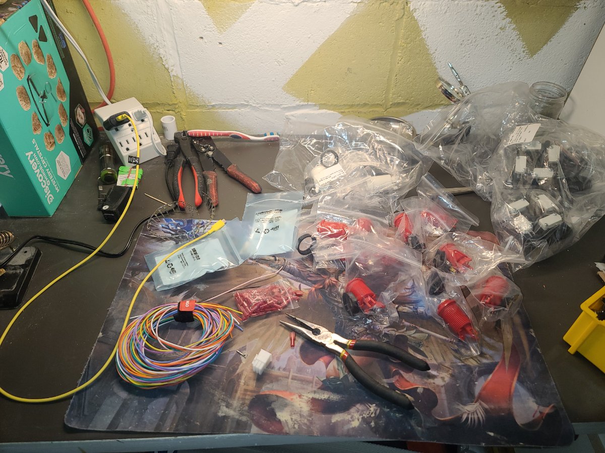

Time to make the donuts

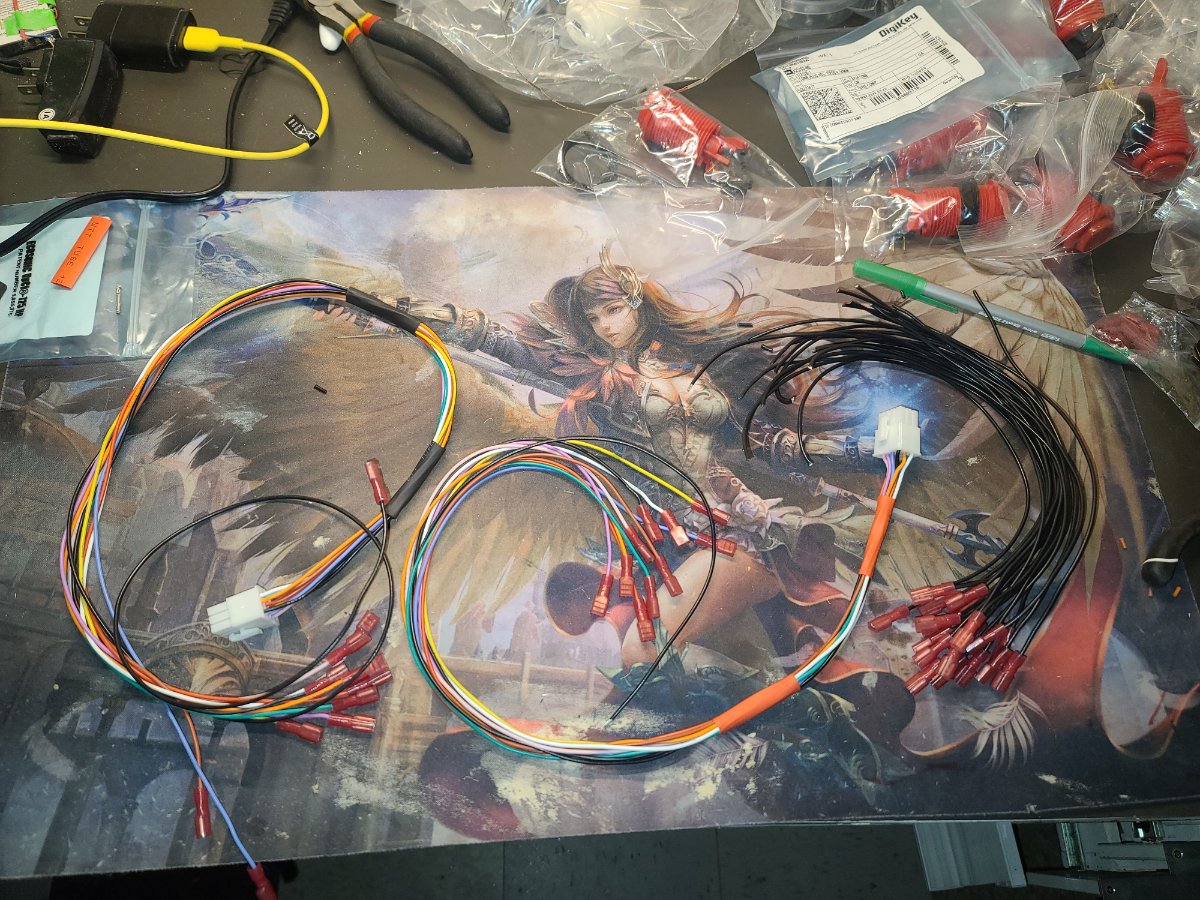

Or I needed some wire harnesses, so made some
Having not done this before, not sure if correct

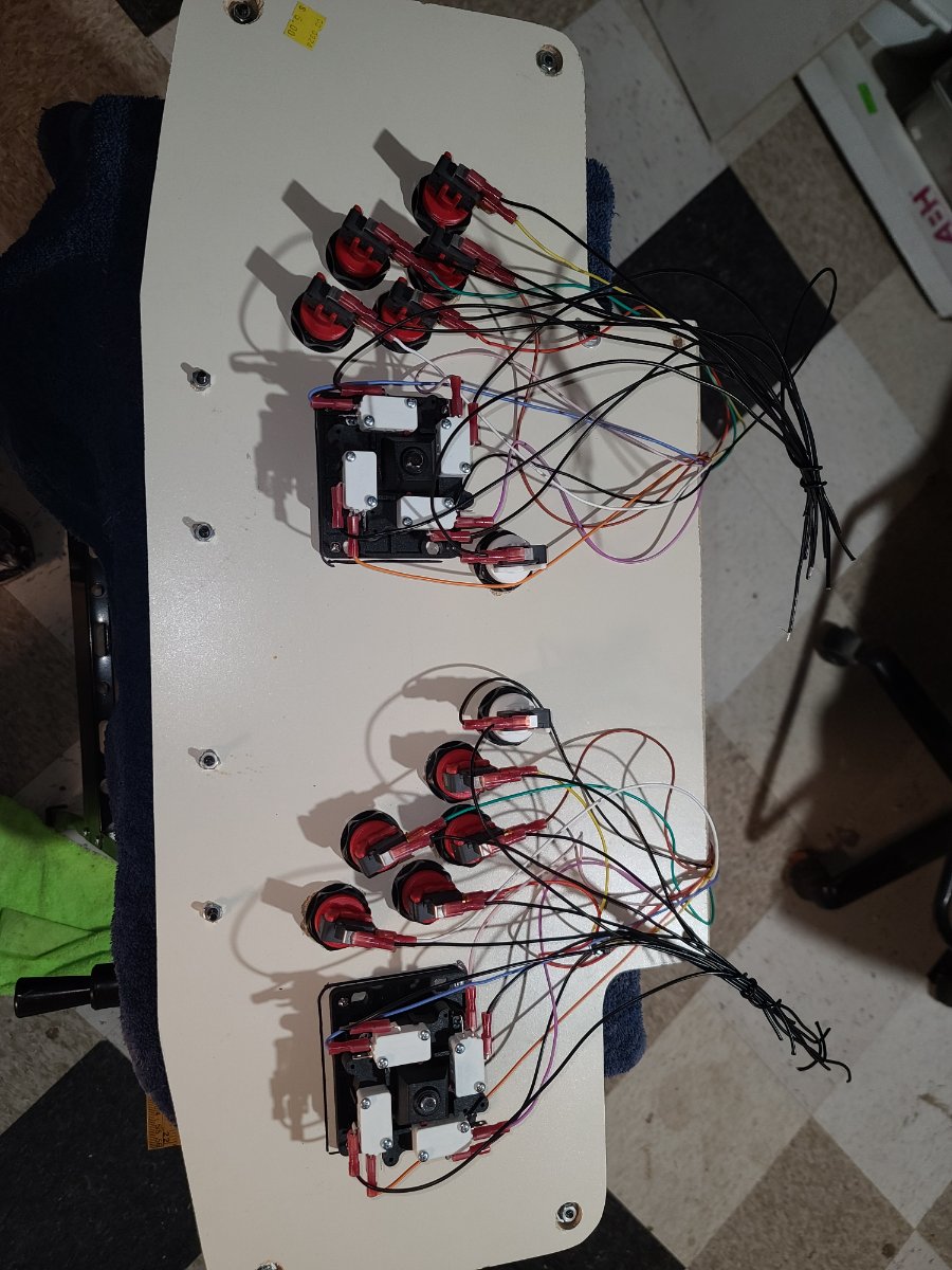

Wire fun times
Not done, side tracked with other projects

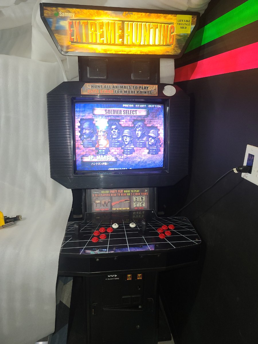

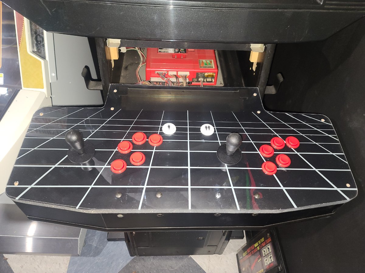

Buttons wired
Added some artificial flavored "fancy" t-molding
And put the whole thing together
Only thing left is to get some art works for the insert and a new marquee ,
Also should power it on at some point
And it lives again
Kept the old hunting stuff around just in case
And need to get a new marquee
But for now it's good
