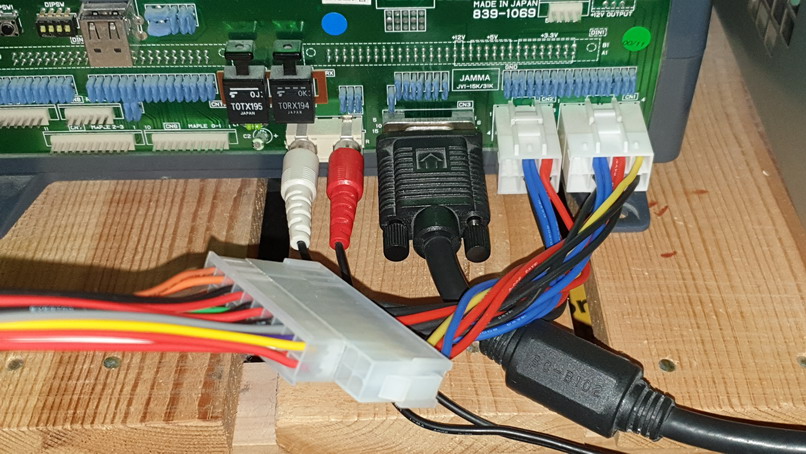

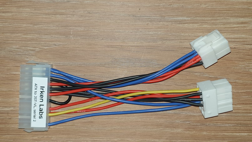

Had a bunch of these made as I had to get a custom cable made for the upcoming Mister JAMMA Expander anyway.
They use soft and flexible 18 AWG silicone wires, with double wires for 3.3V and 5.0V - effectively giving you 2x15AWG (or 1x12 AWG) all the way from the ATX psu to the Naomi = minimal voltage drop.
My adapter arrived today. Very professionally made with 18AWG wires (even 2 for the critical voltages). Tested on my NAOMI2 with DIMM (A very power hungry beast) and it booted right up. Measured all the voltages and they were spot on. With my old adapter I would get 3.2V and 4.8V but here I get 3V3 and 5V solid. The 12V is stable as well :D Highly recommended for all!
Lovely! The silicone insulation wires very nice, expensive also. @invzim does things properly, with quality/form/function and style :thumbsup:
