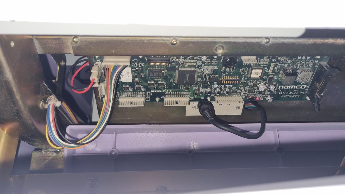

Hi, I'm still fixing up my Cyberlead in NZ. I now need a main controller board if you wanted to sell one? Mine is not working properly. Picture attached for reference

That’s from a cyberlead 2? Do your cabinet have the controller/memory card ports on the panel under the monitor?

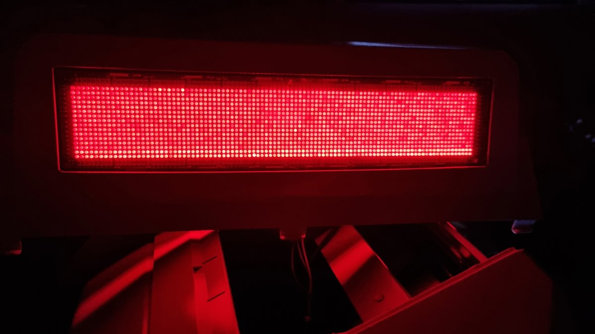

I have a Cyberlead 1. The board I need in the photo is located above control panel under monitor. I've finally got power to the marquee but it just shows all LED lights red. If I press any of the test buttons on that controller board nothing happens. I thought I'd try my luck replacing this part now.

That’s the main JVS IO for the cabinet, and that version you have is from a Cyberlead 2… @xodaraP you’re running the same right? I think he is the only other person with that IO in a Cyberlead 1.
My spare IO is 2 revisions earlier, there will be some functionality differences with mine around DMD colour support and a bunch of mid/late gen system 12 games won’t work via JVS. (There’s some threads on here)
But if it’s a case of no cabinet or a cabinet with a few “drawbacks” then I’m ok to sell the IO as long as you’re aware of the above.
Sounds good I'll take a chance at this point. Send me a PM
