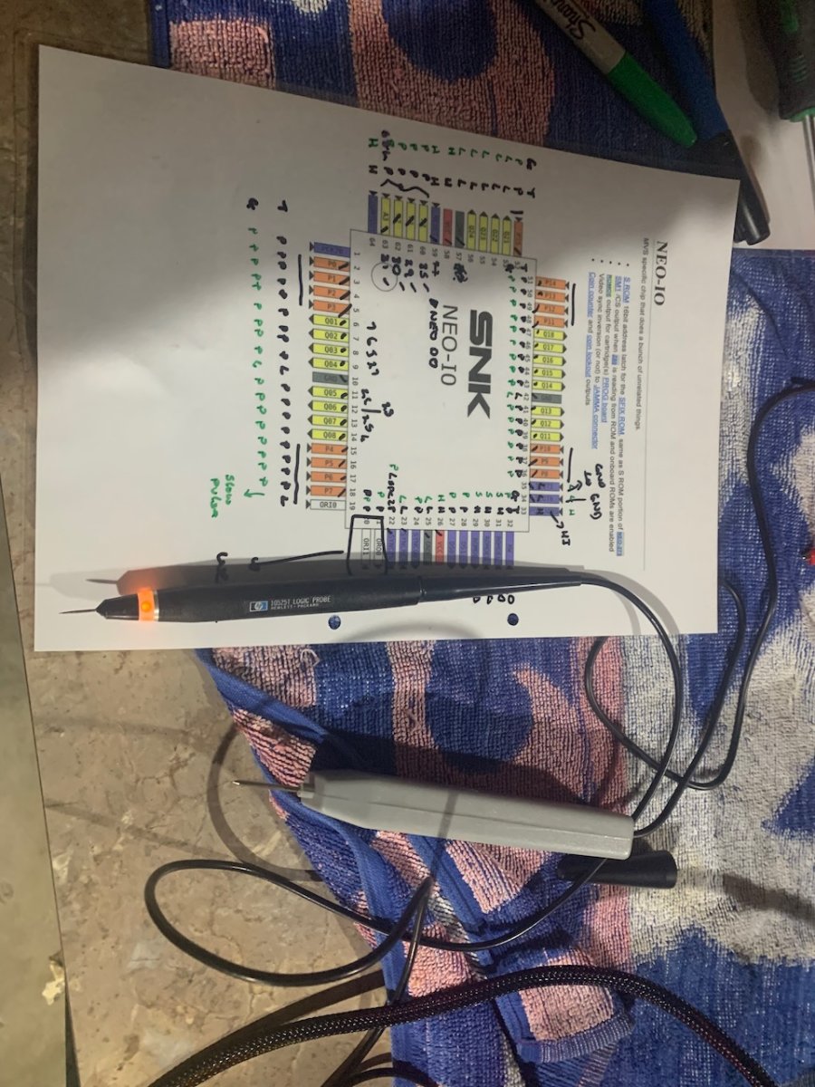

I've used my new HP10525T logic probe to poke all the pins, and I also have a known good MV4FT to compare with.
Weirdness from the logic probe is as follows
PIN 19 ORI0 (OR input #0)
On the known good board this is slow pulse, on the bad board its LOW
PIN 20 ORI1 (OR input #1)
On the known good board this is PULSE, on the bad board its PULSE
PIN 21 ORO0 (OR output)
PIN29 ROMOE
On the known good board this is slow pulse, on the bad board its HIGH
PIN30 ROMOEU
PIN31 ROMOEL
So if I cooked the chip that would explain it. But before I find another donor chip I want to check that it's not just a bad trace.
Unfortunately I'm having trouble reading the pinout for the NEO-IO here
https://wiki.neogeodev.org/index.php?title=NEO-I0
I can't figure out where Pin 19 ORI0 is coming from, so I can't check continuity from the source
I can't figure out where Pin 31 and Pin 30 ROMOEL and ROMOEU are coming from so I can't check continuity from those sources
I can't figure out where Pin 29 ROMOE goes so I can't check it's being sent to so I can't check continuity to that destination.
Any thoughts on how I can find the inputs and outputs for those pins would be hugely appreciated.
