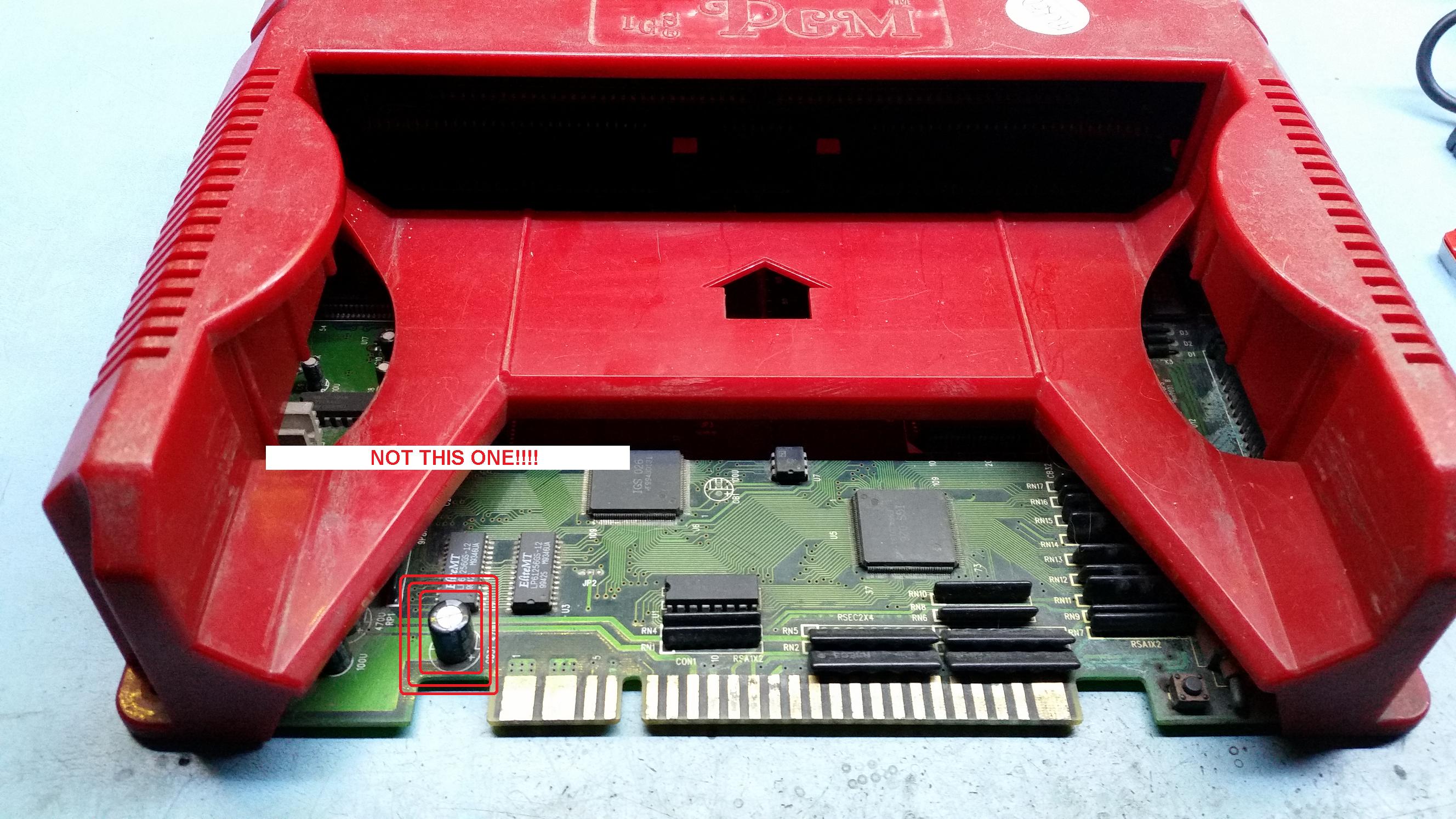

Just to be clear.. This picture is the one NOT TO BUY!!! Notice the cap is moved to the left side....
If the cap has been ripped off... you should still be able to see its position of were it should be.
