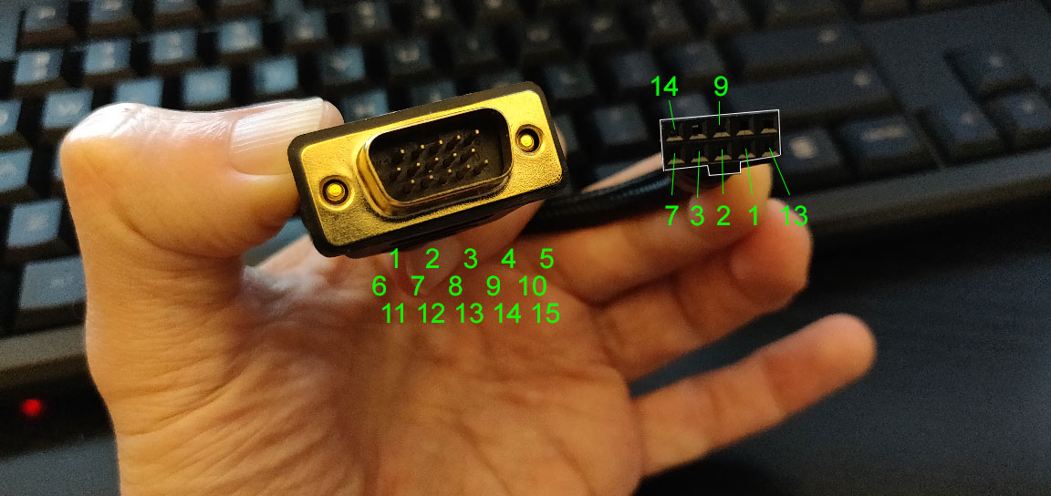

What if I'm willing to tell you? =)
Here's a basic pinout of the VGA cable I got with my Toro years ago. Seems three pins on the Toro side aren't populated.
I don't know if there are any components in the cable itself, but I hope this helps. Outlined the Toro side so can tell tell the orientation.
You’re the best! Happy holidays. That’s all I needed!
