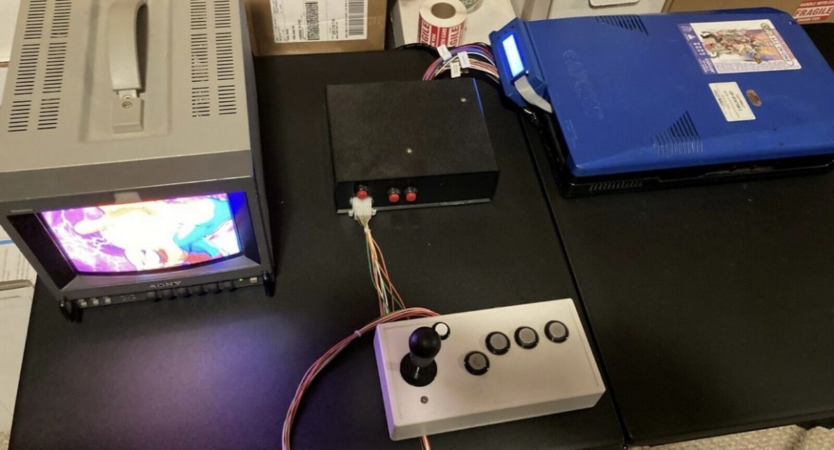

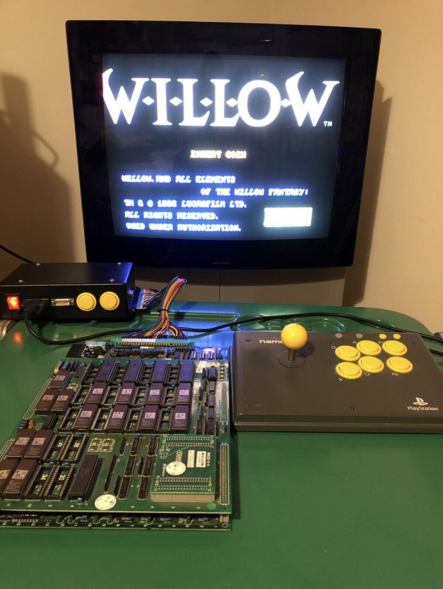

So I’ve been seriously collecting arcade boards for about eight months now and I’ve built up a small collection of rare boards. I think I finally should build a test bench to test and quickly play the boards that I have to make sure they are all working correctly. I’ve been talking with @halowarrior40 and he’s been an extremely great help with telling me what I need and the best parts to buy. I have done some research myself, but I’m finding it a little difficult because it seems like everyone’s bench is a little different. Also, I don’t have any experience when it comes to messing with Power supplies, monitors, or superguns so it’s kinda like reading Portuguese to me. I have purchased Randy Froms arcade and pinball machine books and videos so I should have a lot more knowledge about arcades in a few weeks, but I would like to get a head start and get some more suggestions about what I should buy. I’ve seen some benches where they are very neat, organized and compact. I put some pictures that I found of other benches. The monitor I would like to use is a Sony PVM-8042Q 8. I also know that I will need a switching power supply and a supergun, but there are several different kinds and I just want to make sure I’m buying ones that are good quality. What other necessary parts do I need? Also, for now I only have CPS1 and CPS2 boards.

Thanks! I’ll review this again just to double check that I have everything correct. Now what to I use for a joystick and buttons. I see in some setups people have really nice control sticks. Also what are the black boxes that the cables seem to be going into?

Thanks! I thought something was a little off. Now, I would like to use a supergun like the ones shown in the pictures above. How do I get one? Do I need to build it myself or can I get someone to build one for me? Once I figure out how to get one I’ll go from there and figure out what else I need. I really appreciate all the help from everyone!
