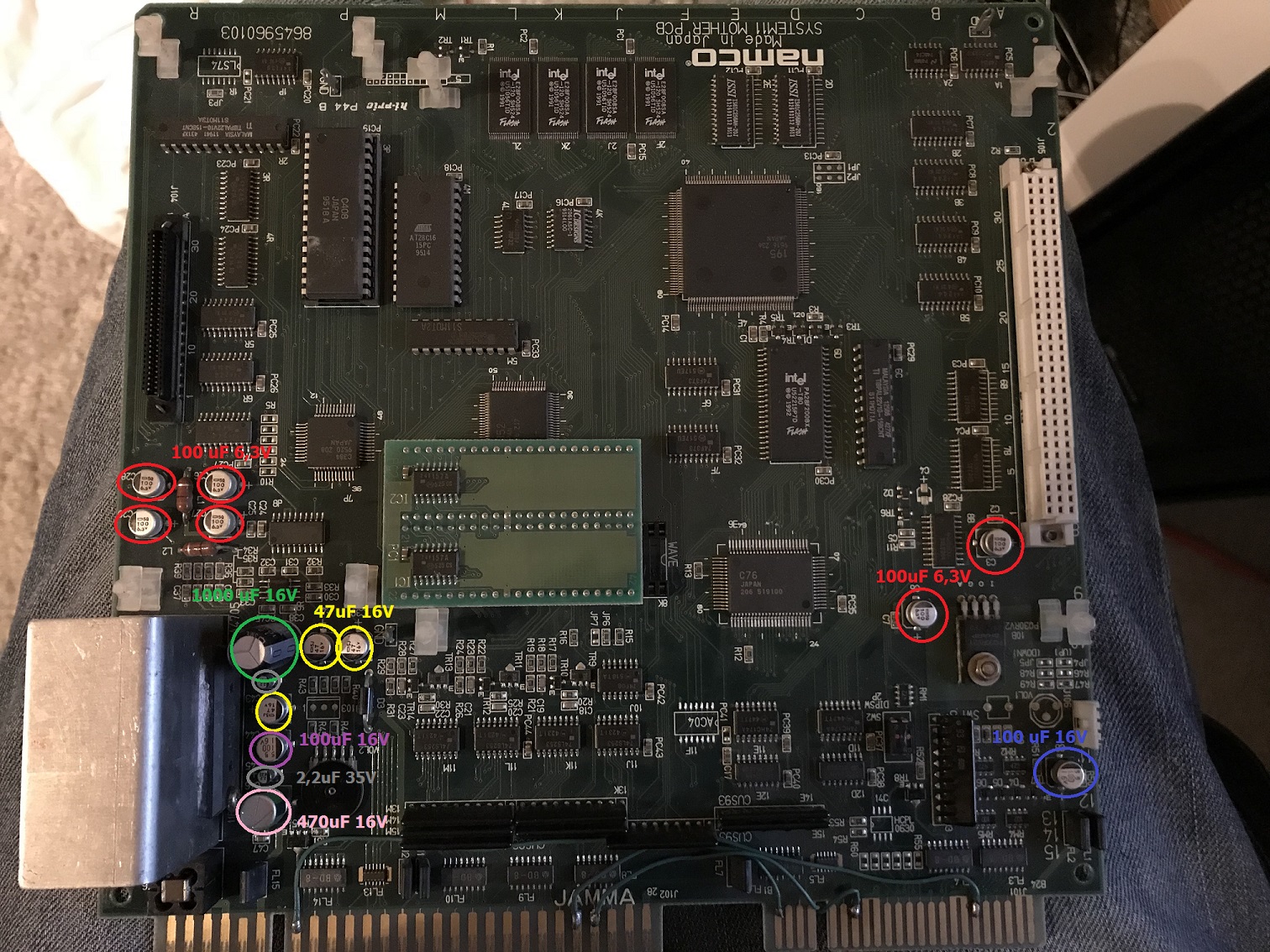

After @SmokeMonster's awesome work and recap log, I decided to check my own Namco System 11 and System 12 board and found some missing caps as well (although my boards all work fine?)
This made me create some capacitor overview maps and I plan to go over my other board and make similar overviews which I will post here. :D
Namco System 11 (verified on Tekken 2)
There are some minor variations on Xevious 3D board.
C42 and C45 = 2.2uF 50V
C46 = 470uF 10V
Top board
5x 10uF 16V
1x 47uF 16V
6x 100uF 6V
Bottom board
2x 2,2uF 35V
3x 47uF 16V
6x 100uF 6,3V
2x 100uF 16V
1x 470uF 16V
1x 1000uF 16V

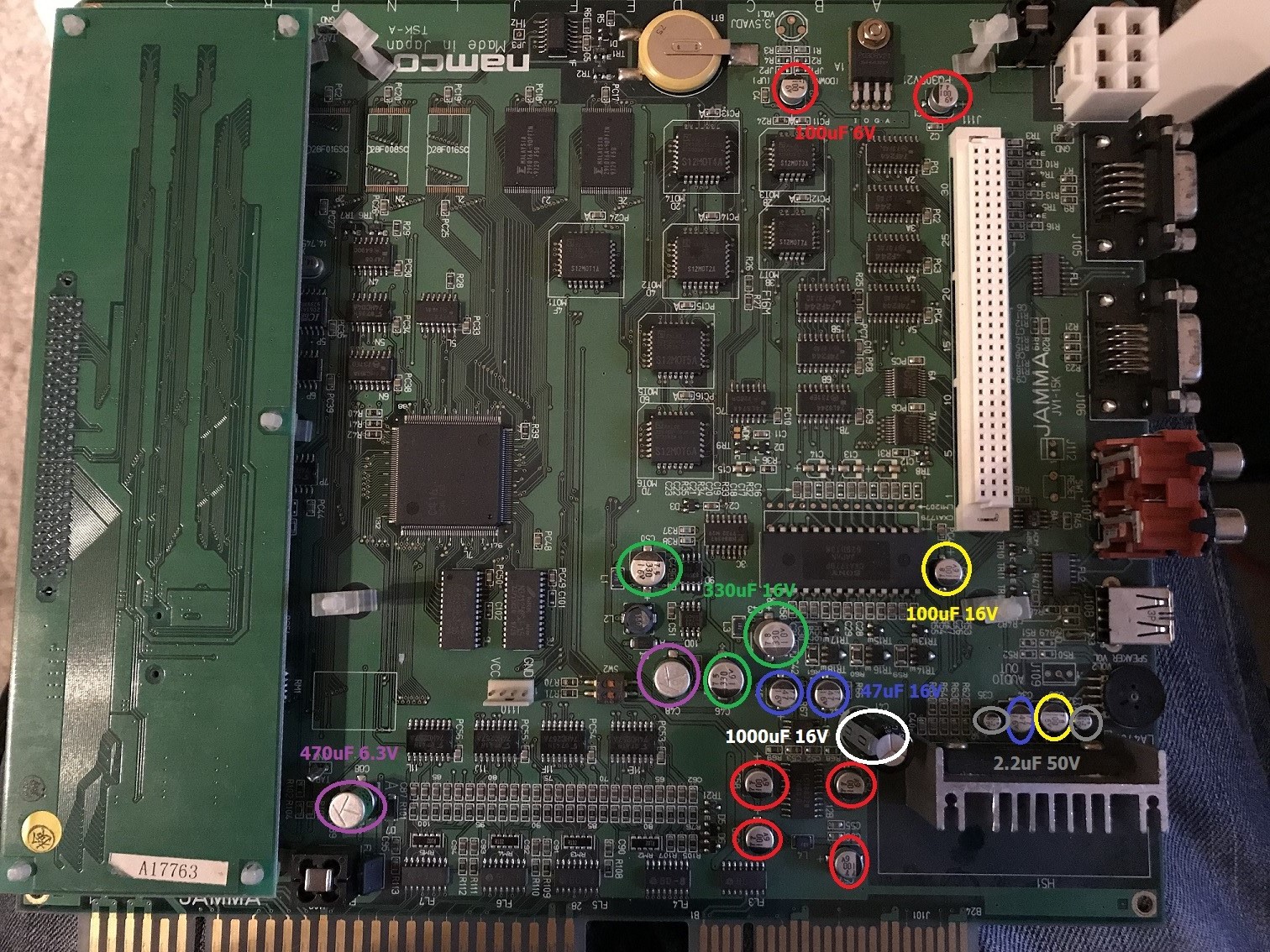

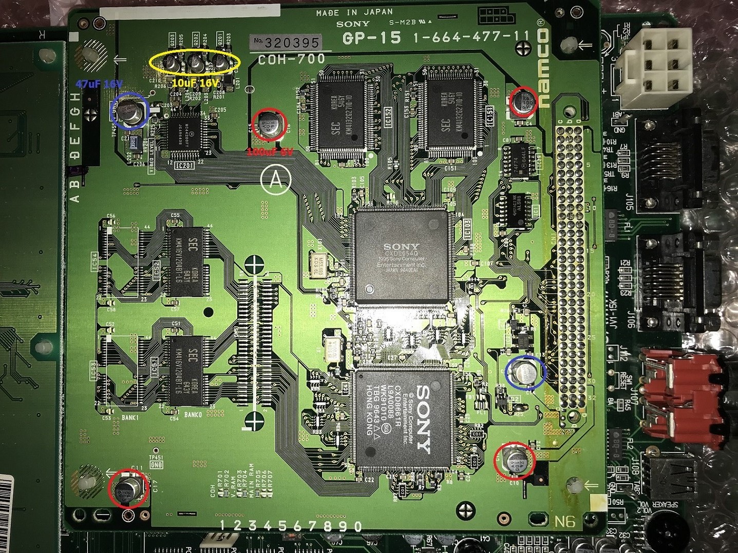

Namco System 12 (verified on Tekken 3, Tekken Tag, Ehrgeiz and Soul Calibur)
Top board
3x 10uF 16V
2x 47uF 16V
4x 100uF 6V
Bottom board
2x 2,2uF 50V
3x 47uF 16V
6x 100uF 6V
2x 100uF 16V
3x 330uF 16V
2x 470uF 6,3V
1x 1000uF 16V
I have a Aqua Rush and went to verify it on that one and realize half the caps have been ripped off the sub board. the ones that were there were the same and it looked like the rest of the board was laid out identical to Tekken 3 and Ehrgeitz

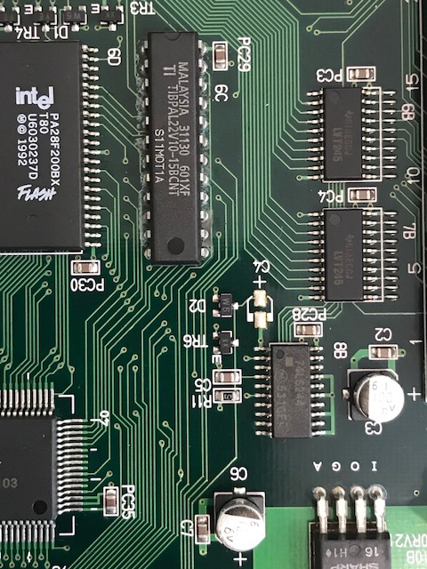

My boards are in the US so I can't check it personally, but I believe that spot is unpopulated just based on how clean the points are. There are a few on Tekken 3 in that region that are unpopulated at least.
I can confirm C4 is unpopulated on my Xevious 3D board.
