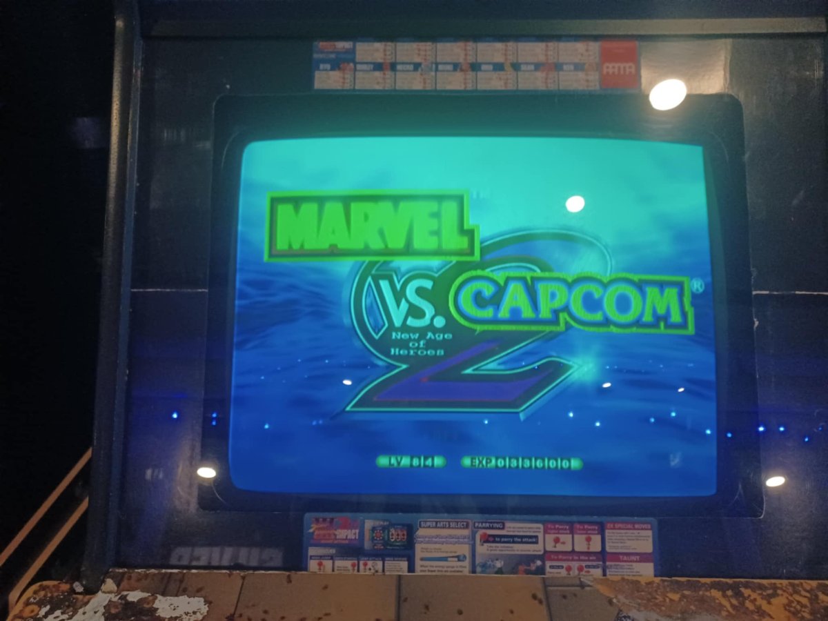

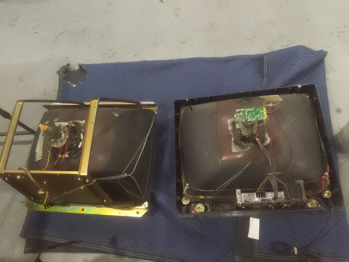

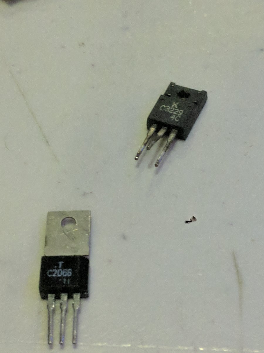

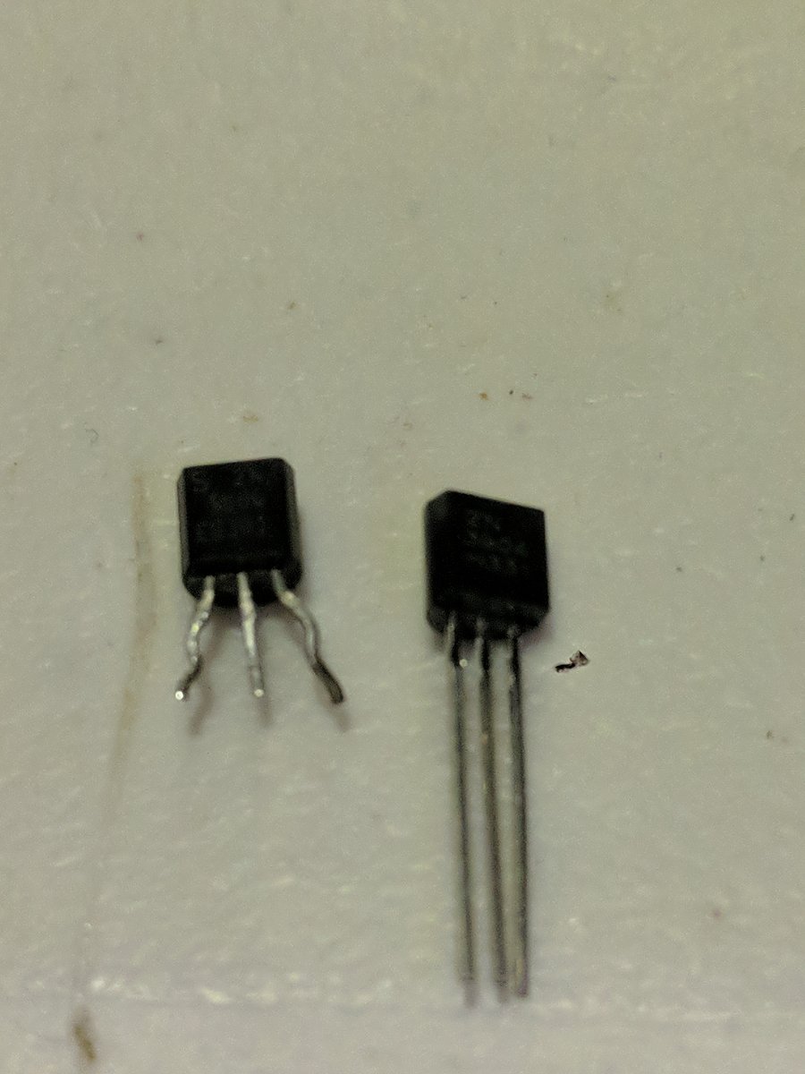

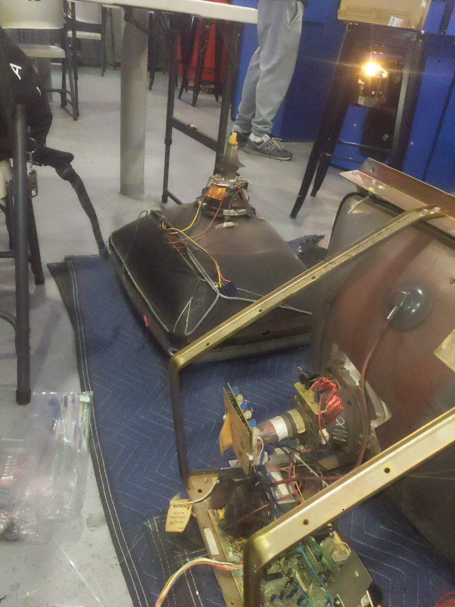

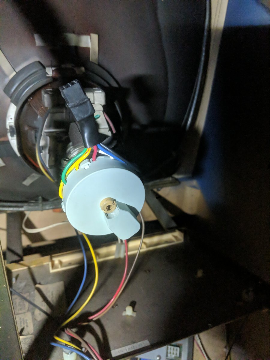

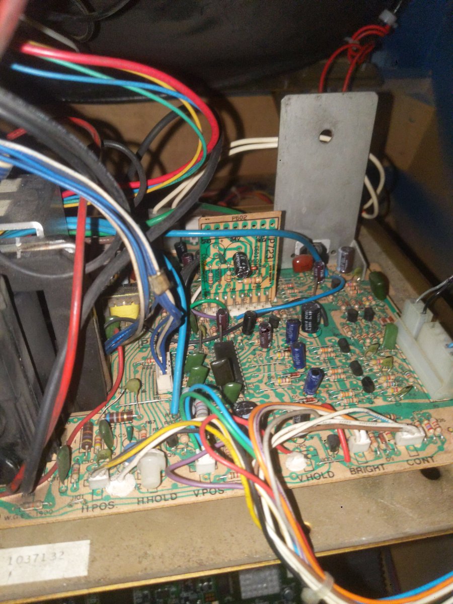

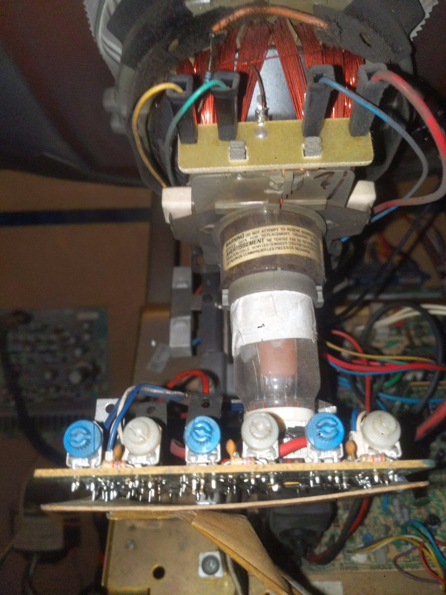

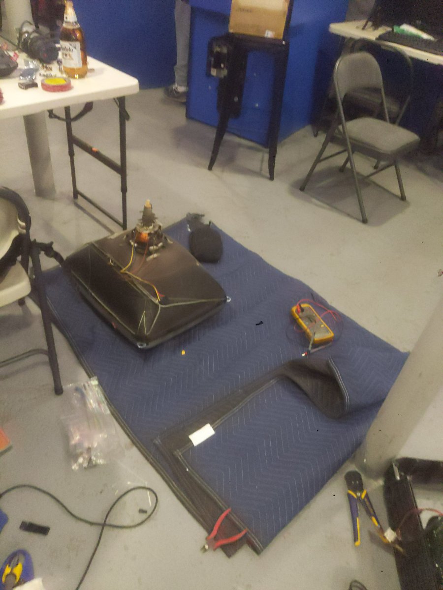

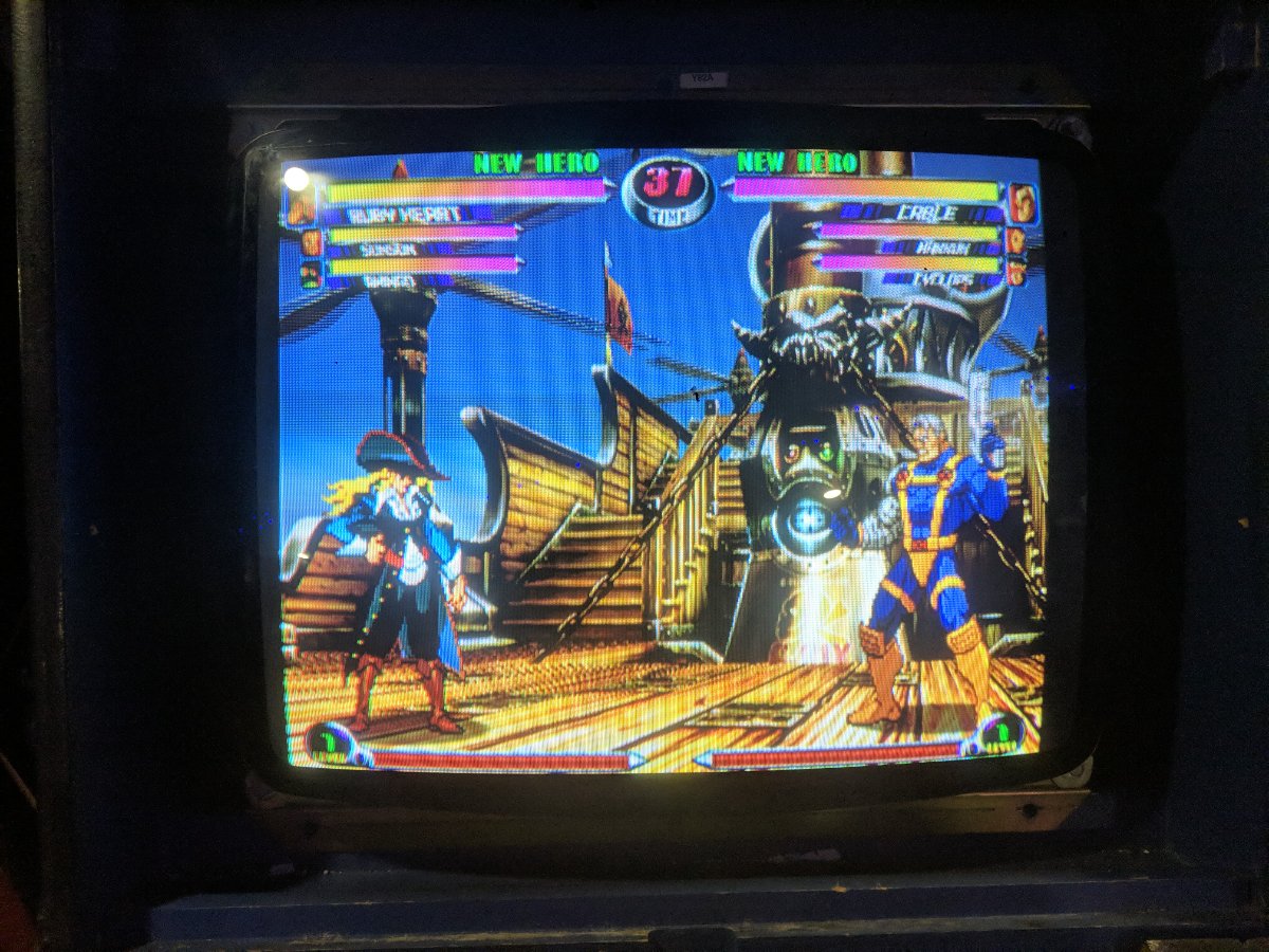

Big Blue at my local arcade lost the color red after going over the chassis and changing both red transistors the problem persisted. I checked the tube and it had a bad red gun that not even rejuvenation brought back. Had a sansui consumer set laying around with an Orion tube that was in good health swapped it out last night.

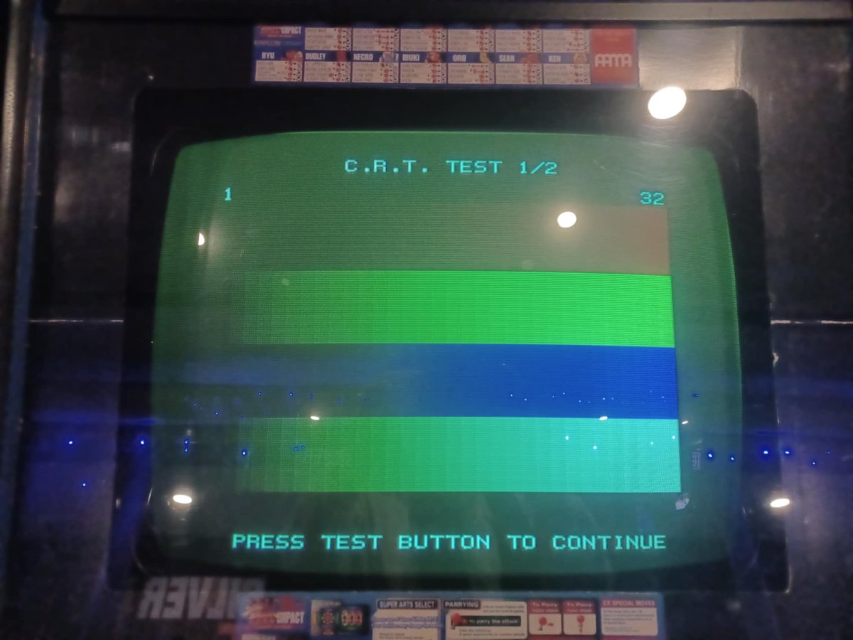

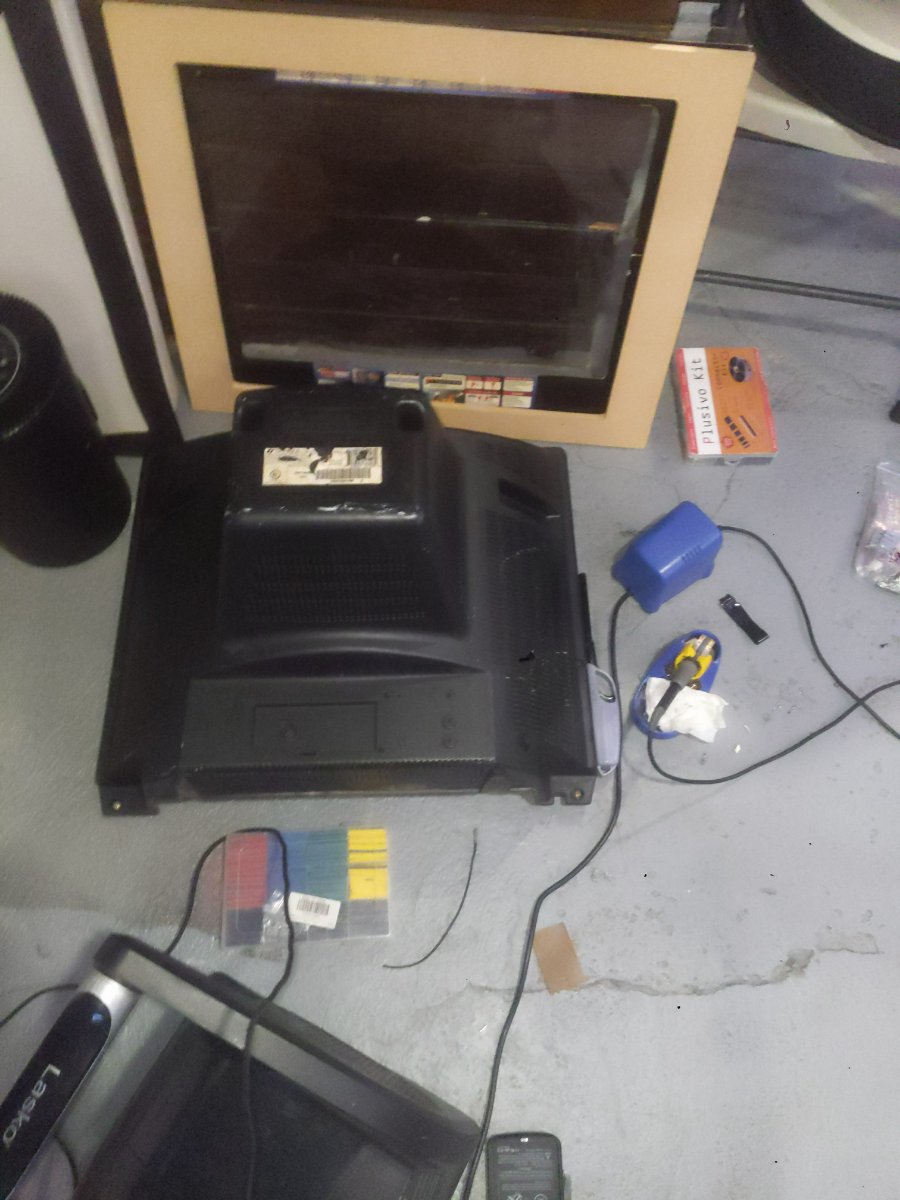

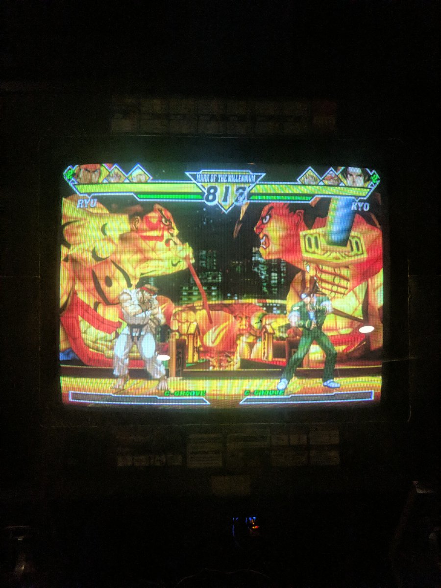

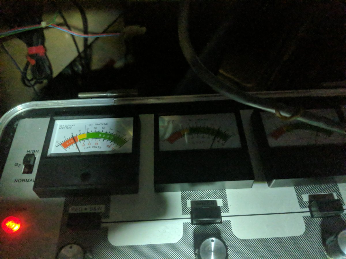

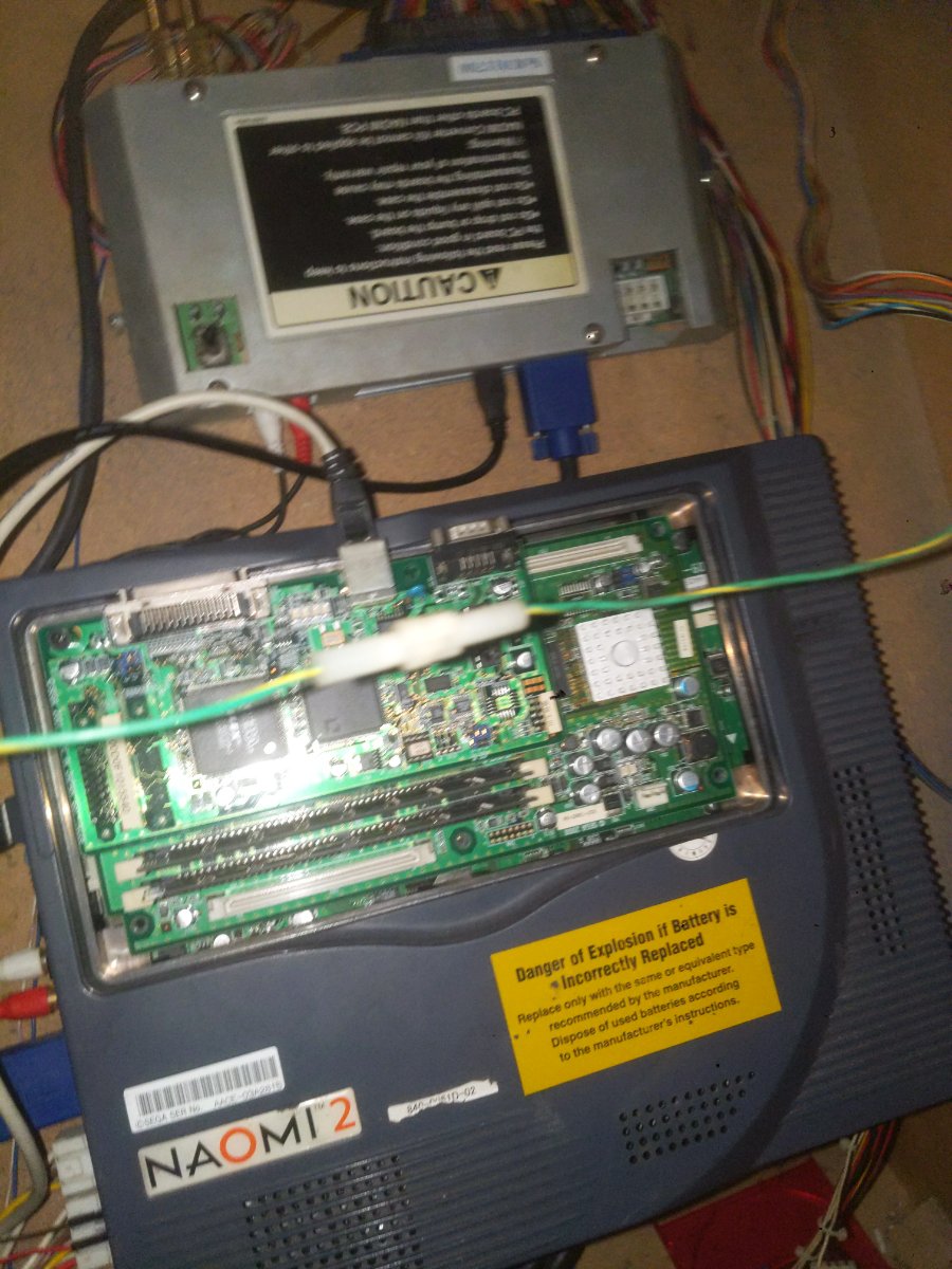

Few more pictures of the transplant and calibration.
