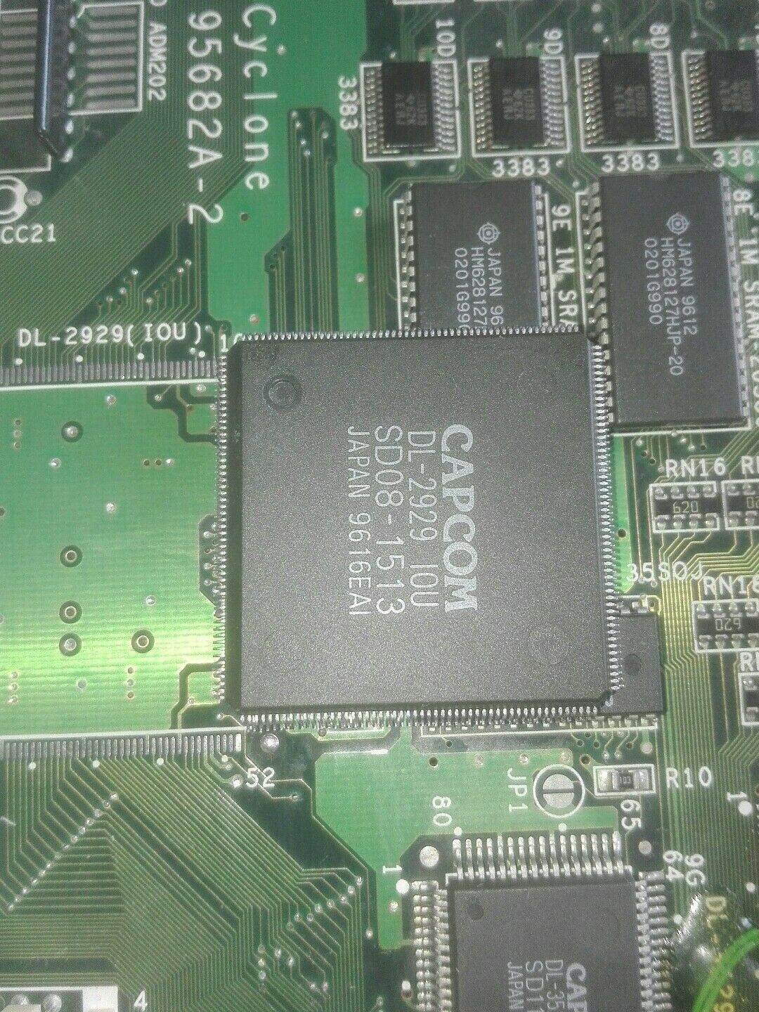

capcom cps3 kick harness not working-fixed
Mukuro_W
Nov 15, 2018
266
211
ITALY
on my JOJO no cd setup the fourth buttons not was working, after a better look discovered that the big custom chip DL-2929 IOU SD08-1513 not make good contact at some feet...detached and resoldered it in place and the kick haness turned 100% working.
