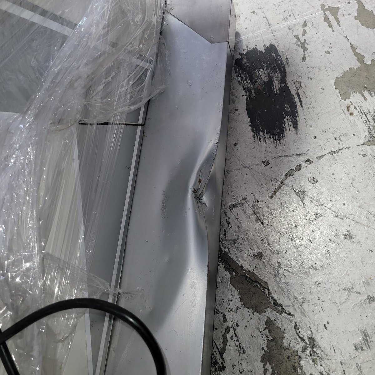

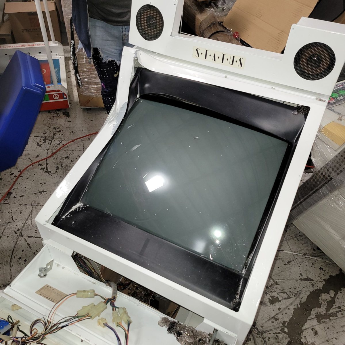

Hello I recently acquired a mint Capcom status 25 last summer. Will it got damaged in shipping to me.
Glass completely shattered. So I am asking if someone can take measurements for me of glass holes in glass and the graphic on the glass. I will try to duplicate it before rest of the cab is fixed.
Shity thing is the cab was mint.

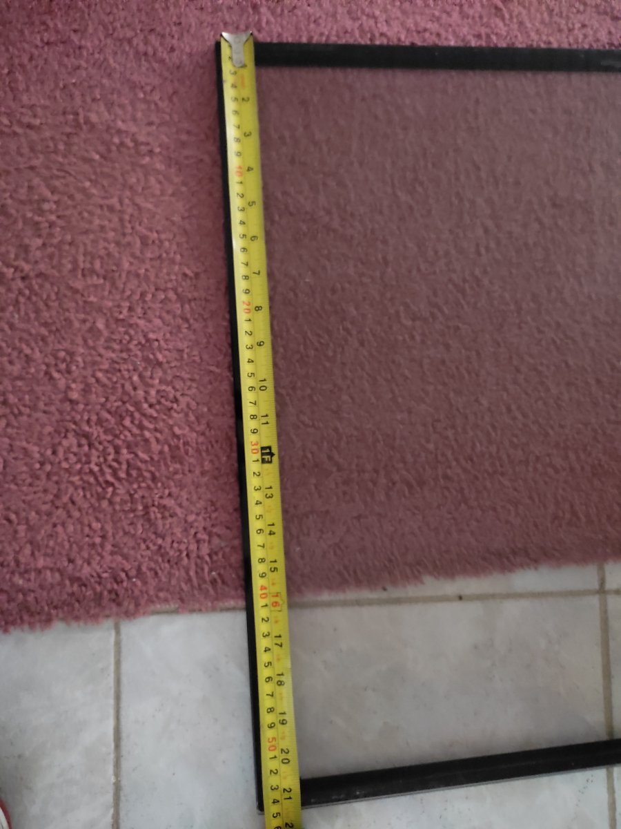

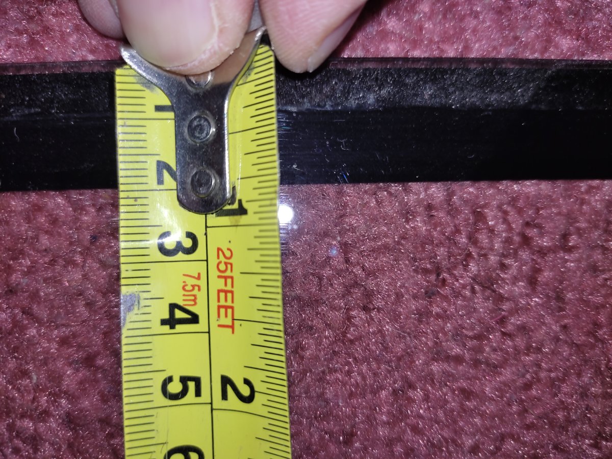

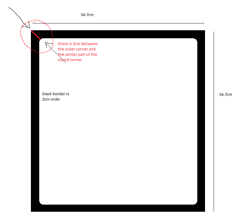

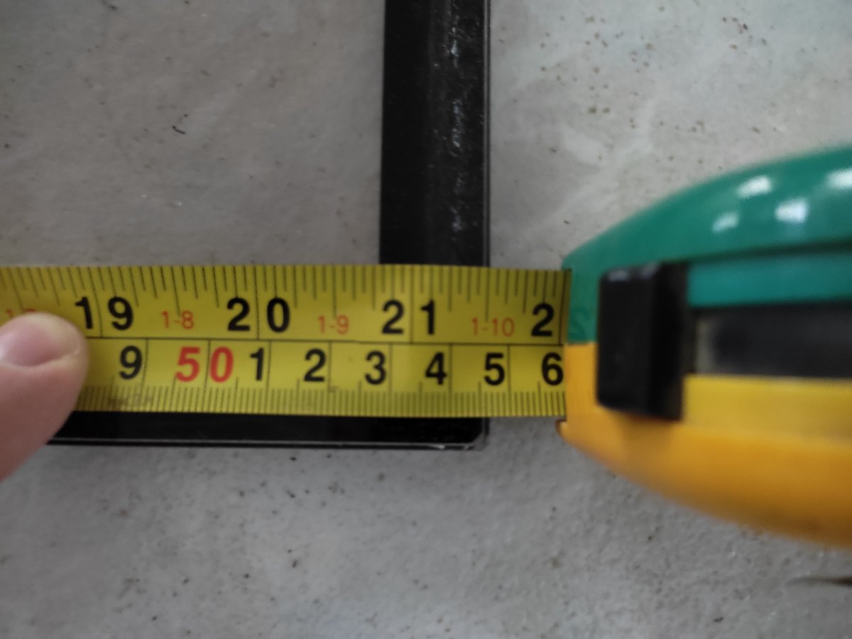

here's pictures
