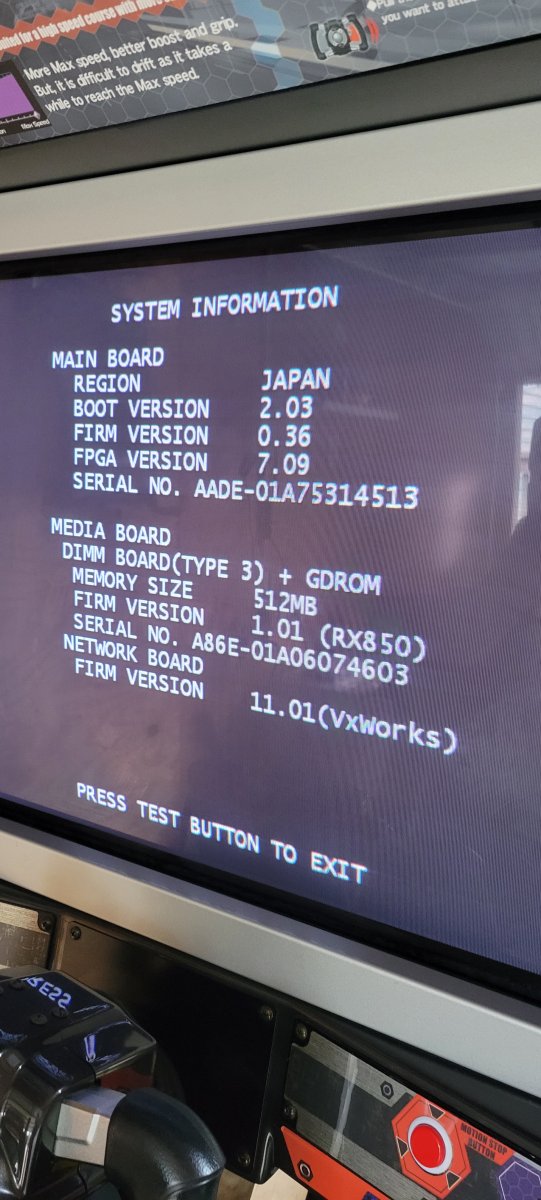

Just got myself a Triforce in the form of a F-zero AX cab, and it's currently set to Japanese region. I've tried going to the system info tab in test mode and doing the 30x service button press to change region, but no dice. After 15 presses, I'll get a GAME ID line will come up, and nothing with additional presses.

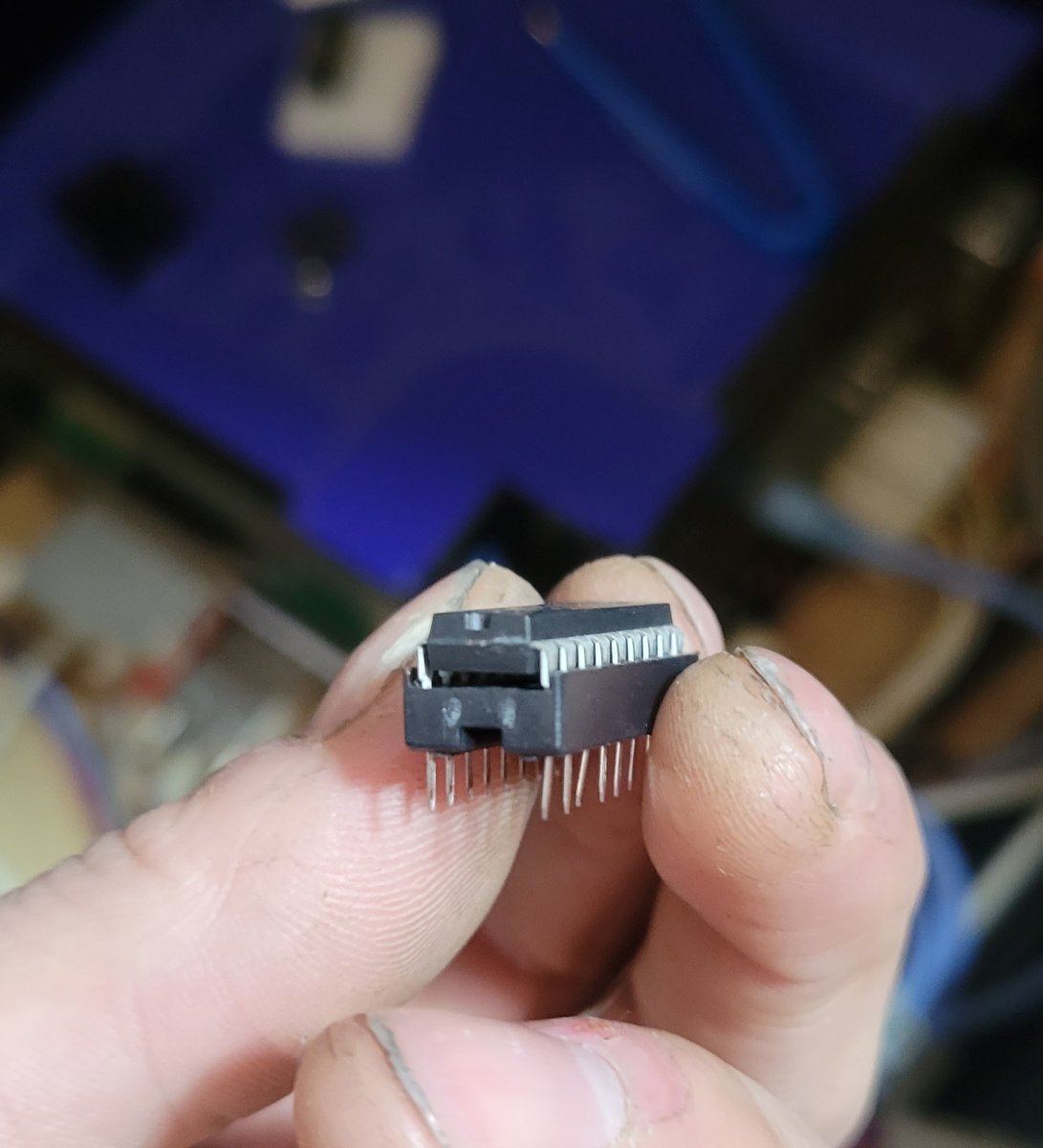

Worse yet, I broke a few legs on the OG key when I pulled it out

So an IC socket repair was successful, game is back up running in its original state.

Hi Guys! This is my first post here, but I've been intensively reading everything I can as I just picked up 3 F-Zero AX deluxe cabs and am cleaning/fixing all of them.
I experienced the identical situation as the OP, and my firmware versions were identical.
All three systems (one Japan region, two US region) were:
Main Board:
Boot: 2.03
Firmware: 0.36
FPGA: 7.09
Media Board:
Firm: 1.01 (RX850)
Network Board:
Firm: 11.01 (VxWorks)
I also was only able to get the game ID to appear after 15 presses, but nothing more.
Since I wanted to update to the modified CF boot code, I went through the process of updating per these instructions:
https://www.arcade-projects.com/thr...rze-juillet-french-national-day-release.1526/
After updating to that version of firmware, I am now able to do the 30-button press region change.
I don't see any downside of updating to that firmware version. I confirmed that loading from the original GD-ROM with the original security key works, plus now I can boot to the attached CF card as well.
Hope this helps.
-Frank
