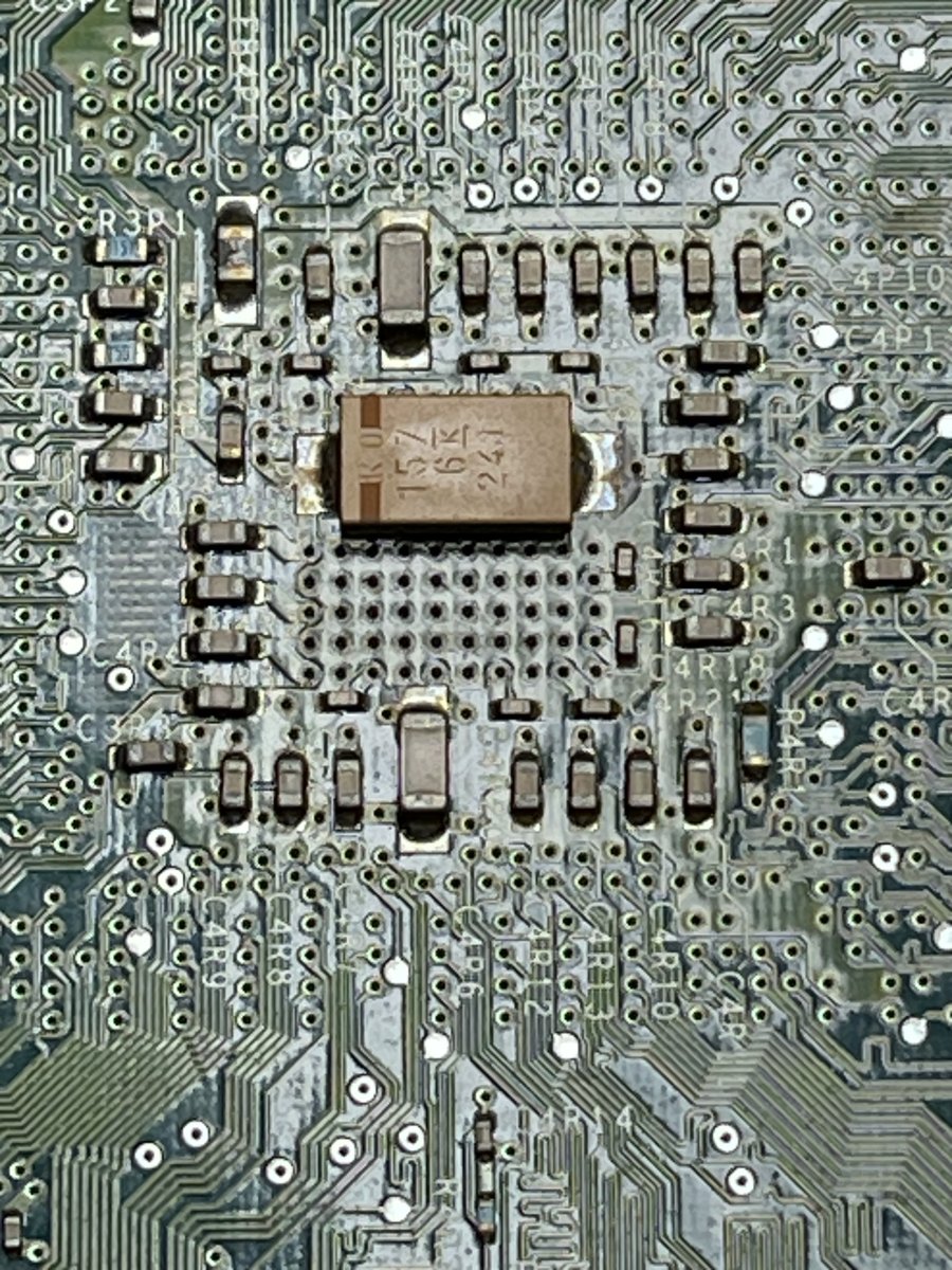

1- One of the chihiro in my wangans decided to die: black screen, no sound, green led.
I had already changed the classic caps next to the CPU in this one and both fans are still working fine.
I tried to change other caps but no success so far. Should I even bother to do them all? Is there hope or should I just give up?
2- If this working one died with working fans. should I do preventive maintenance on the other ones?! like what? remove and apply thermal paste to both CPU and GPU? anything else?
Thanks :(

So the gpu heatshrink is glued … which doesnt seem optimal.
