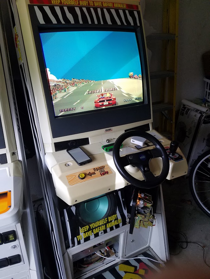

chihiro outrun
It works for me, but I am unsure if all controls are right.
I might need some help to implement a form of force feedback in it.
The original cabinets had a spring that pulled the steering wheel back to the middle.
They had a motor that made the wheel vibrate if you went off road or crashed.
It's an export version so you might need to change your region.
It's based upon cannonball in case you might wonder.
Confirmed this is working. Thanks for sharing.
The game play feels a little....clunky? But then again, I've been playing the shit out of or2sp the last ~9months and haven't played or1 in years. Not sure if it is game itself, inputs, i/o, or conversion, etc.
Guess I gotta score a or1 cab now to compare ;)
Thanks again man!

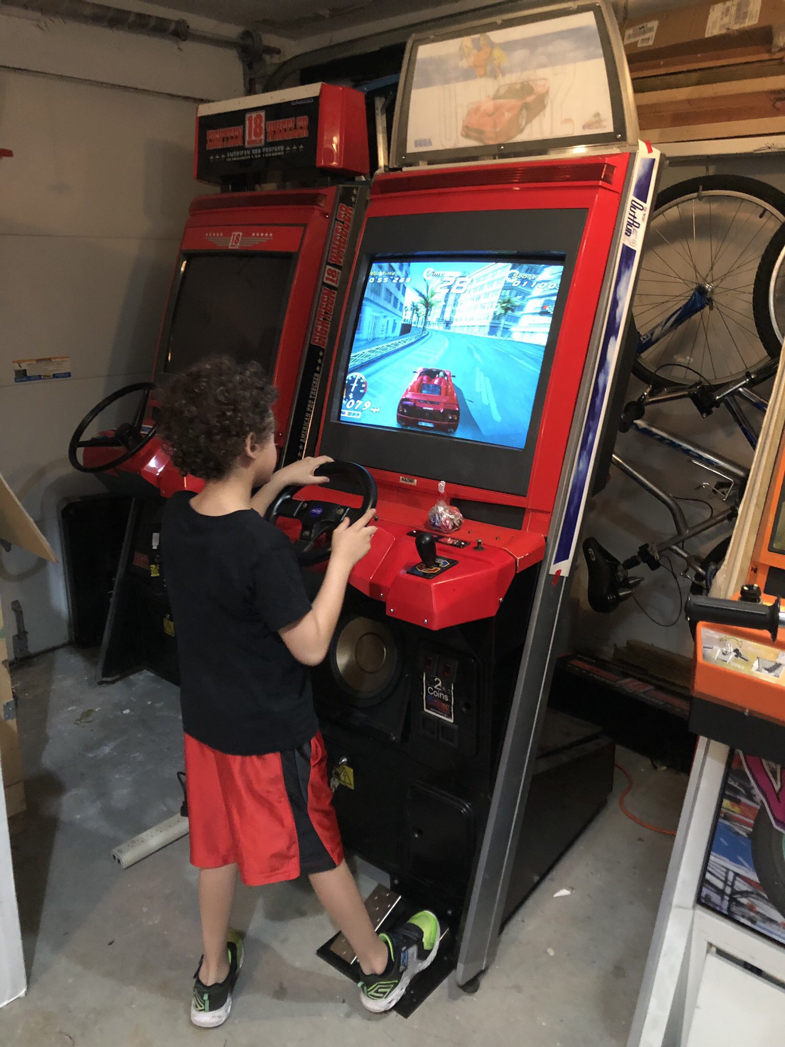

Is this a good place to mention I’m almost done with the 18 wheeler to Outrun conversion ? ;)
