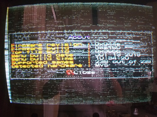

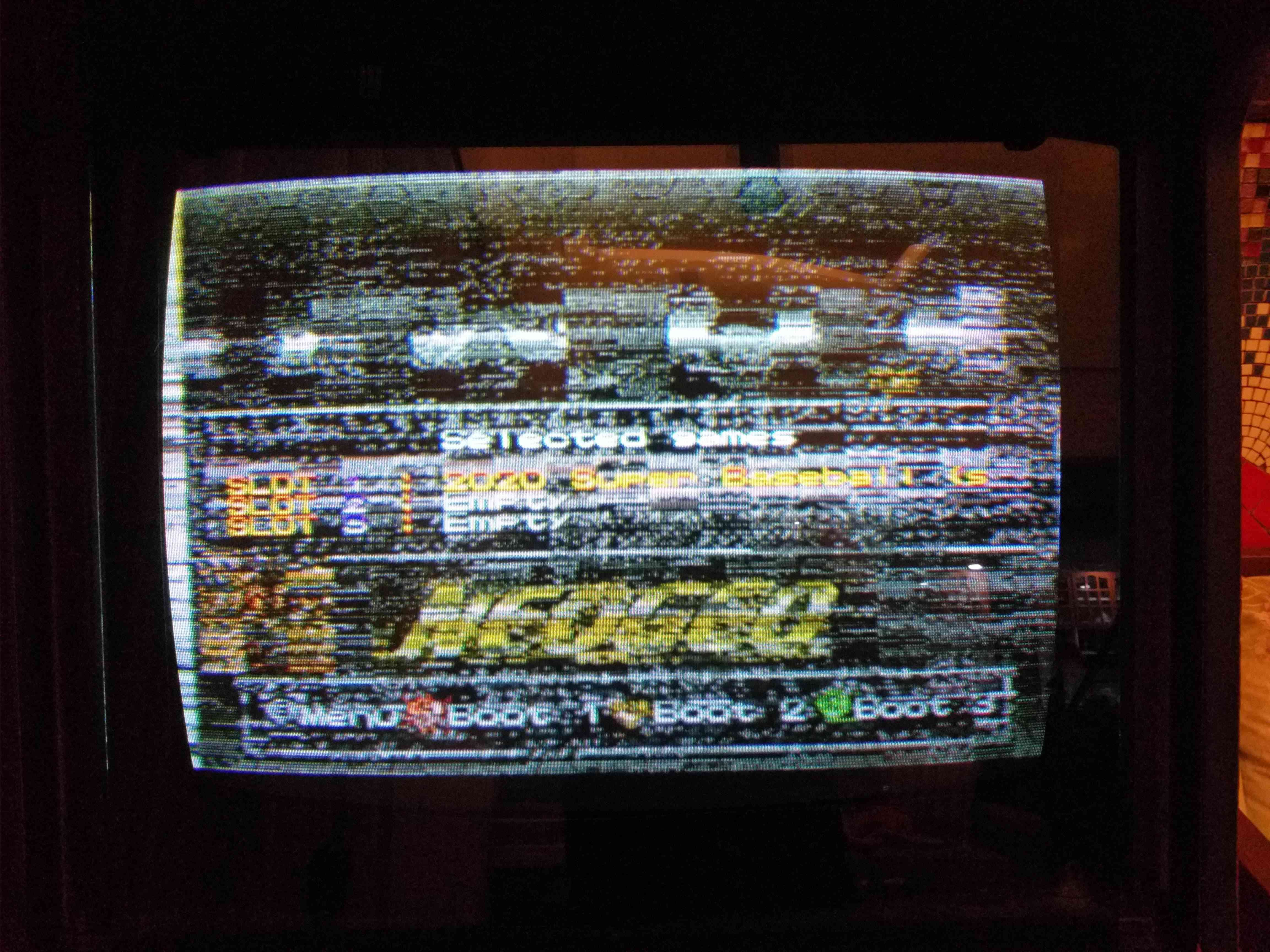

As I tested out the MultiMVS for the first time, the screen seems to be choppy (see attachments) and the left side of the screen seems to be glitching out as well. This problem persisted to the games. I restarted the system and even change slot (I use a MV4) but it still has this screen problem.
The only notable thing I can state is that my MVS has no active battery (as seen here Battery concern) and I use UniBios but I don't know if that matters. I also installed the menu and firm updates as instructed.

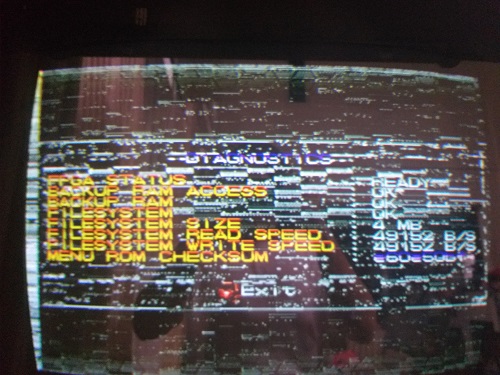

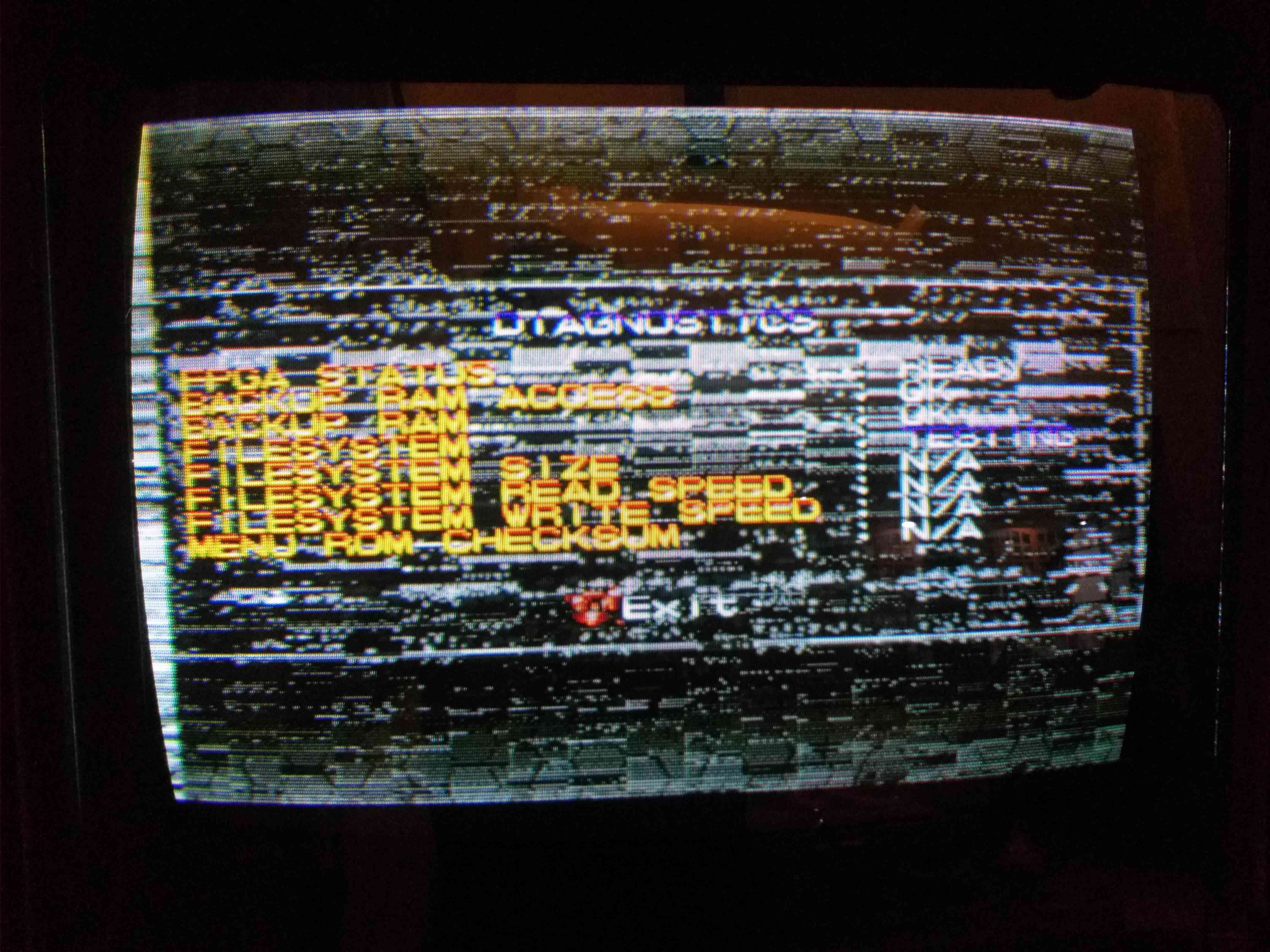

What seems to be the cause of the problem? Dirty contacts? Bad SD Card? I also would like to note that as I run the diagnostics, it got stuck on filesystem on my 3rd try. The 1st diagnostic was fine but the second one stated that the file system failed.I also like to state that on my 1st and 3rd attempt, the music played but on my 2nd test, it didn't.

A sample on what the games look like
Edit: As of November 13, I've tried some things but to no avail. I've also noticed some things as well:
-Placing the cart to the other slots would not fix the problem. However, I noticed that the music is gone when placed on slots 2-4.
-Bumping the firmware and menu to the previous version didn't help
-Deleting the Ram did nothing
-After loading a game and trying to quit back to the menu, the system will go to the crosshatch screen. I've also noticed this the first time I've inserted the cart.
-The 2 boards of the carts seems to have different color. The other one also has something black on it though I don't know if this means something or not (It's there when I received the cart). I assume the black spot is just dirt.
I've tried deleting the MENU folder on the game folder but it resulted into the cart/screen saying "File system not ready" when booting up. The glitch screen is still there. I put the MENU back and it seems that it's back to the usual.
I've also noted that at one point, the cart doesn't seem to be detected by my system sometimes due to how it stays in the crosshatch screen and no matter how I soft restart it, it doesn't get detected until I did a hard reset. I wouldn't say that it's a problem on the system itself since it works fine on my other carts.

Here's a screenshot of the diagnostic I took. Just don't forget that I don't have a live battery yet.
Maybe a voltage issue, imo the best thing to do like darksoft suggest is try the multi on another mvs motherboard to isolate the problem.
