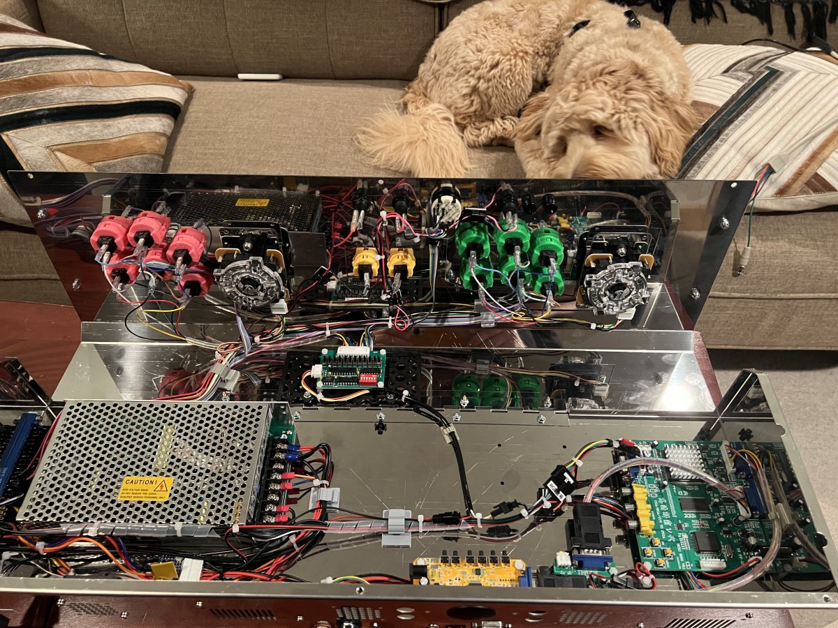

Hi all. I wanted to share my experience the past couple of days, with the COMBO AV EX++ supergun. Buying it, what's inside, the good and the bad, and mods I'm considering. It's been produced for years, but I haven't seen any comments about it on the forum so I thought I'd chime in.
First, a quick summary: The enclosure, controls, and internal wiring/harnesses are premium, craftsman quality. This is where the high cost is going. The circuitry for A/V conversion is decent, but as-is, it will not be satisfactory for most in this forum (including myself), and will require bypassing or modding. The designer composed the A/V conversion out of generally available, fairly low-cost, packaged components. The result has some quirks. I recommend this supergun to someone who wants a well-built twin fightstick supergun and either (a) is complacent with a decent image quality, or (b) has no problem making lots of changes in the spacious room under-the-hood to extract the best image quality. It could be a modder's dream, in some ways. I will try to describe these options below and in follow-up articles.

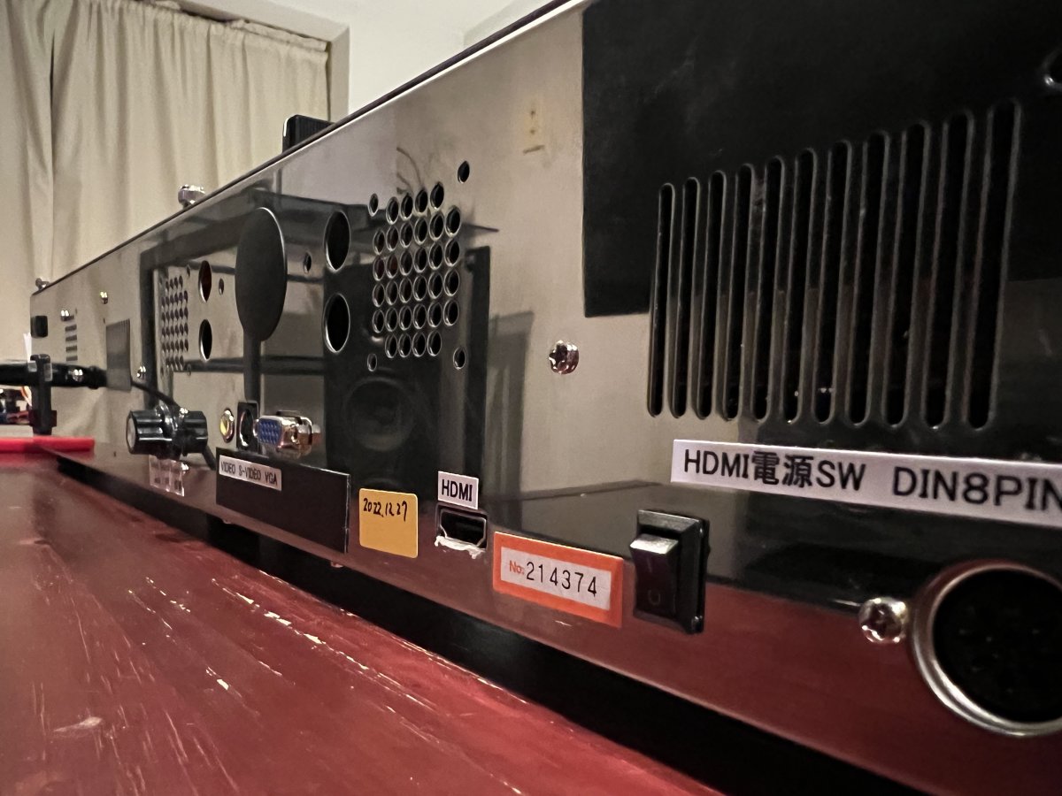

  4. Video: 1x HDMI out, 3x VGA out, 1x composite video out, 1x S-VIDEO out, 1x RGB out via DIN8 port
    1. This is the HV full option package. The Basic Package from ec.tops-game.jp does not have composite or S-Video. And the page hosted by the manufacturer refers to a normal RS package that doesn't have anything but the DIN8.
  5. Audio: 1x HDMI out, 1x line level 3.5mm audio out, 2x left and right speakers with volume knob/potentiometer
    1. The DIN-8 analog port does not include audio, so the display will need to accept audio from the 3.5mm line out.
    2. HDMI does include audio
    3. These are basic mono 2" speakers. The bass and max volume are not very good.

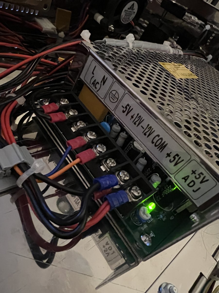

  6. 5V adjustable PSU (model? see PSU.jpg attached)

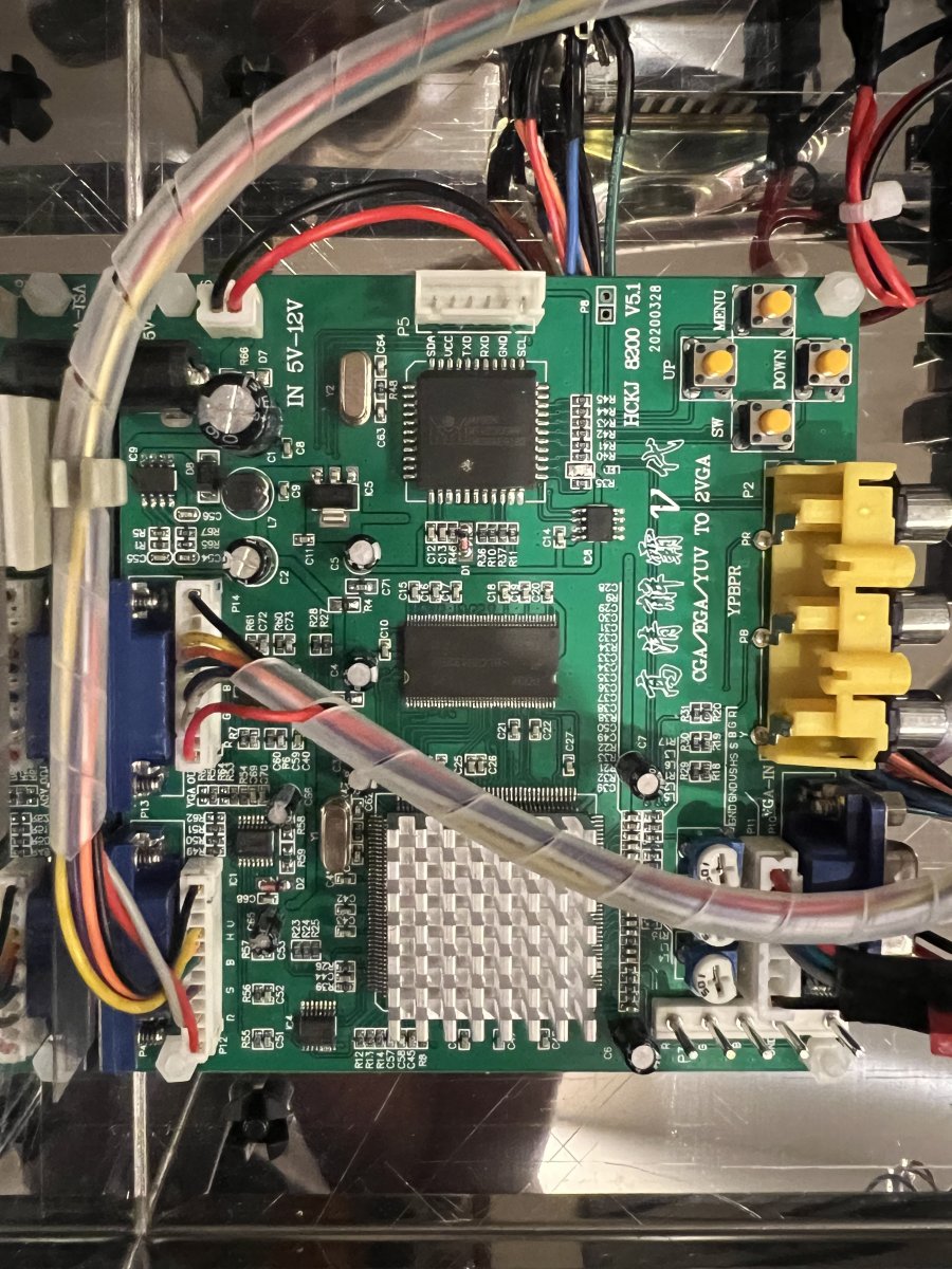

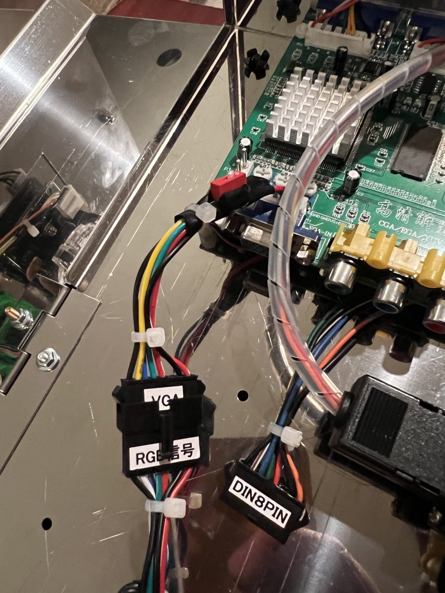

  1. Video upscaling/conversion is supported by the Gonbes GBS-8220 (specifically HCKJ-8200 v5.1 which is the latest version; see attached GBS-8220.jpg).
    1. I had to push a switch on this board for my older Sega Tetris / TGM PCB to work at all, but newer game PCBs worked fine.
    2. This is not present in the normal (RS) package described by the page hosted by the manufacturer.
    3. Out-of-the-box, this scaler is not ideal, to say the least. It introduces up to 2 frames of lag and processes all signals as 480i, causing 240p to have some flicker. Colors are okay but not comparable to a RetroTINK or OSSC.
    4. There is an amazing alternative firmware by Rama (github.com/ramapcsx2/gbs-control) that fixes this, but it is a fairly involved mod. As Bob @ RetroRGB covered in a video a couple of years ago, the board with this firmware outputs 240p correctly with a non-varying 4ms of lag, with 480i having less than a frame of lag, half that of the Framemeister.
      1. UPDATE 8/11/2023: It turns out the Rama mod is not ideal for this case. Rama's GBS-C project is clearly meant more for consumer console inputs. Sync times on arcade games vary wildly, especially early 90's and before, and thee GBS-C performs worse in the syncing than the original GONBES hardware.

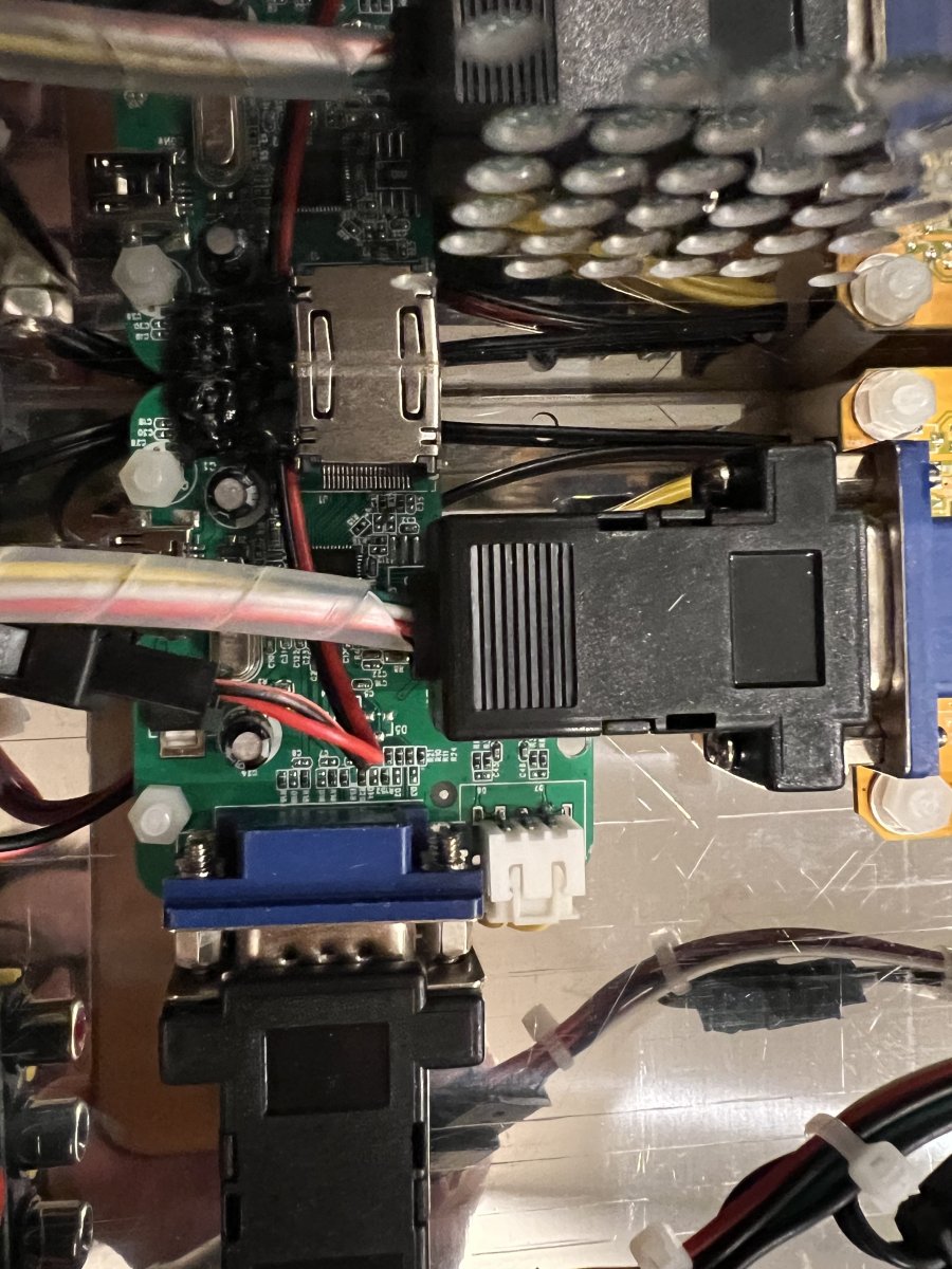

  2. HDMI video and audio is enabled by a second VGA2HDMI converter taking video input from the Gonbes in (1) and audio directly from JAMMA, attenuated by a rear knob. There is no model number on this board and I don't know the origin (see attached VGA2HDMI.jpg). It does seem to work fine on my LG OLED display and Alienware LCD monitor. I expect this is a zero-lag device, but need to do lag testing.
  3. For the upgraded "Full Option Package" at ec.tops-game.jp, there is also an S-Video and Composite video output, from a decoder taking input from the Gonbes in (1).

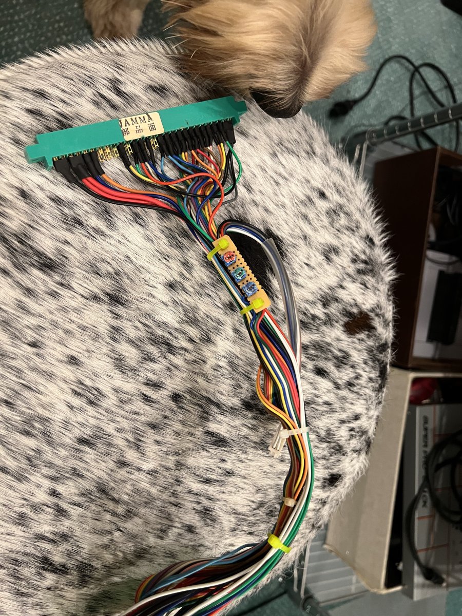

  4. All of this can be bypassed completely to the DIN8 RGB port (same wiring as the Sigma superguns). This is the same as the normal (RS) package referred to on the page hosted by the manufacturer, which doesn't have any output ports except the DIN8. One can swap between them manually by unplugging / replugging harnesses (see attached RGB_BYPASS.jpg) internally to the unit; see photo.
    1. Again, RGBs is wired directly from JAMMA in this case, so unless this is going to an arcade monitor, it needs at the very least RGB voltage attenuation pots on the JAMMA harness. Ideally the attenuation circuitry would include an active amplifier (THS7374 or the like) to attenuate the signal and isolate it from the arcade PCB (see Tim Worthington's "AV-Driver for Arcade RBB 'Supergun'" article for why this is preferred to simple potentiometer attenuation).
    2. Audio is not wired to the DIN8.

Is there a way to adjust the voltage on those things without opening the unit? Some later boards are really power hungry and I guess that if you cant adjust the voltage..
I was close to buying this late last year but went against it due to the jamma edge being on the controller itself. I would have preferred something the line of having extra length for the connector. Obviously, I could have gotten an extender but for the price, I felt it should have been an option. I may still get one in the future.
@jammajunk Yes, I included a photo of part of the power supply. There is a +5V adjustment potentiometer.
    2. Out-of-the-box, this scaler is not ideal, to say the least. It introduces up to 2 frames of lag and processes all signals as 480i, causing 240p to have some flicker.

  3. All of this can be bypassed completely to the DIN8 RGB port (same wiring as the Sigma superguns). This is the same as the normal (RS) package. This is done manually by unplugging / replugging harnesses (see attached RGB_BYPASS.jpg) internally to the unit; see photo. RGB is wired directly from JAMMA in this case, so unless this is going to an arcade or professional broadcast monitor, it needs at the very least RGB voltage attenuation pots on the JAMMA harness. I have one of these cables (see attached JAMMA_RGB_POTS.jpg) but can't for the life of me find any on the web, now.

Hey there! I actually did need to press some button on the GONBES PCB inside the unit, to get the video output work ok some boards. I bet you are experiencing the same issue. You should see some instructions in the manual on the GONBES.
