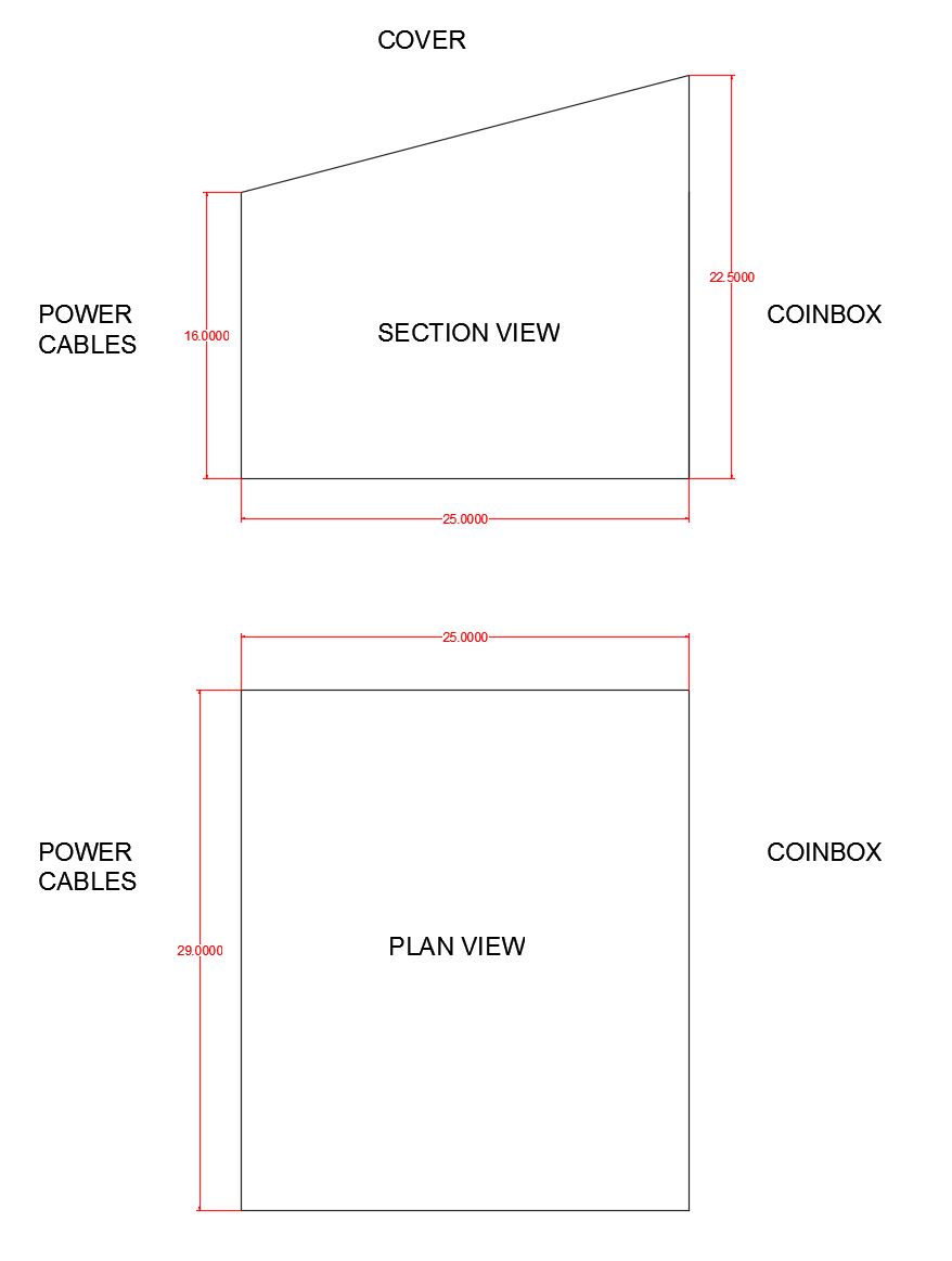

Here is a picture to illustrate space available inside the cabinet.

this is the maximum room available

Tighter than I though, best option would be to just go without a case and mount the separate components on a wooden board or boards like the jamma area, and cut up an old or cheap case to get a structure for the motherboard and graphics card to support them.
You could make a main piece of wood that fits in the space available and maybe add another piece over it towards the coinbox to stack parts on top of each over.

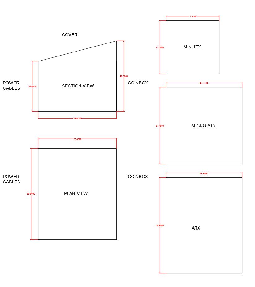

that's what I was thinking, case would be a lot of pain, but the mobo choices is very limited if I want it to fit this space along with the PSU.

If mounted everything on a piece of ply wood, you could get a pcie and pci extension ribbon cable so you can lay the video card and sound card flat next to the motherboard. Get a Jpac from ultimarc and run the vga out from the video card to the Jpac and you’ll have a jamma edge for the PC. Get a two way Jamma switcher from Mike’s arcade and you can switch between the pc and a jamma pcb without using the video switcher.
