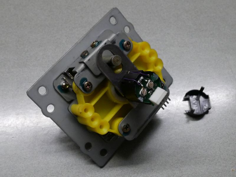

Oh shit, look what I found:
Found two sticks. Unfortunately spinning the other one you can definitely feel it drag at some spots. The other one is smooth all around.

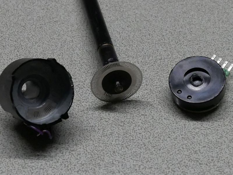

Anyway, I pulled one apart for science:
oh wow, that is way more than 24 steps, I'm guessing 100 based on the number on the wheel.
Thanks for the fantastic pics.
I'm guessing this has smooth rotation and no "notches" like the LS-30?
Any part numbers anywhere on the spinner unit?

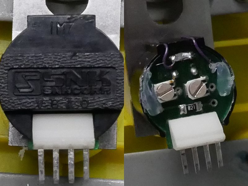

Here's pics of the end cap and the other side of PCB:
Apart from the end cap (IM7, SNK CORP, VBAO), no other markings.
