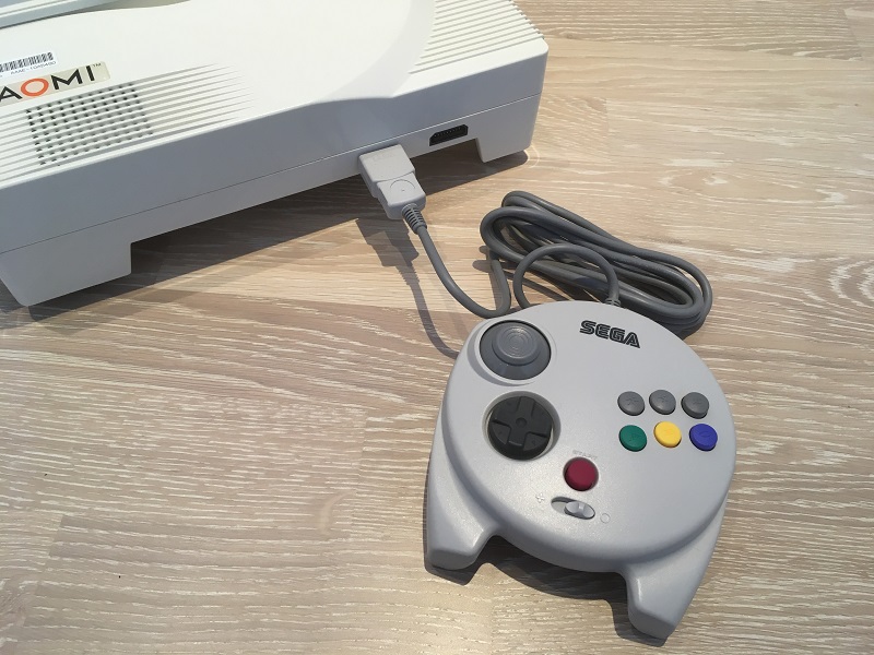

Wanting to do something different, I opted for Sega Saturn control ports. I'll admit that this was primarily as they match the colour scheme of the Naomi... :whistling:
The other reasons being that I love the feel of the Saturn digital pads, the overall range of available accessories, and... Analog controls.

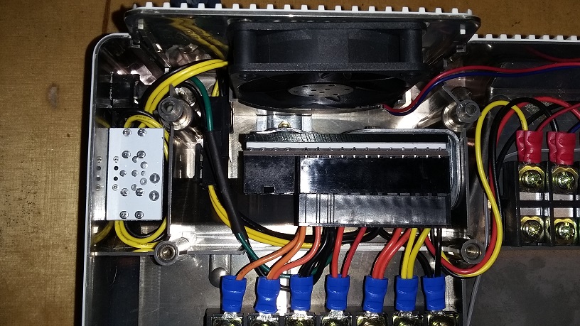

So this is how it looks inside. You will probably notice the power management. I wanted things to be modular and I wanted to ensure that I didn't limit current to the motherboard.
The DC-DC PSU is only rated 160W (200W peak), but has preformed flawlessly so far. Thanks to Larry from HDPlex for some technical assistance there.

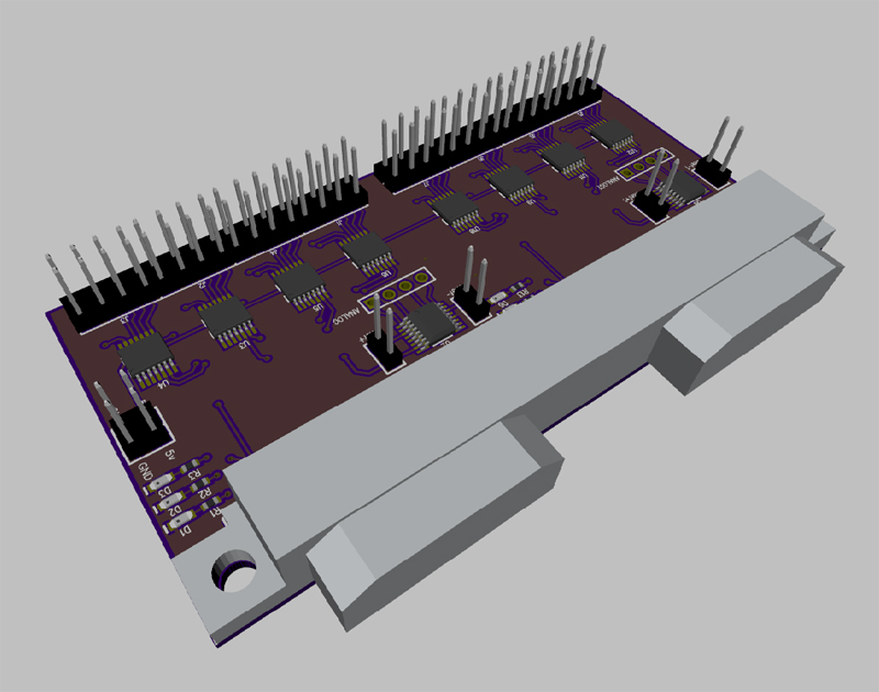

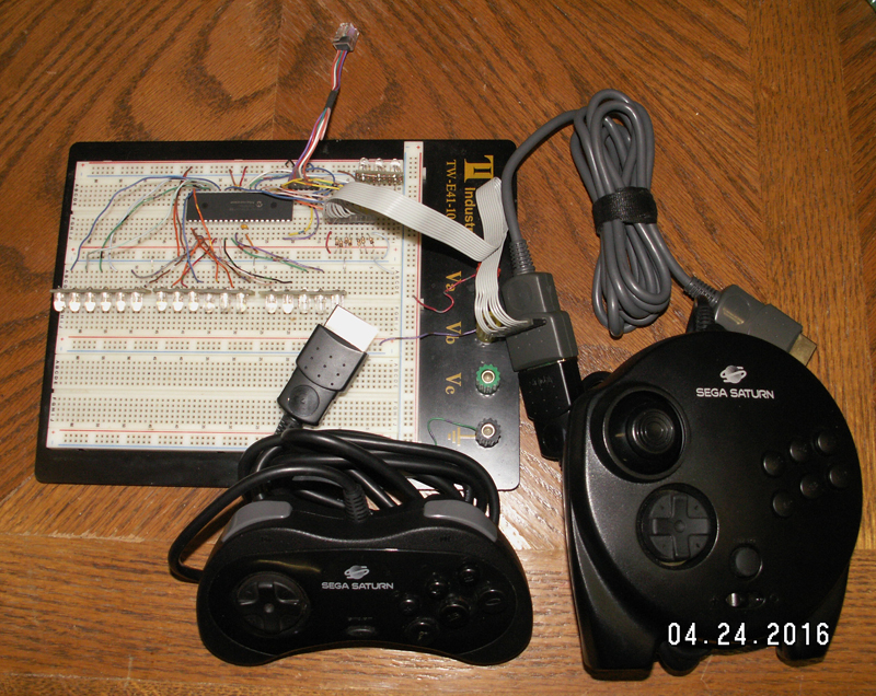

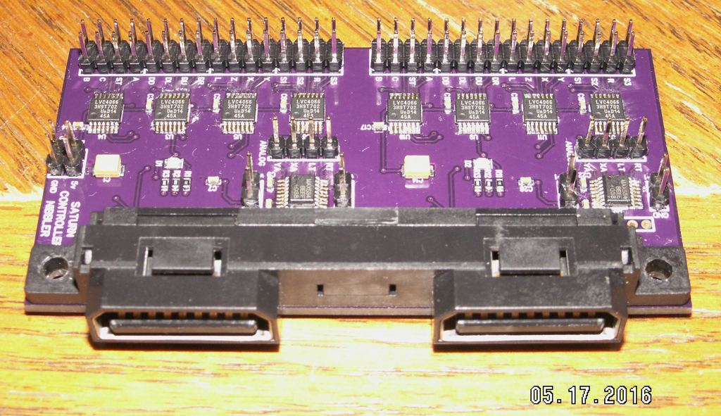

Controller input is handled by the 'Saturn Nibbler' (bottom right) - a custom board made by RDC that handle the Saturn controller protocol translation.
The digital side has a total of 16 outputs for UDLR, Start, ABC, XYZ, LT, RT and 3 software controlled keypress combinations (X+Y+Start = Coin Up).
The analog side has 4 outputs, X & Y axis, LT & RT that output 5v potentiometer style signal for the JVS I/O to interpret.
The JVS accepts 8 analog inputs (A0-A7) but lacks almost any form of standardisation between titles. The Nibbler therefore allows X/Y axes to be inverted or swapped.
Another key press combo puts the 3D controller in to 'Driving mode' so that brake and accelerate are correctly mapped to the LT & RT respectively.
Believe it or not, even the light gun games are playable - albeit rather clumsily - with the analog joystick. The relay switch in the middle remaps P2 controls from the P1 LT/RT to P2 XA/YA.
Thanks again to RDC for all his hard work and assistance. Apologies that I only really managed to hold things back with taking my time with the rest of the build.
The board above went from 1st draft to assembled prototype in 2.5 weeks... By comparison, shipping out to Norway took a week in itself...

First of all that tiny power brink has been replaced by a beefy HP PA-1231 unit. The Raspberry Pi was also upgraded to a model 3 with onboard Wifi as I never got the dongle to work with PiForce-Web...
The ATX wires are all AWG18. Not pictured are the terminal connection blocks and wore crimps used for power distribution. The 160W HDPlex DC-DC ATX PSU I used was mounted at 90deg with 2 angle brackets. Unfortunately this model has now been discontinued and replaced by a new form factor similar to the PicoPSU models.

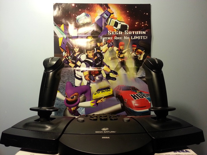

This project is becoming more awesome every update. I know you got the analogue controller working, so does this mean you could technically use the mission stick and steering wheel as well? (yes I know the Saturn wheel is garbage, but the ability to use it would still be cool)
Both are compatible, but there are other limitations.
RDC even picked up a second Mission stick to try out the twin stick configuration (stock image below...).
That would give you a total of 6 analog inputs in theory..
