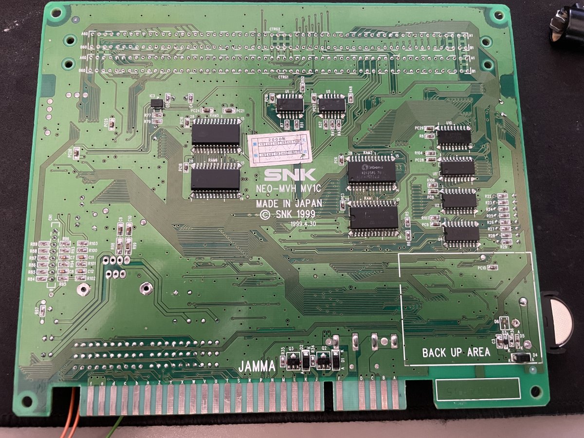

Im happy today becouse i got my new MV1C from Aliexpress...
Here is it after battery, stereo and bios mod and a general clean up :-)

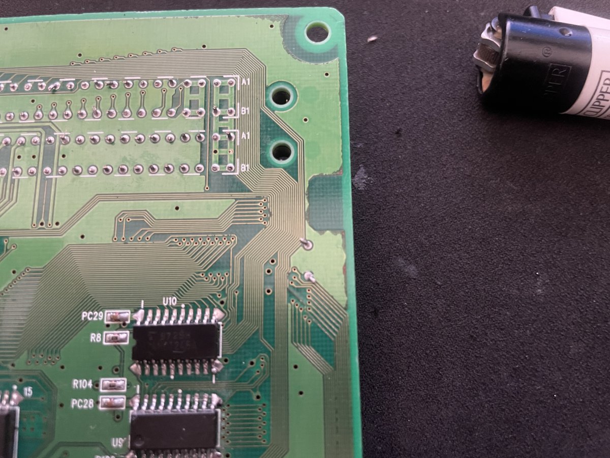

After some tests everything works fine but I have two important doubts.
1) What is this ? Corrosion ? I have to worry ?
2) I applied the bios with the integrated memory card without removing the stock one and it works... the unibios starts and I can also save.
If I unsolder pins 10 and 12 of the original bios to disable it, the unibios starts giving an error on the memory card. (i solder it back now)
