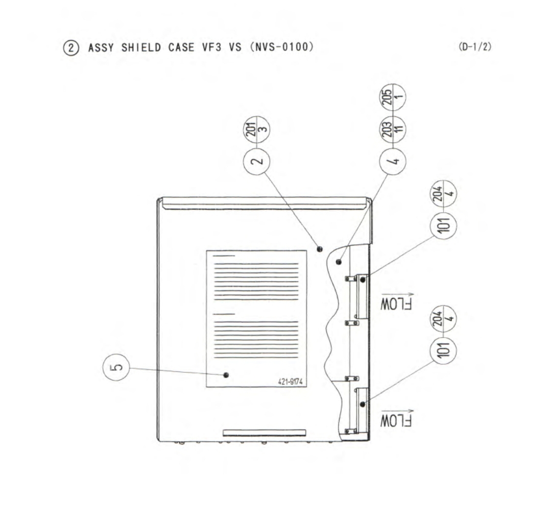

I ended up just stumbling across one of the manuals for the game and it seems that both fans are pushing air out? I dont know a nick of anything about airflow but is this even safe in the long term?
Ya, it looks like my memory was correct, but not correct about the number of fans! It seems to be pulling in cool(ish) air from outside, which is drawn over the board and then out through the fans. This is why it's critical to have the cage; no cage means you just have hot air circulating everywhere, and the PPC gets real hot...
