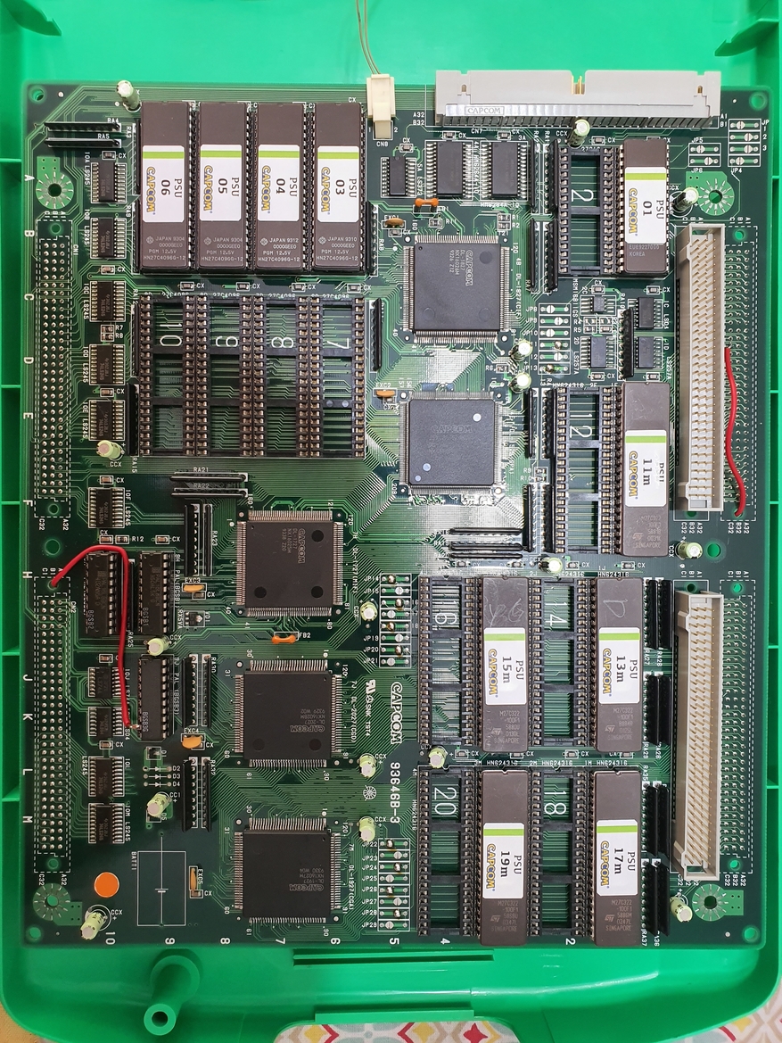

If the jumpers are ok and ROMs 11 and 12 are ok too, you should check the B Board Revision number. If it is Revision 3 or 4, it should have a wire jumper from PAL3 pin 9 to C13 pin on CN3 connector, because those old revisions need an extra route to work with 4MB audio ROMs and PAG type G. The Pin 9 from the PAL3 should be left out of the socket too.
This is an example of this kind of conversions over Revision 3 and 4 boards.You can see the red wire jumper I mentioned.

Someone mentioned it above but PAL jumper wire isn't connected or connected incorrectly - I'm thinking it's a PAL G and it's connected to pin 9 but it hasn't been removed from the socket
Which makes sense as I know whom did the conversion and in a similar conversation re the multi, they had no understanding of the PAL requirements.

The jumper settings on my board were correct. This was fixed in the end by adding a wire from PAL3 pin 9 to C13 pin on CN3 connector and also leaving pin 9 of the PAL3 out of socket as @Telpherion explained above.
Anyone have a solution? I have the same Sound Problem. Was trying with that Jumper cable, but then i have a other Sound Crap.
Thank you! Yes its aliiiiveeee! I have the board over 2 years. I was think Its a broken costum chip or so.... Im so happy now! Thanks Guys! ❤️
So seems like you guys were able to fix this with a jumper wire on the B board? What if the issue is tied to my A-board? I've tested both a VSAV stock Bboard as well as the multikit and it works with one of the A boards but the other gets weird sound glitches as described above. Any ideas on how to fix?
The image above looks like it's from the B board and I don't have any socketed PAL on my A board, all soldered ones.
