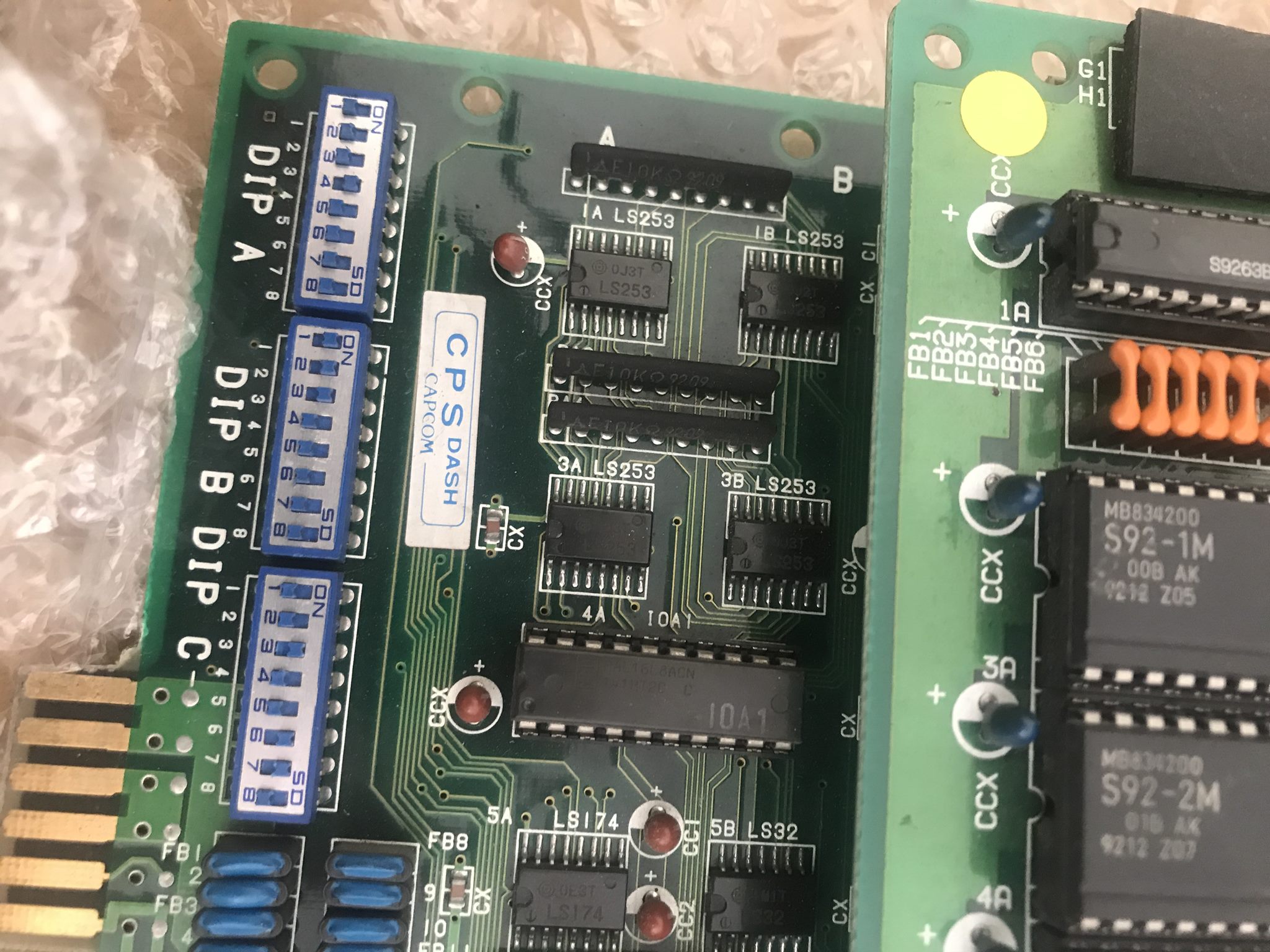

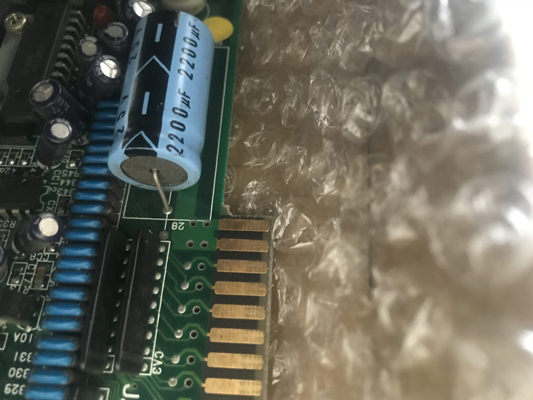

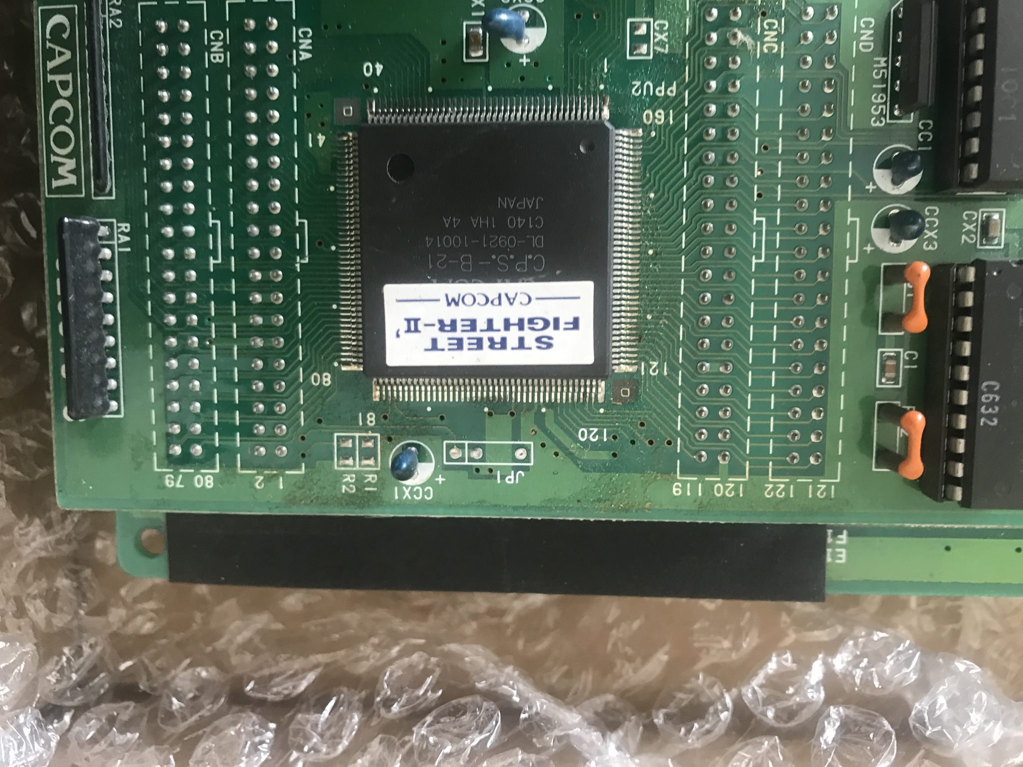

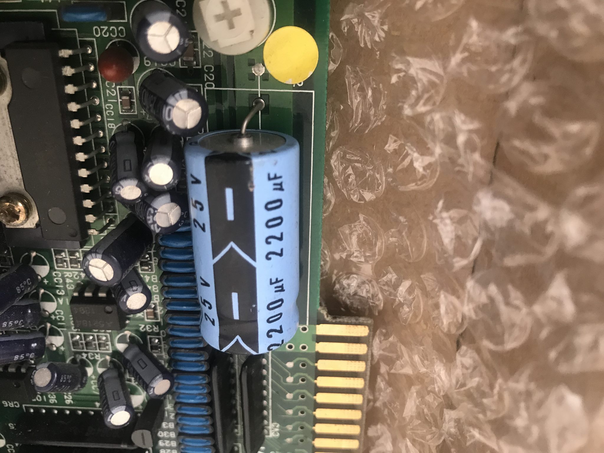

Hi all, hopefully I'm posting in the right area.
I'm looking at buying a SFII' Hyper Fighting board off a local auction site.
Is there any tell tale signs that I need to look out for when buying a board? - pics are attached(hopefully 1st time posters have enough rights to do so :))
Background of sale is that seller wants to mame the cabinet and has decided to sell the PSU and board from the cab.
Any feedback would be appreciated.
Cheers Rautz.

Looks good. Dash A board like it should and it is an original SF2CE upgraded to HF.
test it though if it has no graphic errors, if so the A board is broken and most of the times unrepairable because the custom is the root cause.
