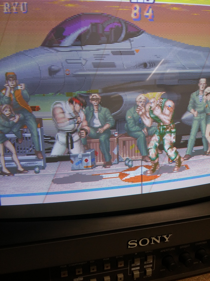

Anyone know where one would begin to try and fix this CPS1 A Board: https://youtu.be/U-s9AXesHrA
Apologies for the poor video quality, I recorded that then put the board away again. You can clearly see my issue though with that missing Ryu sprite.
I have swapped the game over and have the same sort of thing going on with a Daimakaimura conversion. Fault definitely follows the A board.

This problem is odd:
The problem only happens as far as I can see with the Ryu sprite and get this: it happens on a World Warrior B&C combo and also on a Hyper Fighting B&C

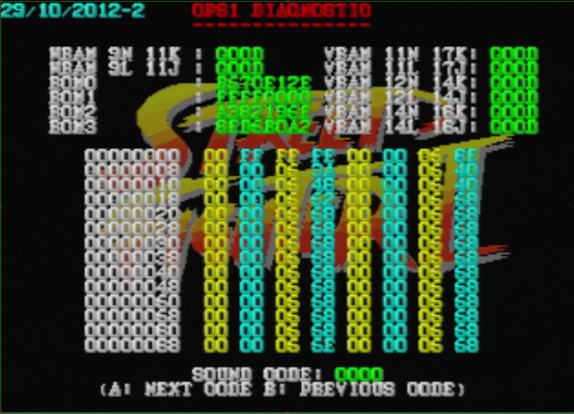

So @Apocalypse you reckon this looks more like the DRAM issue you think? As in one of the 12 HM53461ZP-10 is likely faulty?
No clues here unfortunately :(
I had a very similar issue, Ryu's legs were cut off etc, ended up being a loose solder joint on one of the custom pins.
Thanks Frank, on CPS-A-01 yeah? I'll reflow those and see how I go. I tried reflowing all the DRAM connections.
The DRAM is pretty reliable stuff, I haven't seen faults with this in the past.
SMD pins needing a reflow however? Absolutely.
