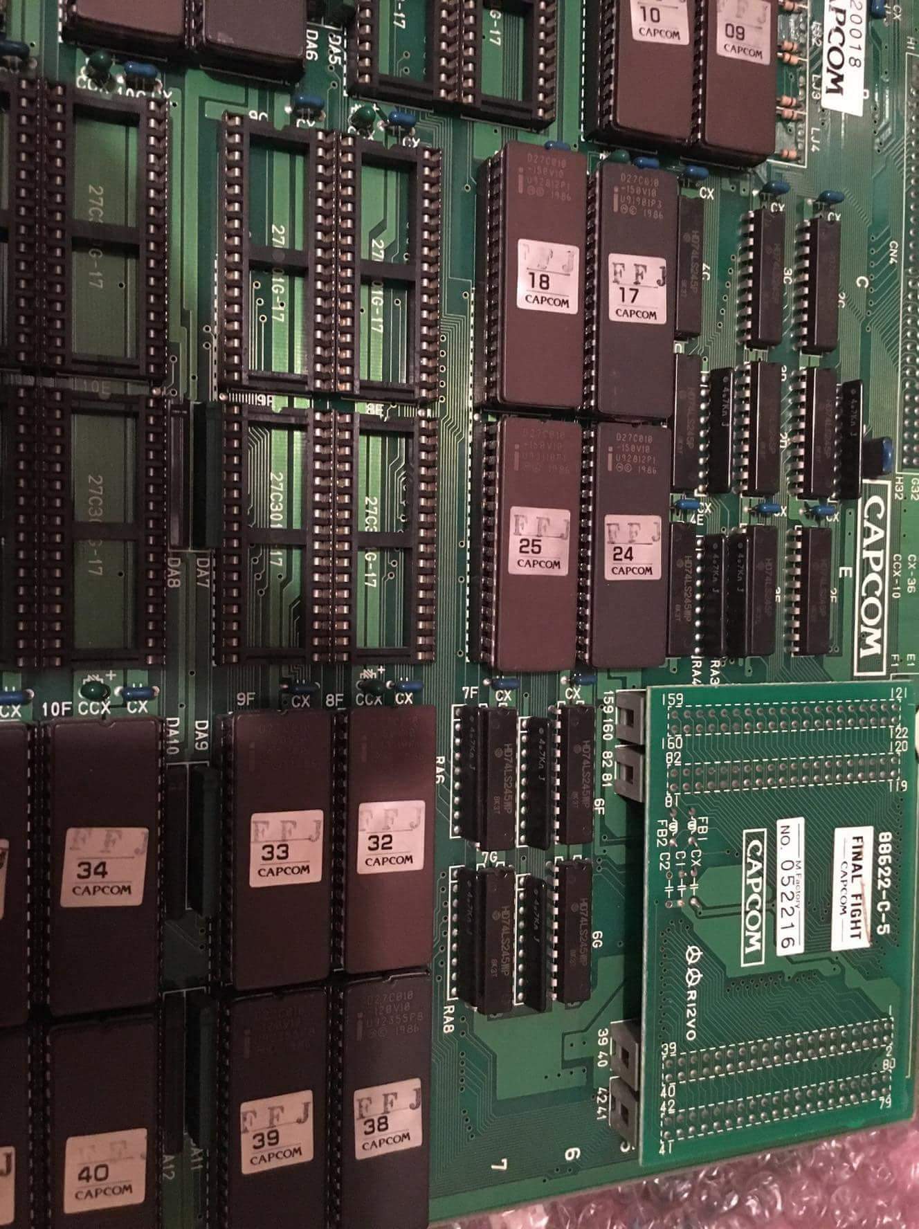

I PLAY ORIGINAL CPS1 FINAL FIGHT LAST NIGHT, BUT I GET THE PROBLEM, CAN TELL ME WHICH PART FAILED?

Might be a dying video ram or A board custom, you got a different A board to test?

You have two Final Fight B-boards, both with this same problem, using two different A-boards but keeping the same C-board?

Is this a conversion issue? This looks like a legit hardware failure problem.
Could be bad mask ROMs, though it would be unusual for it to be the same on 2
Yea highly unlikely given he tested two different A-boards and two B-boards, I believe the issue is the common piece, a damaged C-board.
CPS-B-04 ASIC are notorious to go bad more that CPS-B-21.I have 3-4 faulty Final Fight C-BOARD.Anyway, you can replace it with a more common CPS-B-21 C-BOARD using modified program code, some time ago I personally prepared the code and it works fine.
No hardware modifications are required on B and C-BOARD (different program code apart) expect for the fact there are two revision of CPS-B-21 C-BOARD with different dimensions (one is bigger than CPS-B-04 one).But I guess you are the usual maniacal collector and want the board exactly as the genuine one (inlcuding the same dust particles...) :)
