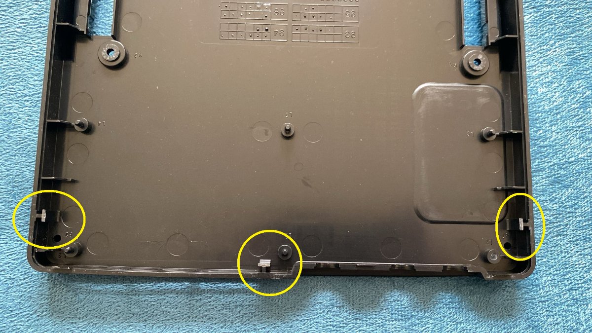

How to open CPS2 B board case without damaging three black pieces on black part? Thank you!

I had the same problem when I first got mine. Lift the top of the shell and carefully move it side to side and eventually they will start to release. Be patient though, Capcom didn’t really design these cases to be opened often and the plastics are getting more fragile as they get older. You can also try and lift the top shell and take a thin flathead screwdriver and carefully push the clips in to release the top shell. Most of these clips are already broken off on most boards. Once you get the top shell off, I would take some fine grit sandpaper and file down the edge on the black clip. It’s better to just file it down a bit rather than to risk damaging the colored shell from taking it on and off.
Hope this helps!
Hope this helps!
My experience with these is very random, some times they open nicely some time don't. Usually I start from the FAN side an then push it to the front which sometimes work but every time these clips get broken Im close to heart attack. Maybe someone developed some way to always get it done in good way. Anyway, Thank you!
Just open it slowly from the fan side (put board upside down, then pull the two halves apart from the top of where the fan area would “rest” on the B board. Pry them open slowly (emphasis on slow!) which will increase your chances of separating them intact.
