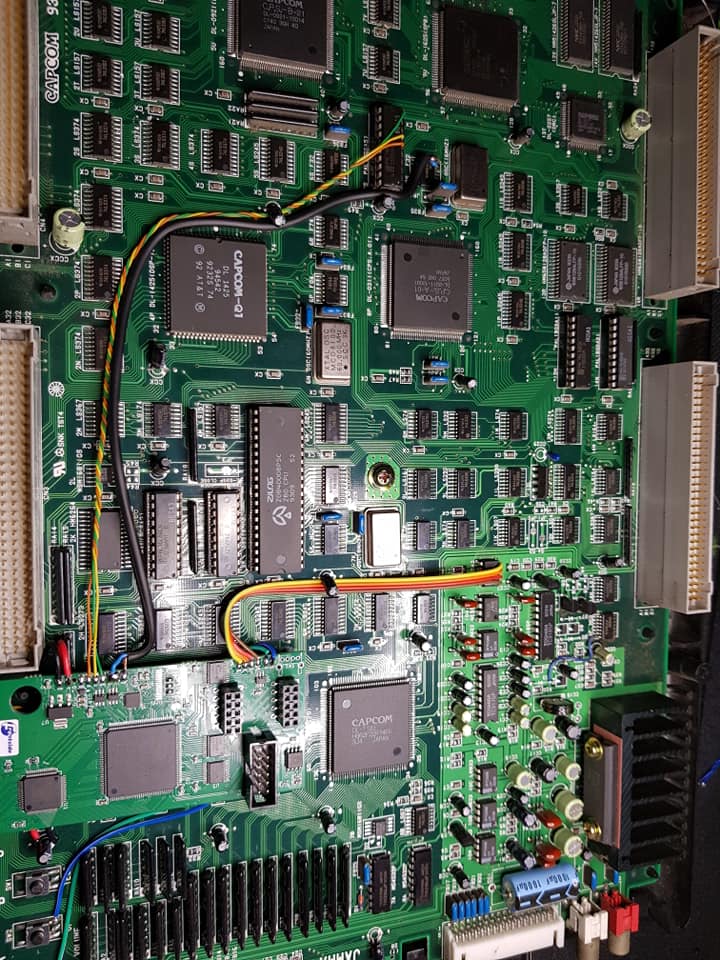

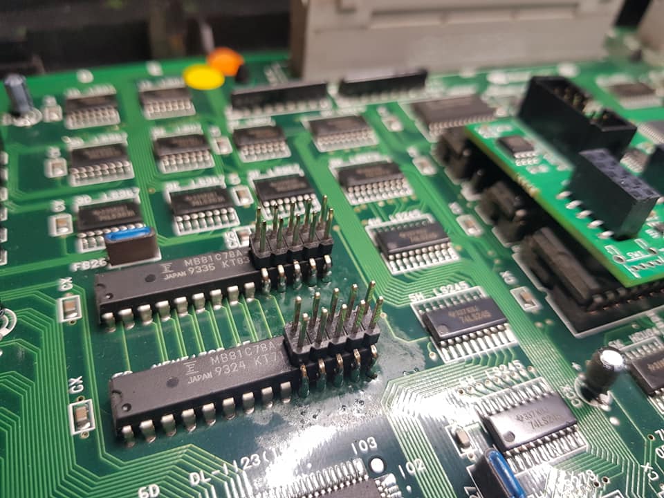

hello guys

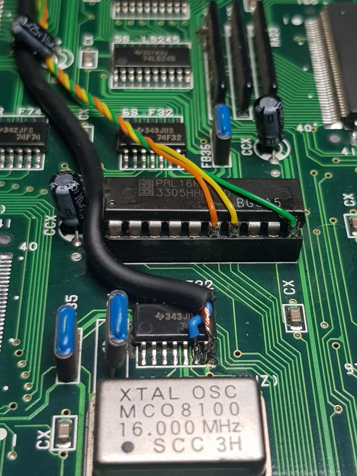

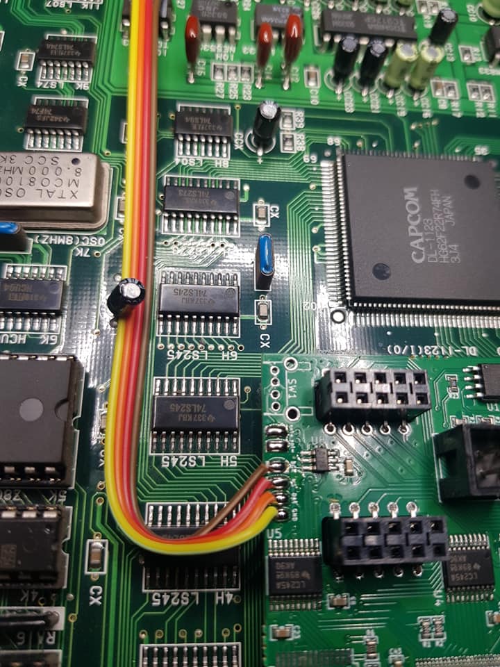

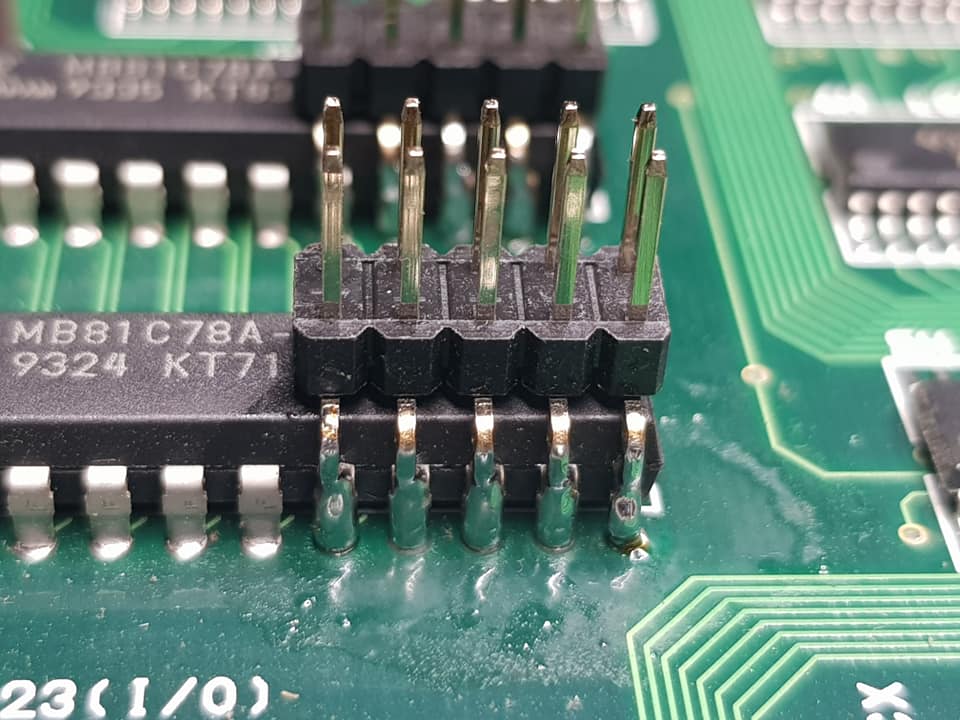

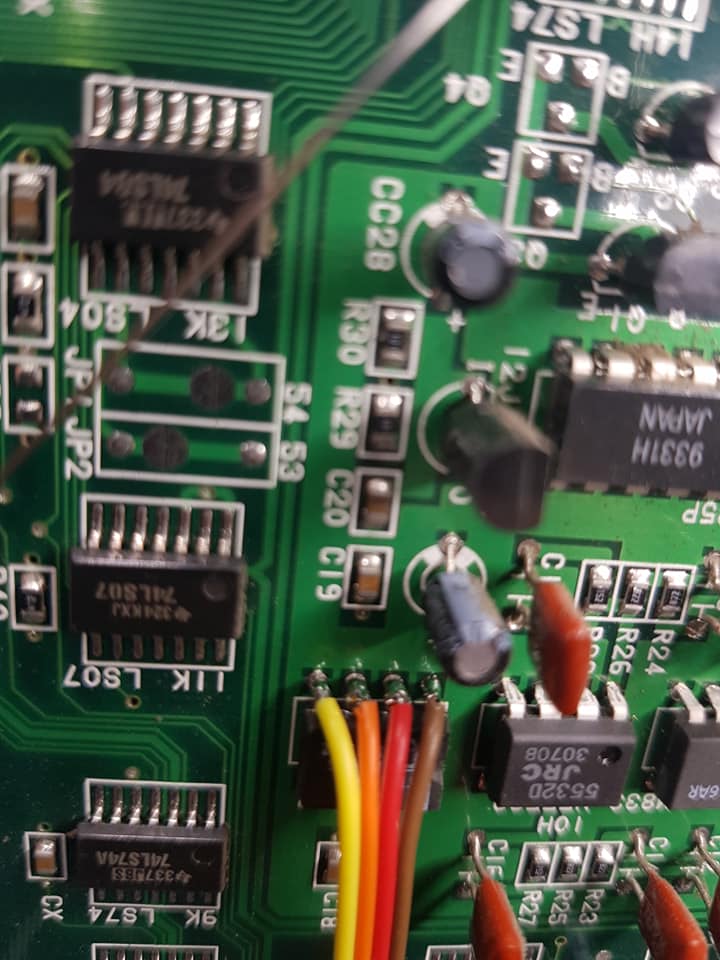

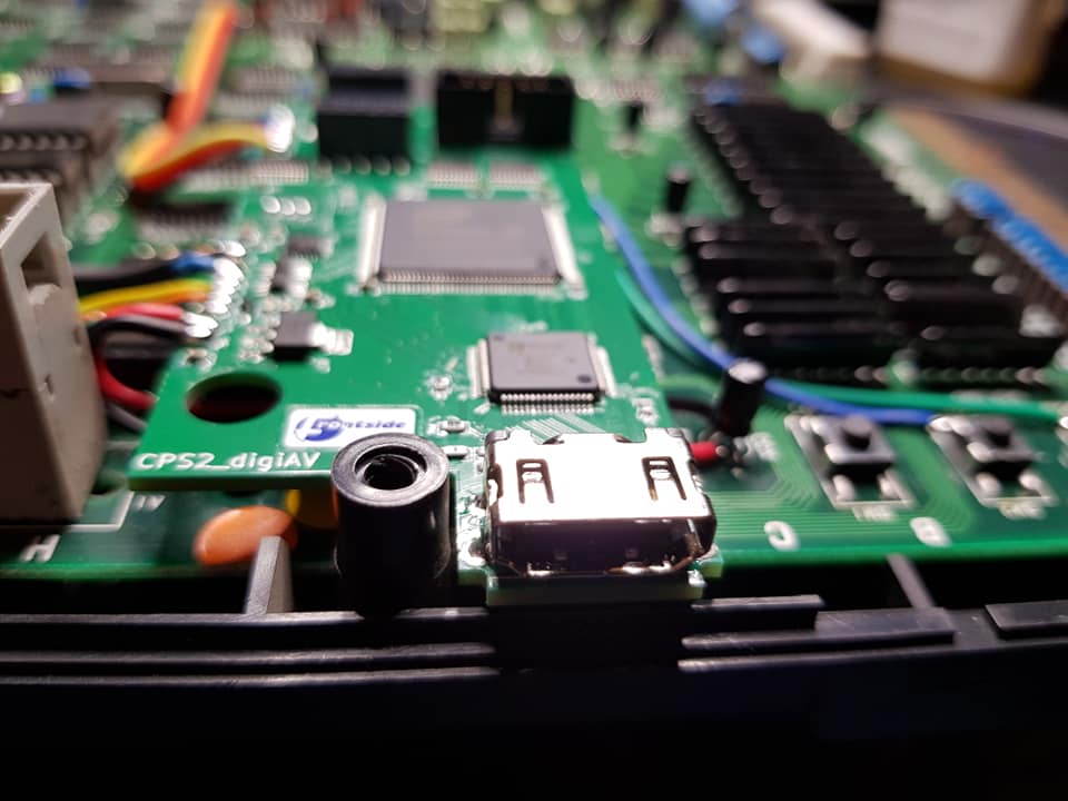

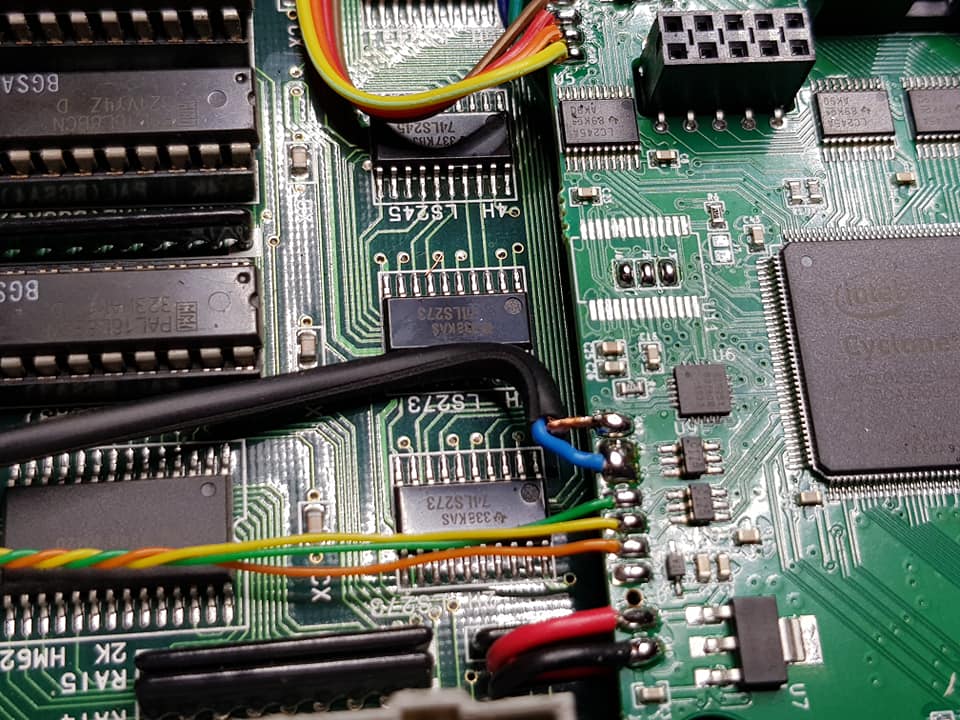

i hope can i help with this footage of my cps2 digital encoder installation.
remember to close the 3 jumper, a good shield cable "like microphone cable" for clk point
and a bit of flux for better soldering :)
