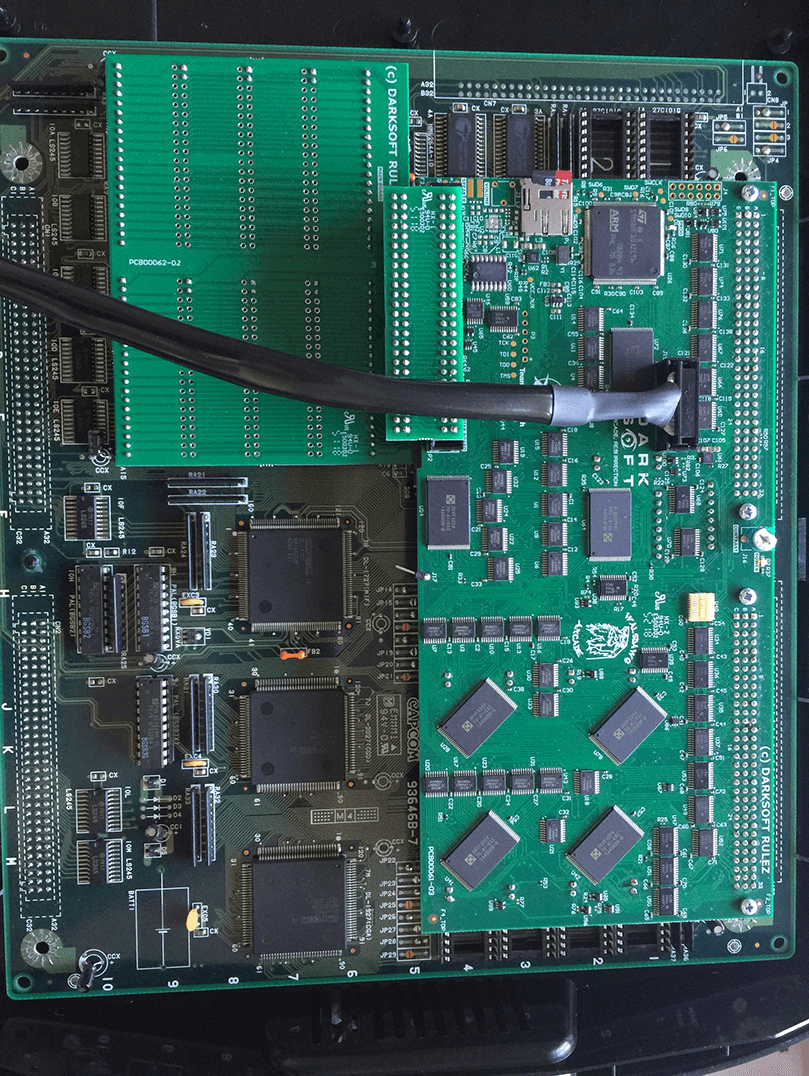

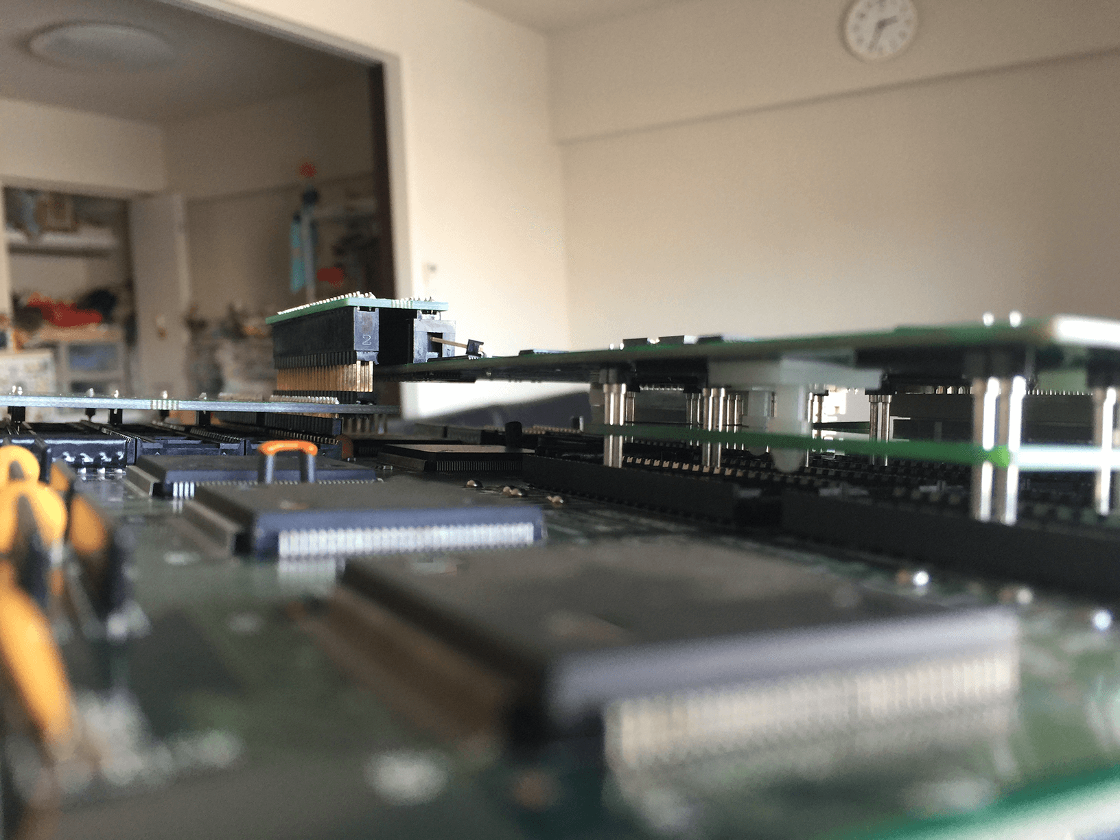

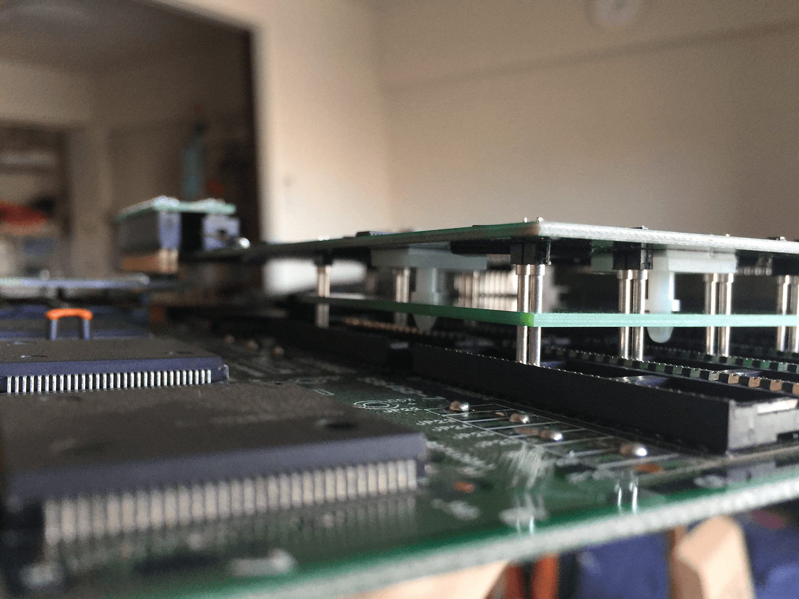

I just received my multi CPS2 kit, I am very excited.
I tried to install it following all the youtube video and the information I could found but I have only a blue screen.
The B board is a revision 7, I removed the battery, shorten the EXC5 and EXC1 with a screwdriver for 60 s each (is it enough ?). Checked the jumpers,
added the PCBs as explained by Misturugi.
Formatted the mini sd card fat32 using windows 8.1 bootcamp from a Mac. I have downloaded to files zip CPS2 Roll-Up Base Pack and CPS2 Complete MAME add-on Pack.

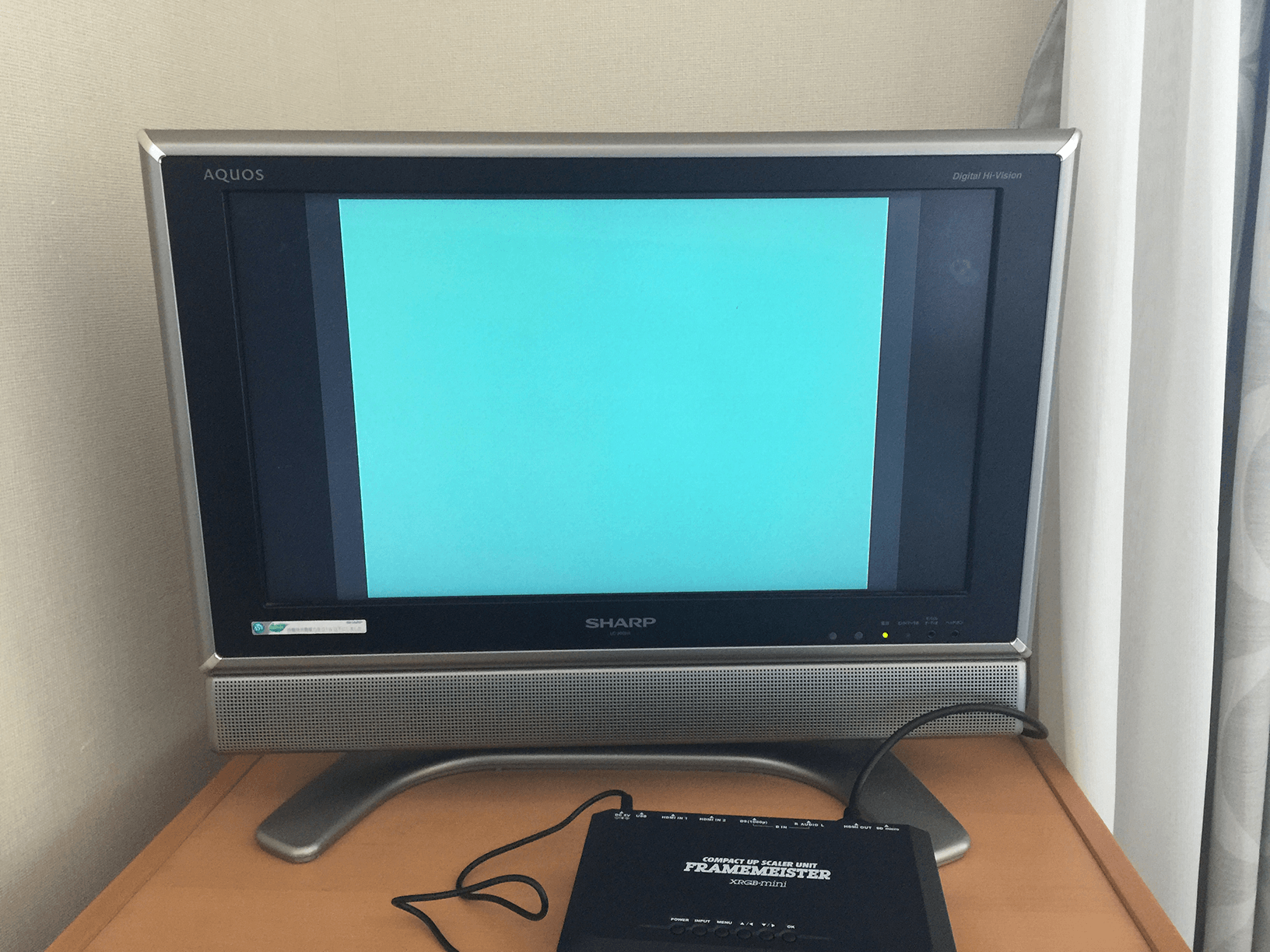

I have used winrar to open CPS2 Roll-Up Base Pack and add the file to the sd card, a file games is created. I though it was fine, I have then introduced the sd card in the board, plug the B-board to the A-board and run everything and a blue screen appeared on the screen. The LCD screen shows the games, I can change the game, there the progression, when it's done a message appeared : "all done ! have fun " still the blue screen was remained.

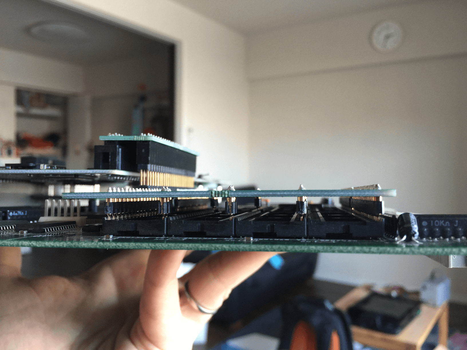

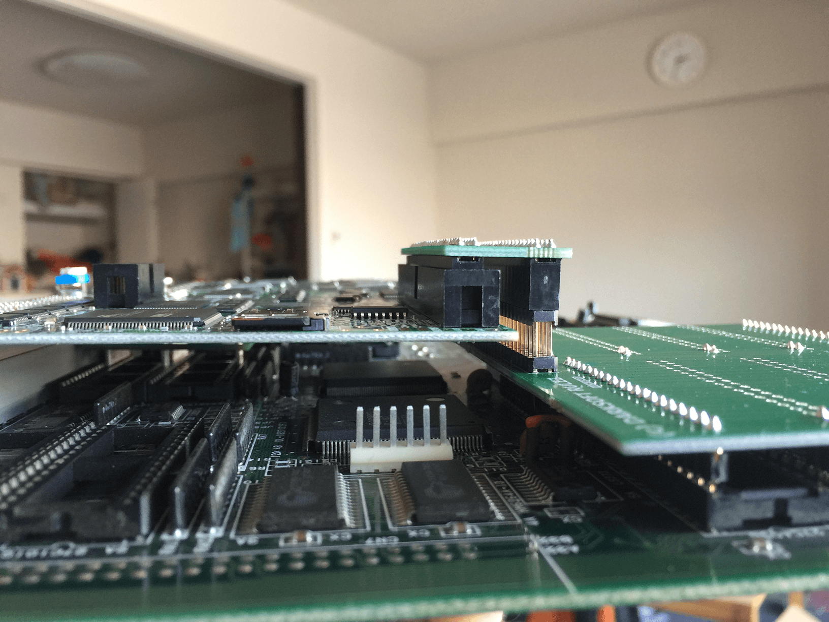

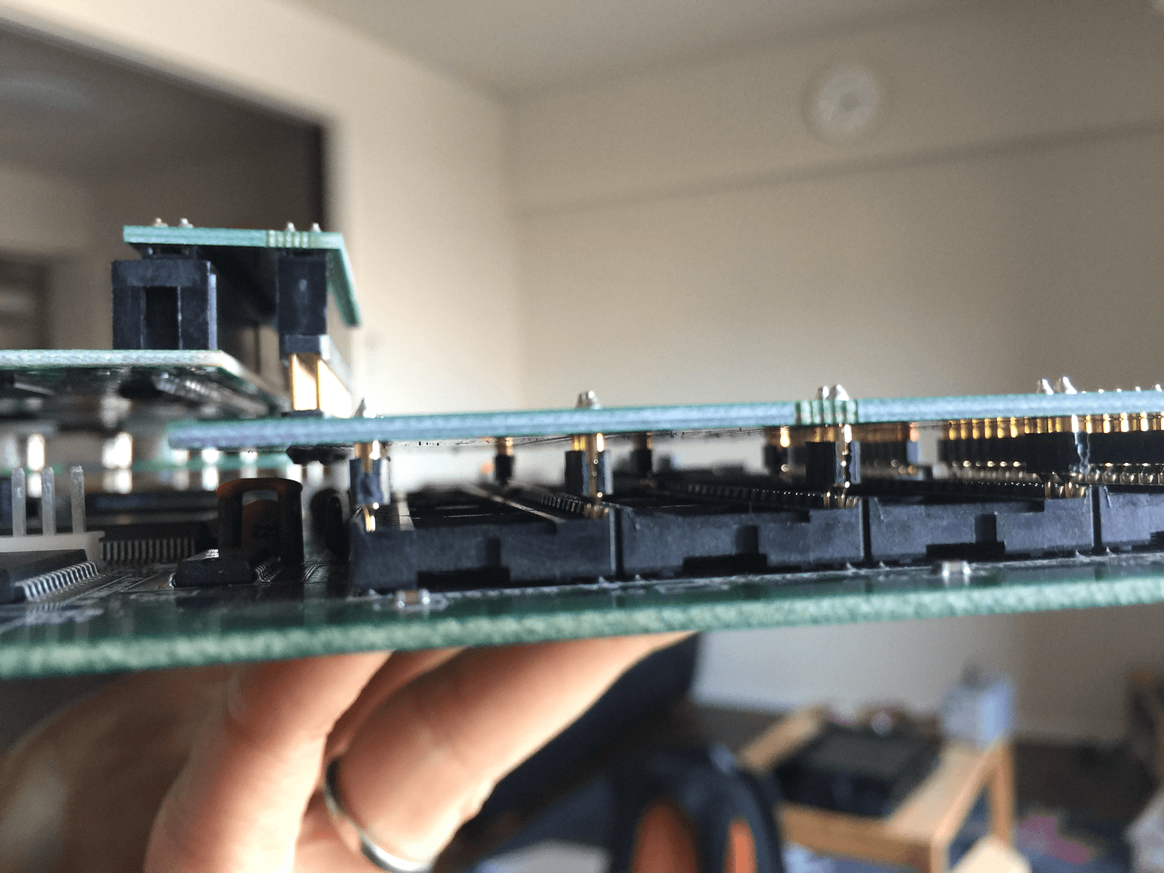

I though then that something was probably not well plugged so I removed every things . Short the EXC5 and EXC1 with a screwdriver again, because I have seen that sometimes the pub is not well suicide.
I reassembled everything, change the SD card to a sandisk formatted fat32, install the roms, insert the card, plug and switch on the supergun and same thing, blue screen
I need help please, If anybody has any suggestion please tell me

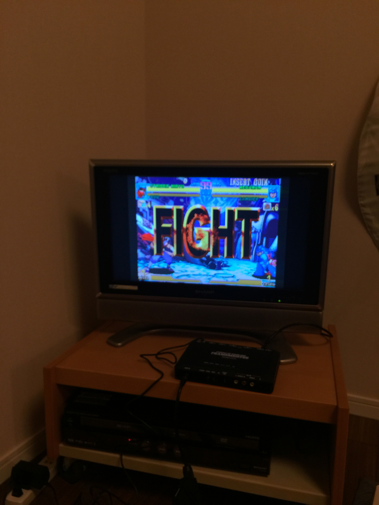

MVC unlocked worked thank you very much Mitsurugi, thank you also to AlxUnderbase and ShootTheCore
If I understand right I have to improve my soldering skills, get a 4 pin harness and solder the 4 wires (everythings is described in the video, should be fine). I will go to Akiba and see If I can found it. Or get the old roms add it in the fat32 sd card and use it ?
Thank you again this is so great !
Thank you again it is so great
Yep, you have it right. The “old” decrypted ROMs are included in the latest Smokemonster Rollup Pack.
