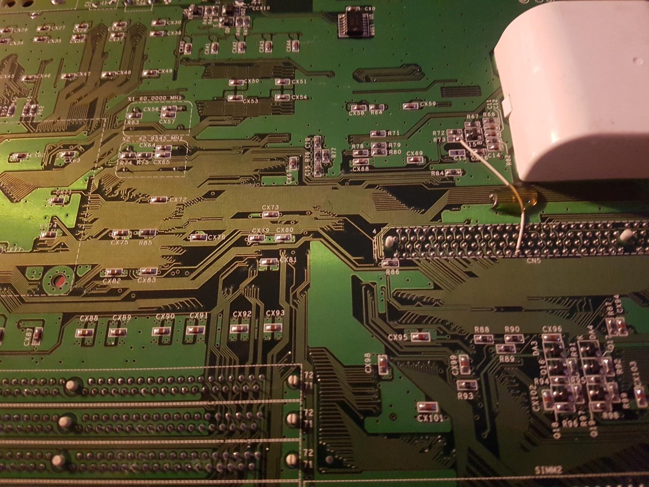

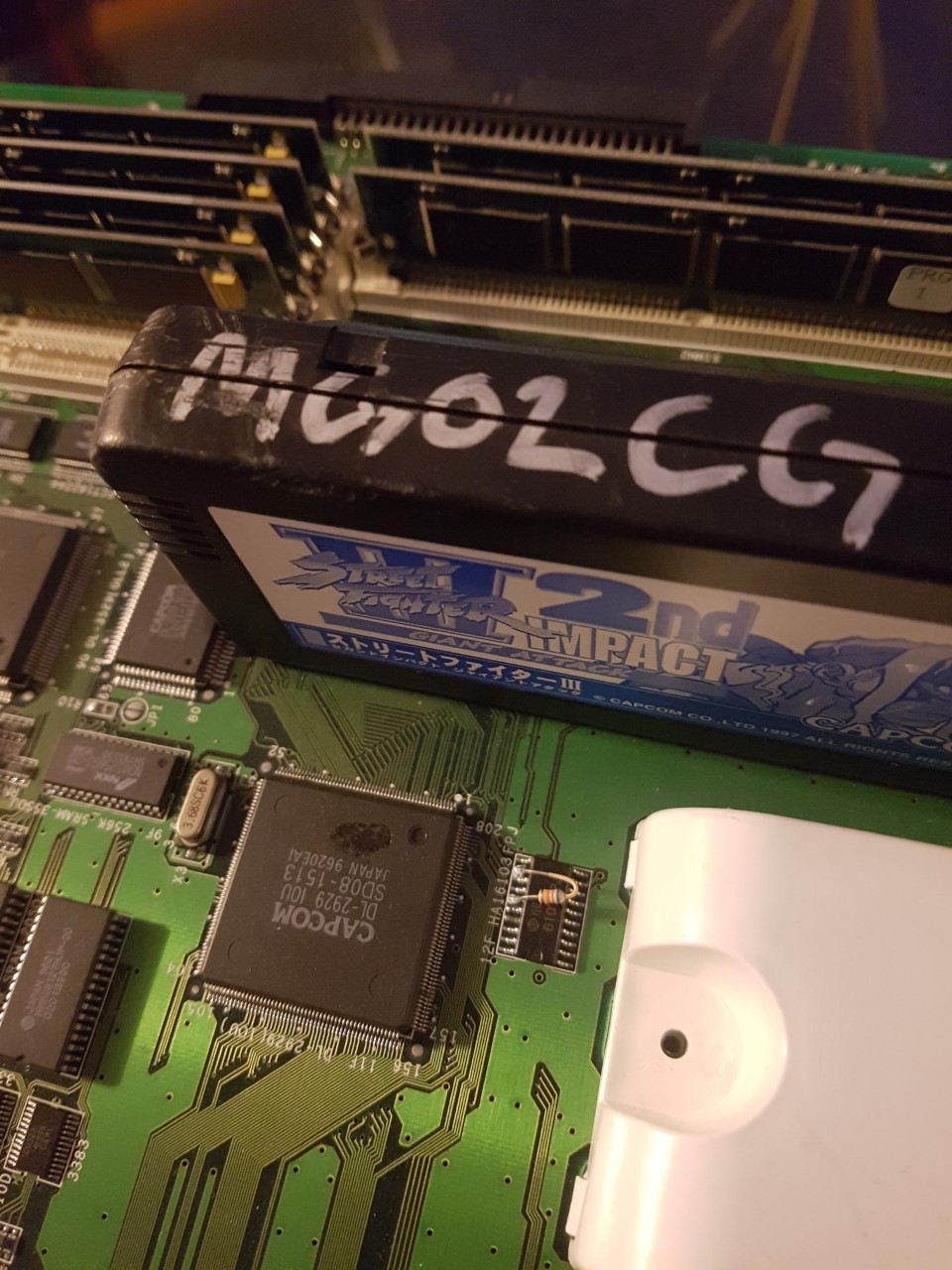

so here's some pictures along with voltage infos from my cureent PSU
5v = 5.03
12v = 11.39v ( a bit low )
CPS3- board model 95682A-3
also .. i spoted some stuff... that i don't think belong there ...like a cable going from the cart and another resistance
anyone has any ideas of the problem ?

Before you do anything else, clean the contacts for the security cart, and really make sure it's seated well. This problem can happen just from the cart not being exactly positioned right.
  • Like
Reactions: nem
That wire is normal. There is at least 2 revision with jumper wire. Like Aurich said clean the contacts. Next get a light and check the card connector. I recently picked up a non working board that had 4 bent/broken pin. I end up replace the connector and flash the superbios and it worked.

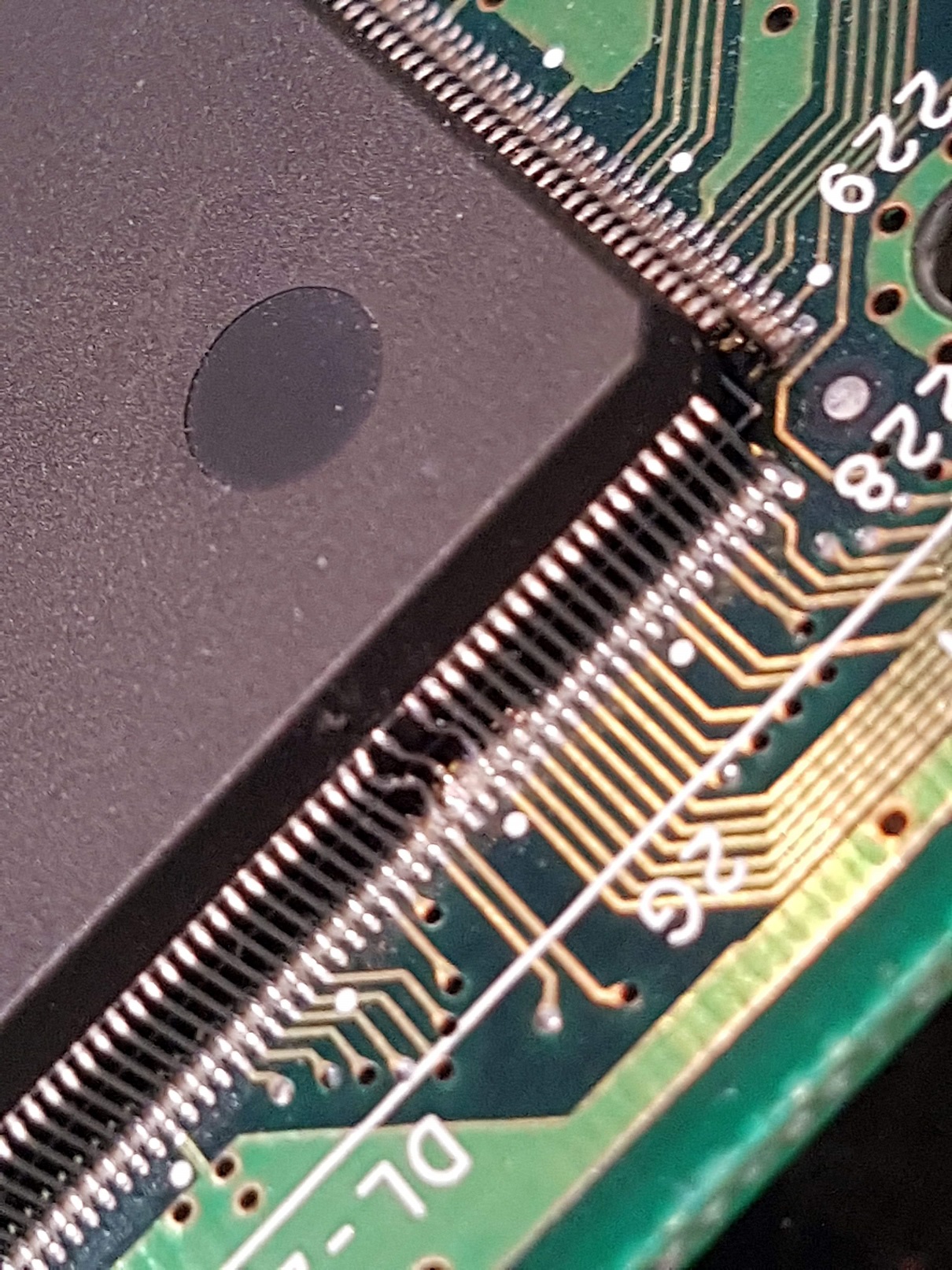

I had this exact thing happen to one of my cps3 set ups and it was the motherboard. I still have it so if anything gets found out I'll be very curious and hopefully I can fix mine.
oooh.. this is certainly not helping.
And.... Just touching the leg made it fell off....
Good news is i found the problem.
Bad news is i think itz dead..
