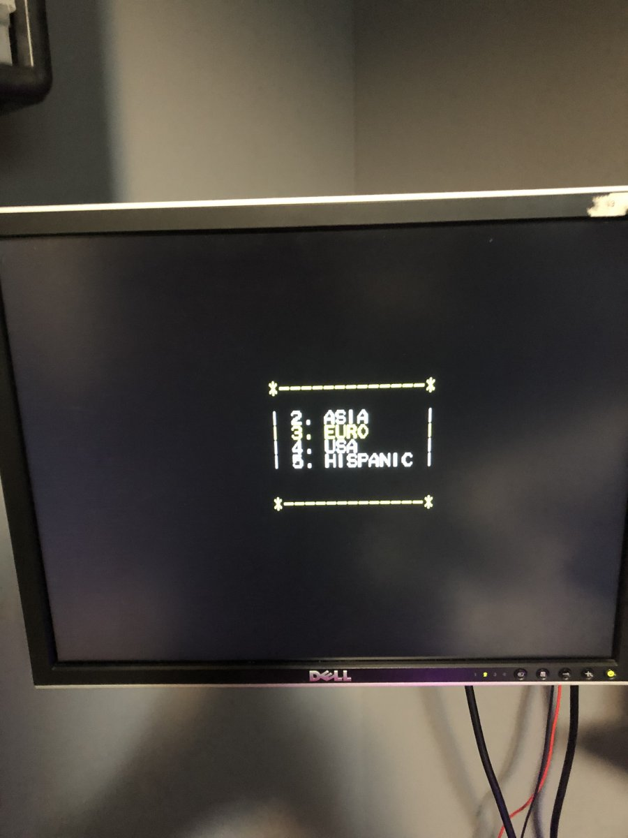

I have a cart from Darksoft and the CPSIII ultra simm kit but when I power on the board with just the cart I get this
It seems to be missing 1, 6 and 7 and there are color issues
Anyone have any ideas?

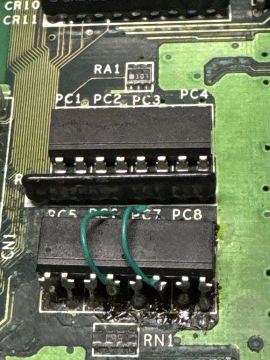

This does look suspect

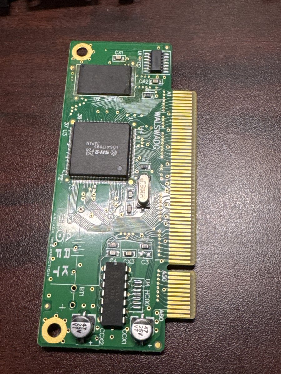

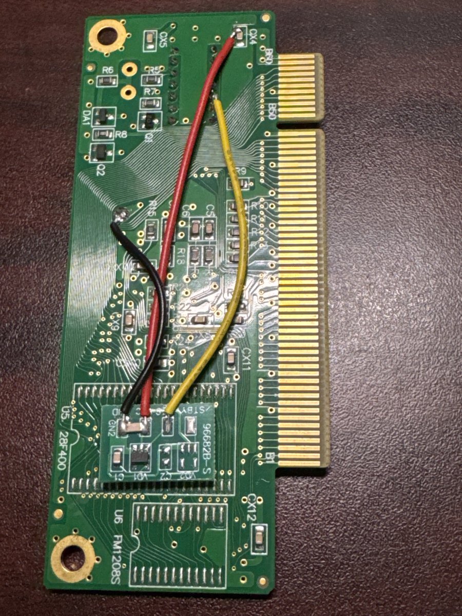

Your security cart looks fine. That piggybacked chip in your post from yesterday looks very dodgy - can you post a zoomed out picture so we can see where it is on the board?
Those are the photocouplers connected to the kick harness at CN1
