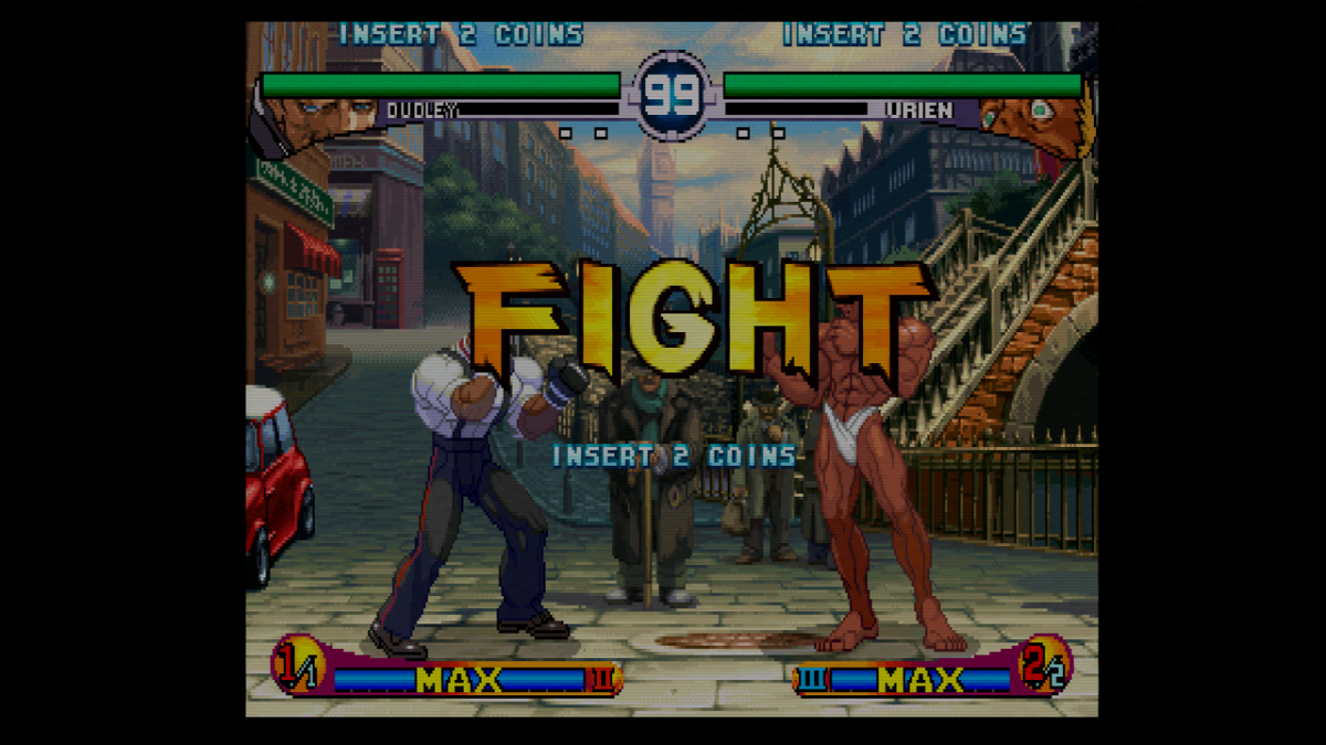

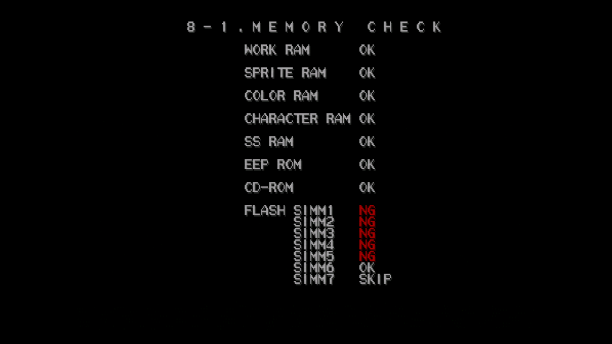

I took some direct captures of the game that was already programmed there 2nd impact after the fix, then I programmed 3S just to test further.
