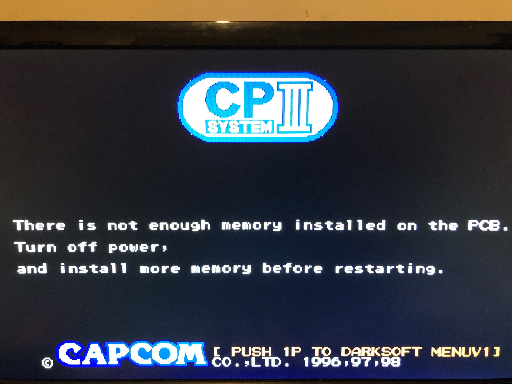

Hey guys I finally got all the parts that I need and time to setup my cps3 multi. My board came with 5 simm's pre-installed. Ran into some issues.

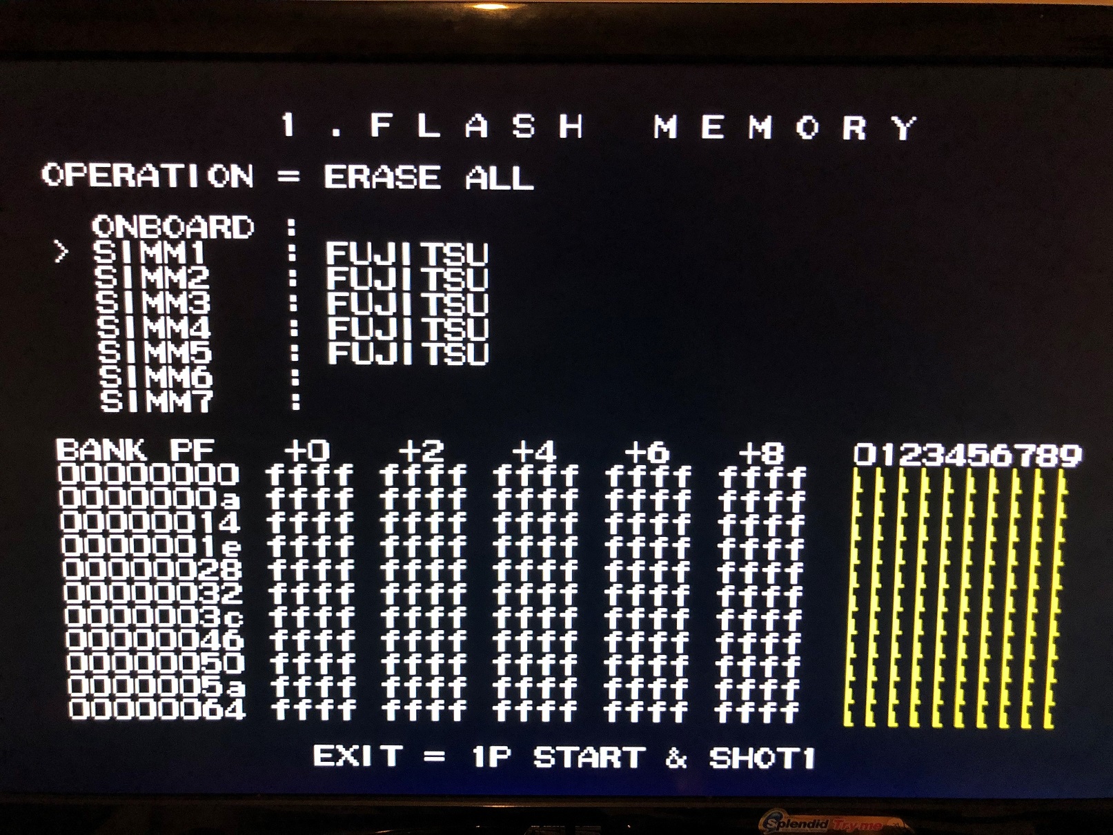

When I tried to install any of the games I would immediately get "There is not enough memory installed..." error. In Darksoft multicart menu I select option 1 and all 5 simms show up. I hit button 2 and found option to erase simms, did that on all simms. Tried installing games again and still not working. Is there any way i find out which simm is not working properly.

You need 6 simms in total, not 5.
It's 2x64Mb on the right part of the board and 4x128Mb simms on the left top part of the board.
