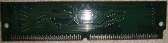

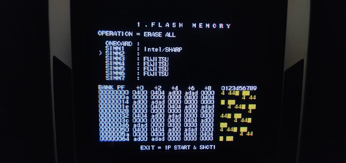

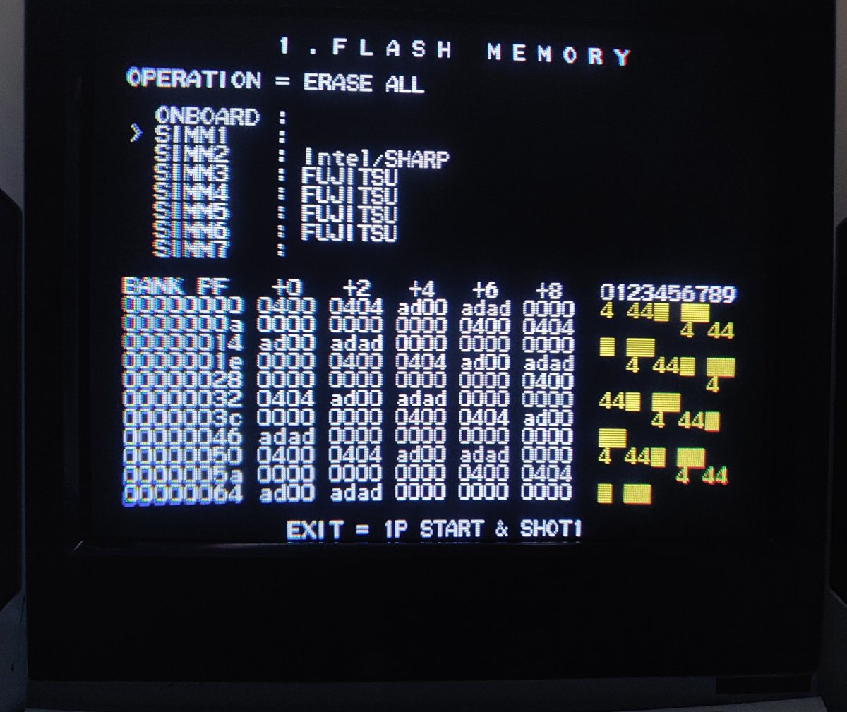

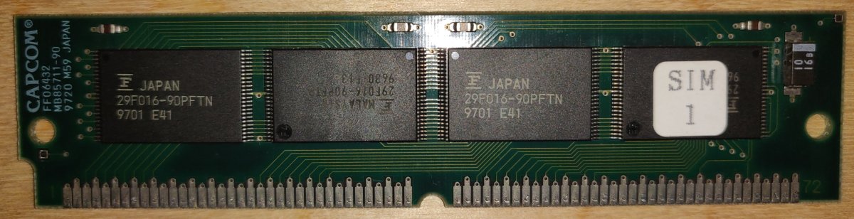

Cleaned things up, still having problems with one of the 64 MB Simms. I cleaned the contacts on the UltraBIOS cart and it's booted fine every time since then. But every time it's booted, I get the "There is not enough memory installed on the PCB. Turn off power, and install more memory before restarting." error. I went into the Darksoft menu by holding 1P start at boot, then in Flash Memory, it only lists 5 Simms; Simm 2 is Intel/SHARP, and Simms 3-6 are FUJITSU. Nothing in Simm 1. I took them all out, cleaned the contacts, and reinserted them; same issue. I took Simms 1 and 2 out, cleaned them again, and same error when I put them back in. I took 1 & 2 out again, swapped them, and now Simm 2 isn't detected. So it has to be a problem with the Simm, right? Here it is:

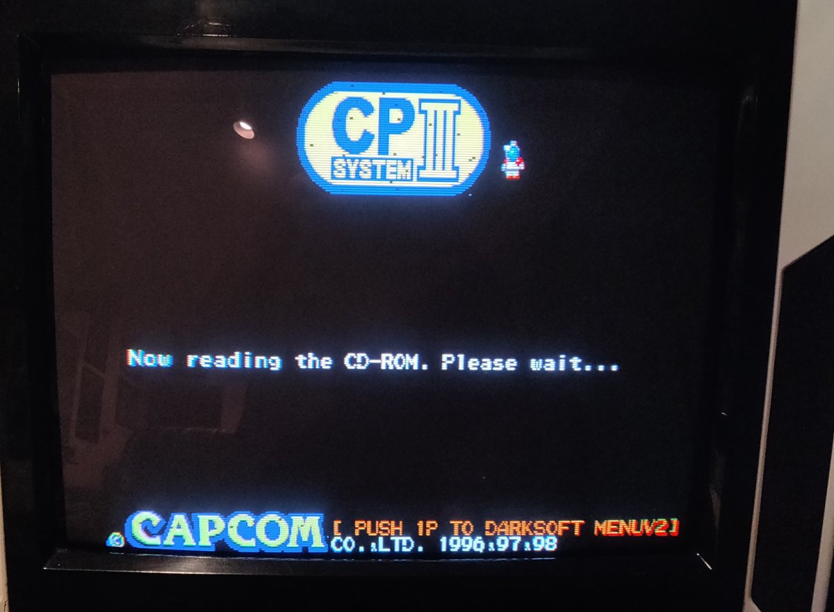

Is there anything noticeably wrong with it? Are the original Capcom 64 MB Simms prone to dying? I don't think the SCSI2SD is causing any issues, it's loaded through the "Now reading the CD-ROM. Please wait..." screen every time on the way to the Darksoft menu. And when I try to write a new game, all of the games are listed, choosing one just throws the not enough memory error. It also gave the memory error when I tried booting with nothing attached to the SCSI port.
Maybe it does detect the Simm. The values are constant, they don't fluctuate like they do in Onboard or Simm 7.

Sounds good, I'll keep cleaning. Does the Flash Memory status of that one Simm indicate that it's the one with the issue? Or is it normal to have one with no brand name?

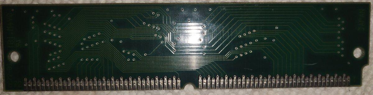

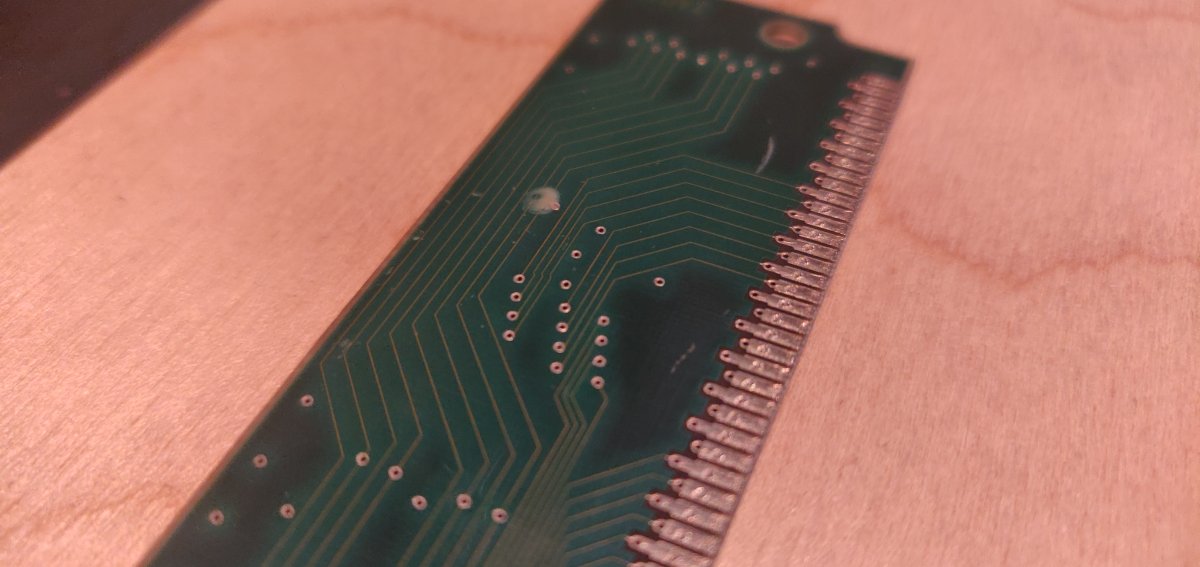

what's this glue or cut way?
Yeah, I noticed that. It was on the Simm when I got it. It's a very thin layer of glue, I think. Here's a better picture:

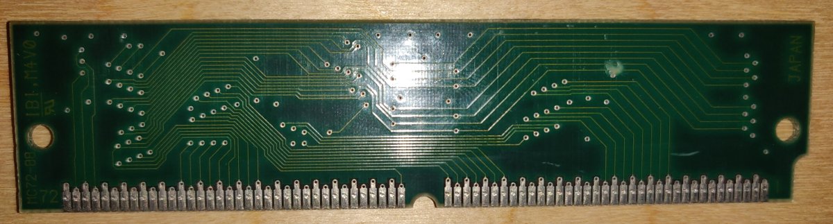

I just cleaned it off, the traces underneath look fine:
swap with the second 64mb simms and retry the test.
Yes, I had tried that. Here's the original Flash Memory reading:
And here it is after I swapped Simm 1 with Simm 2:

As much as it might seem like a pain in the ass to do, The traces on the simms aren't all that bad to eyeball and test continuity between. Always a chance one of the actual memory chips or components could be bad, but, still, just to rule out trace issues, would be worth it to break out the multimeter, grab a drink and go to town.
Worth a shot! So on the back side, test continuity between the pins on the bottom and the holes that they lead to?
yup, though of course you wont be able to see the traces that lead underneath the memory, you can use This Post as a pinout reference for the 64mb simm. The 32/128 pinouts are different from the 64mbs.

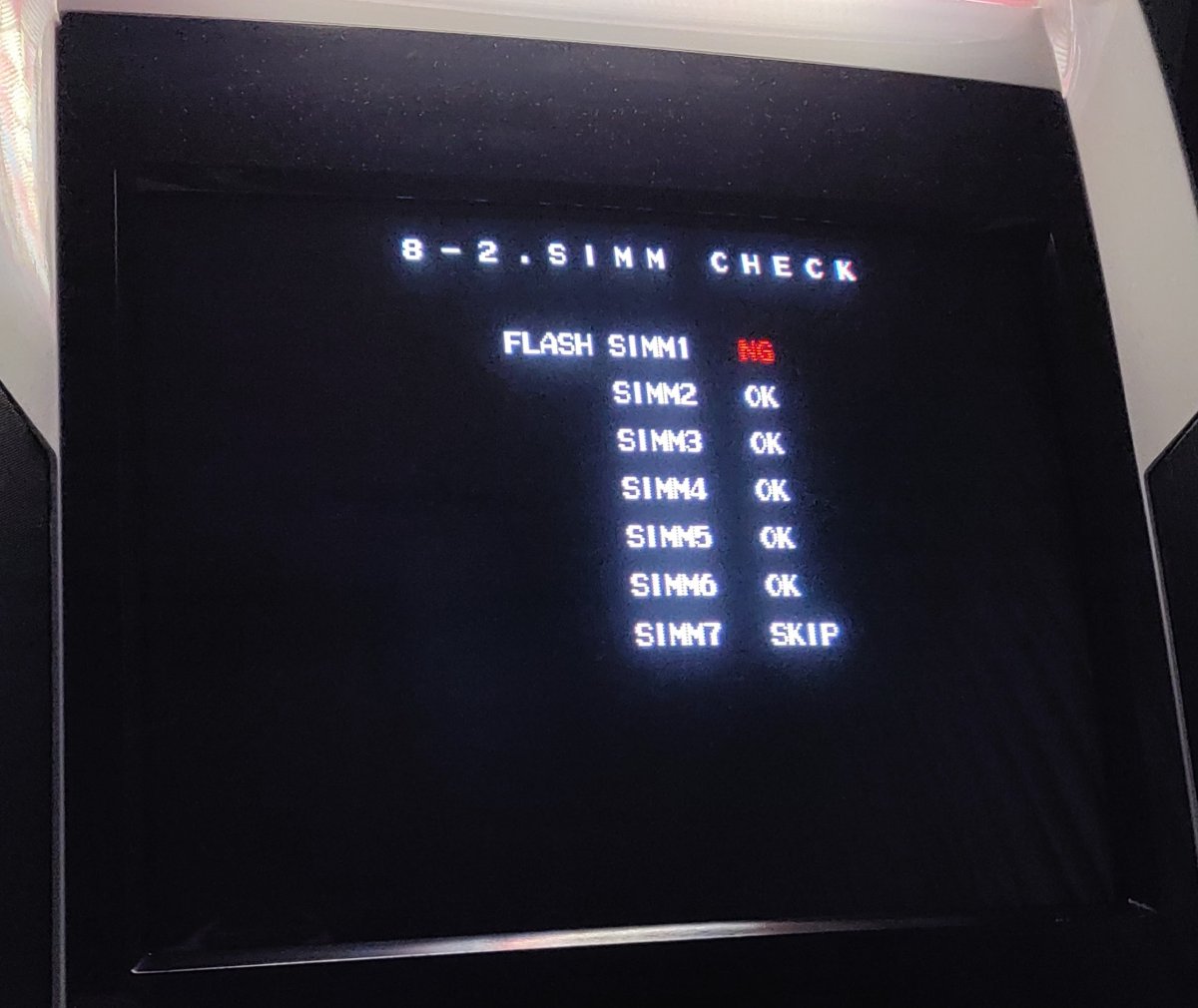

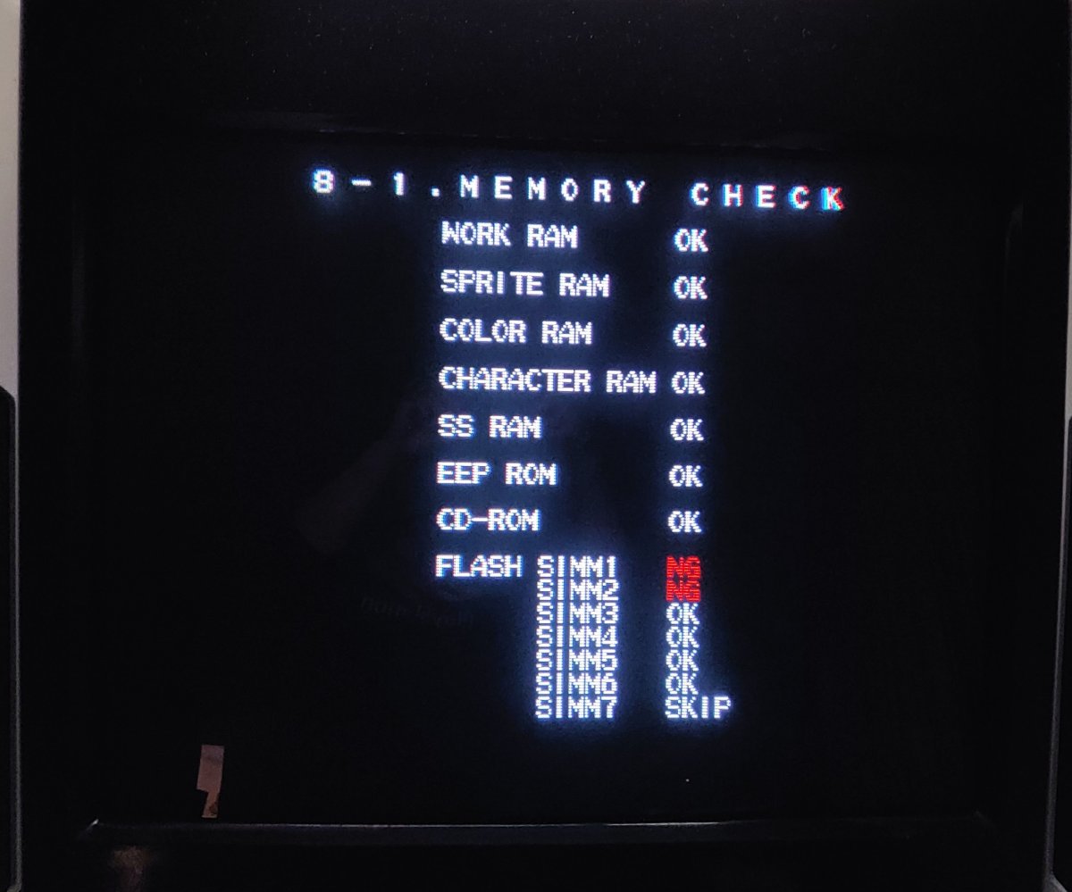

Thanks for the kind offer, but I think it's all set now :). I cleaned the glue off the back of the Simm, and cleaned the contacts a few more times with a pencil eraser and more q-tips & alcohol. The Simm was detected, but when I booted the game, nothing loaded. I reflashed 3rd Strike from my SCSI2SD, and that worked with no problems. The game booted after that, and I played through to the end with no issues. Here's the memory check and the Simm check:
I ran both multiple times, and Simm 2 was only NG during the memory check, but Simm 1 was NG during both. Is that normal?
Glad you got it working. Yeah, I forget where the exact post was, but there's something about the darksoft bios that makes that first simm always come up as NG like in that last pic. It's normal
