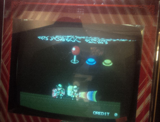

My arcade cabinet is doing a strange thing where the top of the picture is distorted and there is interference in the whites of the picture. It did this once before and then went back to working perfectly for a long time so I thought it was a board issue. :(
However, it is also a making a hissing sound now which has me worried. Is it the flyback or in need of cap kit or both?
Picture 1:
The upper left hand corner is screwed up

Adjusting your Horizontal Frequency or Horizontal Hold should clear that right up.
Have you ever done a cap kit on this monitor
If your flyback was bad you would notice sparks (arcing) coming from the flyback itself or blown fuses on your chassis.

I tried the typical monitor controls but while 90% of the picture stabilized the top portion was still screwed up. Also, it was working fine a few days before.
During the 8 months I've owned this cab there hasn't been a cap kit done. My gut feeling that the original owner probably didn't do one.
Then I would go ahead and do a cap kit. If you have dried caps then no level of adjusting is going to fix the issue.
