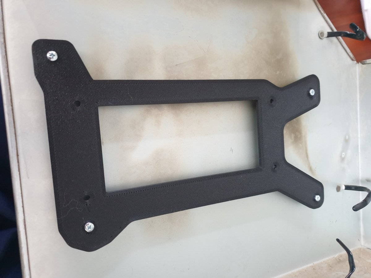

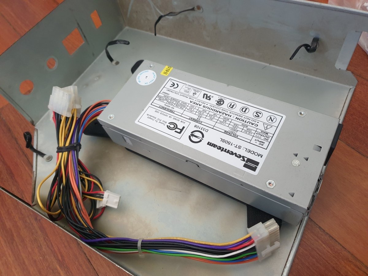

The power supply in my Cyber Lead needs a bit of maintenance, but I didn't want to stop playing games on it while I had the PSU out.

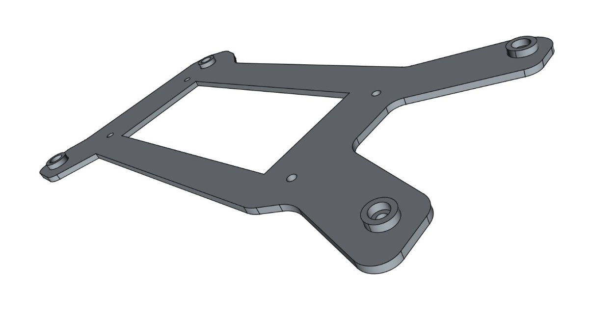

So I whipped up an adaptor bracket to mount a Flex ATX PSU - in this case, a Seventeam ST-150SL - in its place. I've also made an adaptor from ATX20 to the 15 pin internal power connector that the Cyber Lead uses, so this unit just slots right in with no modifications.
I figure it's not an item anyone else is going to want - this PSU's 4-point mount doesn't seem to be a Flex ATX standard. But I'm happy to share this if anyone else wants it.
