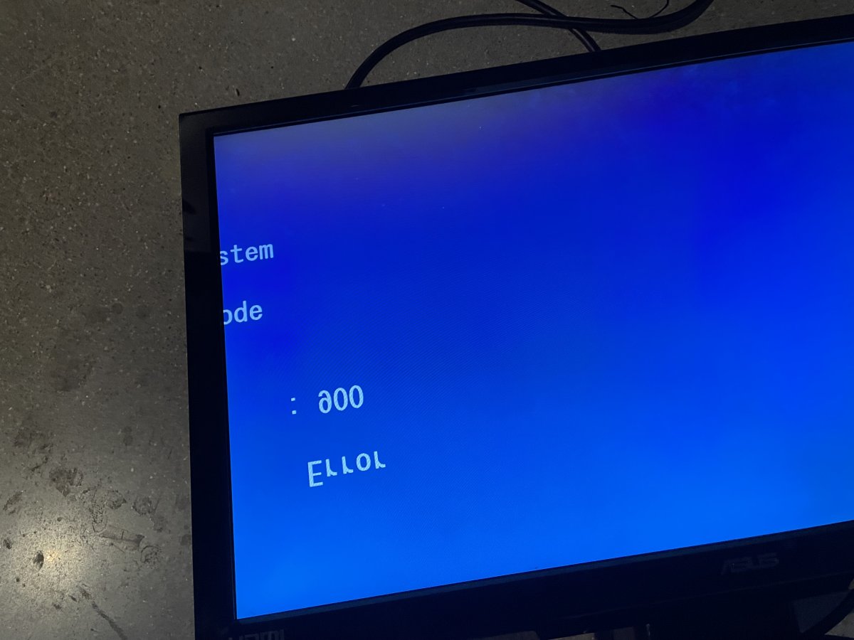

Received a darius Burst ex. Cab It doesn’t boot
Initial start up gives beep code 4233
Swapped hd and dongle to a nesica 215a (same model as original) error code 900

  • Error 900 is no USB dongle inserted - did you put the dongle in the correct slot? Are you sure the dongle is working?

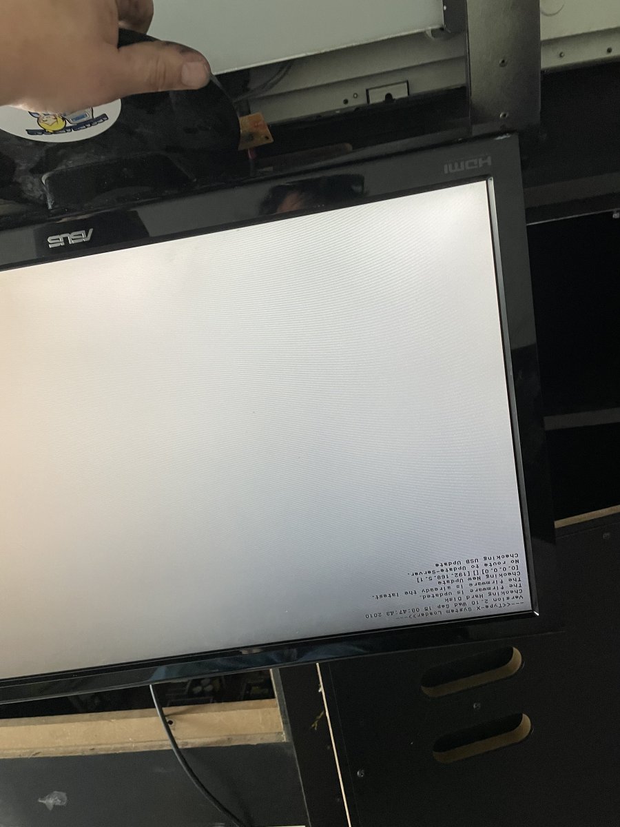

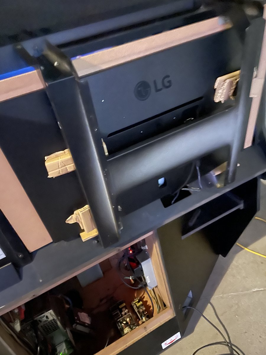

Well after playing with it more today I’m afraid both monitors are probably borked. I’m gonna insert new monitors and after I get those running… get some Edid spoofer things. Then go from there. Right now I can’t get either monitor to power on. But if I use another monitor I at least get video.

That would be nice if there is a cracked version out there that bypasses EDID? That would likely be ideal. Considering the dongle maybe toast.

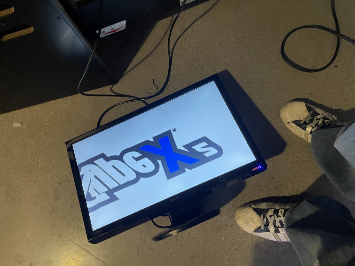

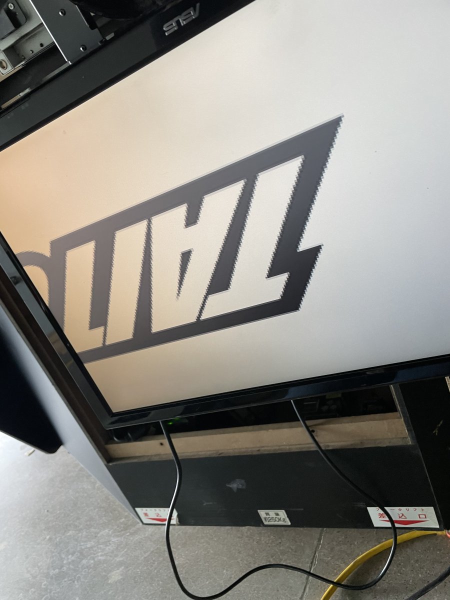

Confirmed that both monitors are dead (card board is temporary) just trying to line it up.
Seems like the aspect ratio is off? I put it to 480 and 720. Idk.. I’ll swap i the other dip switch (I don’t see any dips just a black box) what’s the correct aspect ratio?
Regardless still getting the 900 code so… I’ll try to source an image or a dongle.

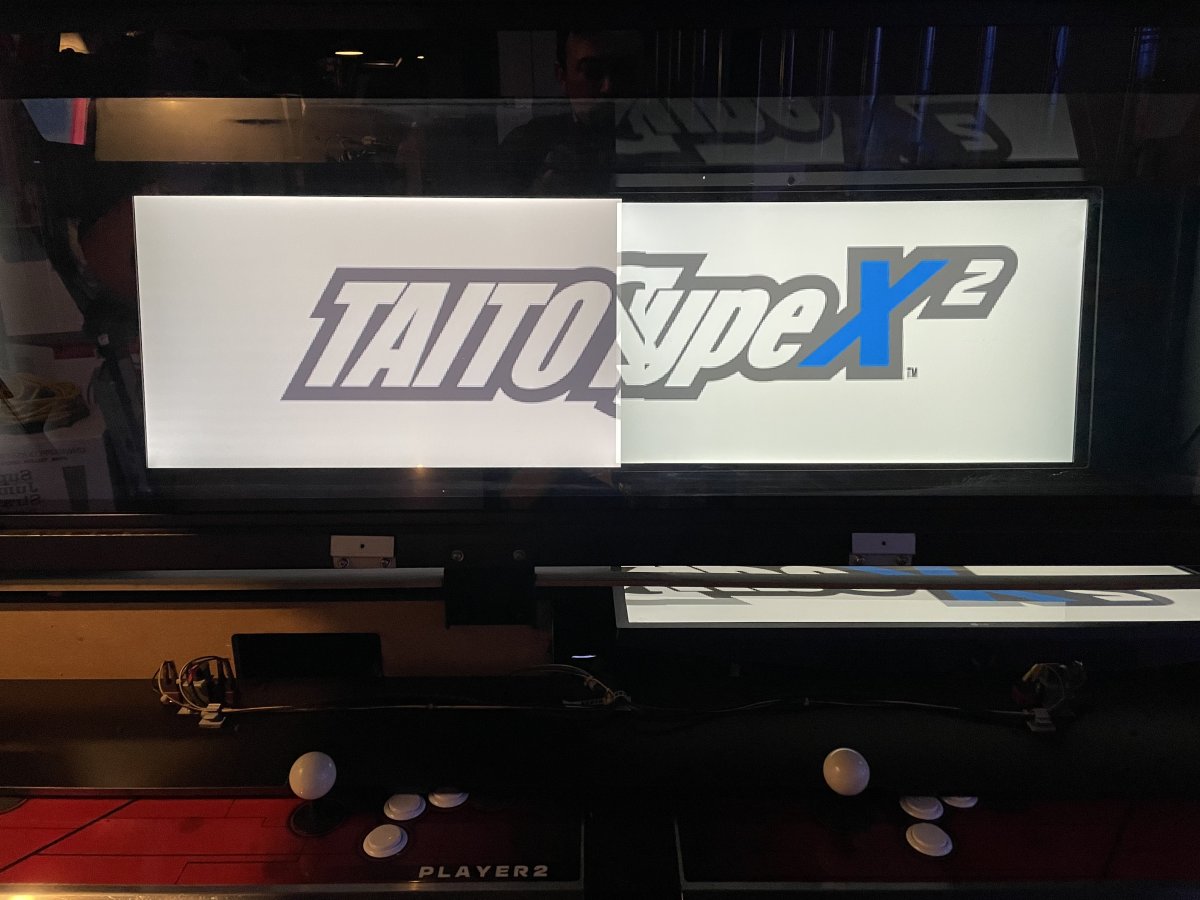

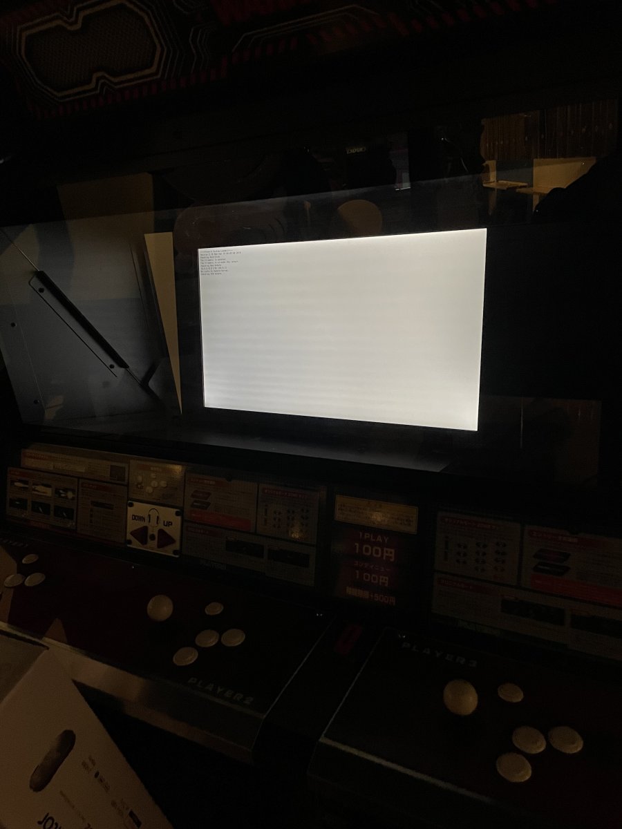

Finished putting in two new monitors still having issues. I’m hoping if I get darius to boot the aspect ratio piece of it will be ok in game. Waiting on a dongle from a friend to see if that’s the problem. I still think it won’t help with the edid problem

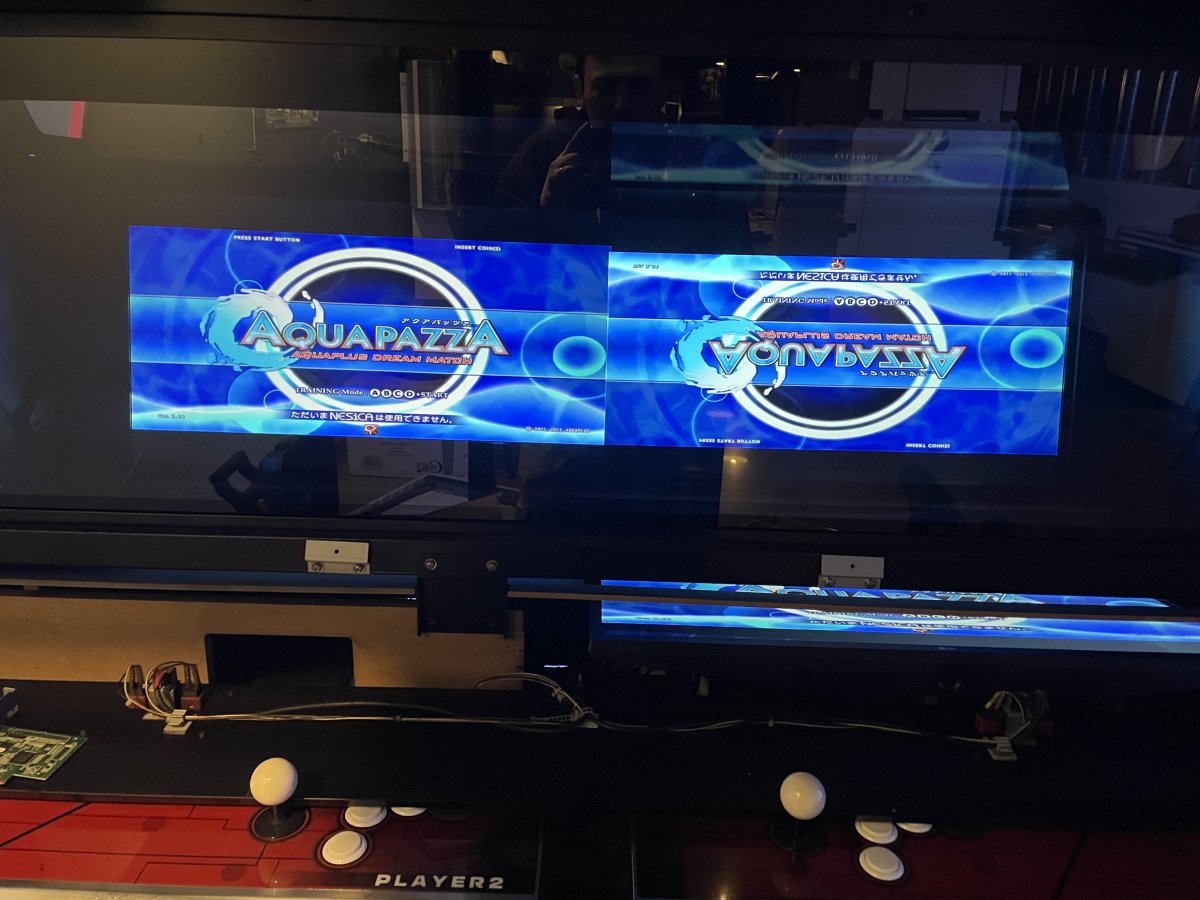

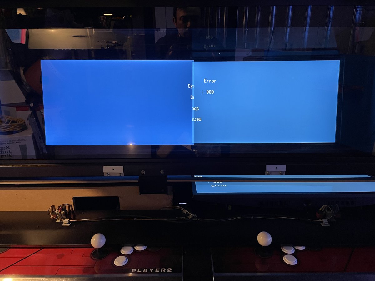

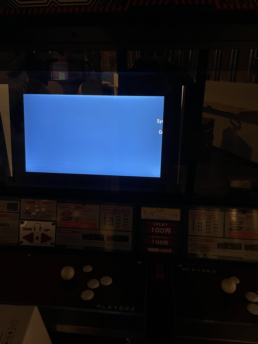

Ok… so I’ve tried two known working hard drives and dongles one from a version b “unlocked” and a regular one. Still system 900 on regular and it just freezes up on ver.b when loading I’m wondering is there a special firmware for the video card or something I can’t seem to get this to boot… it’s a stock 7900gs from a nesica Clive version (the stock one was doa)
I wasnt aware this game ran this level of EDID check its actually looking for the Model Name/ID info, thats kinda wild. I know some of the more modern Japanese LCD cabs can be really weird when it comes to them trying to lock operators out of simple parts replacements lmfao this just seems kinda dumb and I can only think of 1 maybe 2 other cabinet examples off hand that do something remotely like this.
Too bad its not something simple where its like well the board just Expects some kind of EDID period and if it cant find it it wont output. Jubeat will do this and the fix is moving the video cable to the other input port on the monitor because the EDID output fails on the port or something like that LOL.

I’m not sure if it’s Edid cause I get system 900 not the other message
DBAC will work with standard 979GS ("7900") firmware used with the TX2. It is not special in any way. GPU is not the problem if you confirmed the GPU is working. It is important to note that it either has to be a real Elsa Gladiac 979GS, or it has to be a 7900GS flashed with the correct firmware.

The EDID check is for a very specific LG monitor that was used in the cabinet. You can spoof it with the right equipment, but that's a problem for later IMO. You need to get the game to fail the EDID check first before you start worrying about it! :) The EDID check doesn't happen until the game has already finished booting and begins running the startup checks; system 900 happens when you first turn on the board, before the game even begins the decryption process, so the issue is either the dongle is bad, or the board has a fault preventing the dongle from being read correctly.

No, 900 is a dongle error. Has nothing to do with I/O.
