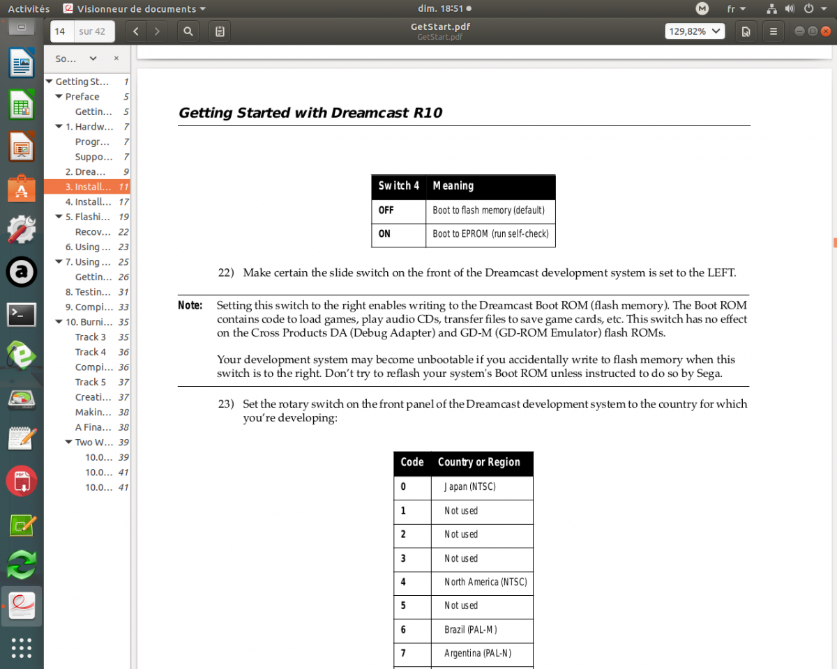

in the Getting Started with Dreamcast R10 manual it is written
"Make certain the slide switch on the front of the Dreamcast development system is set to the LEFT.
Note:
Setting this switch to the right enables writing to the Dreamcast Boot ROM (flash memory). The Boot ROM
contains code to load games, play audio CDs, transfer files to save game cards, etc. This switch has no effect
on the Cross Products DA (Debug Adapter) and GD-M (GD-ROM Emulator) flash ROMs.
Your development system may become unbootable if you accidentally write to flash memory when this
switch is to the right. Don’t try to reflash your system's Boot ROM unless instructed to do so by Sega.
