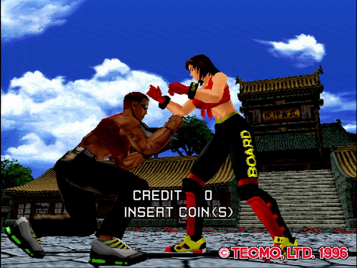

Hello, I recently got a DEAD OR ALIVE MODEL 2 A-CRX board.
It’s working well, but I’ve noticed diagonal lines appearing in the video.
My wiring: PSU - MODEL2A - JAMMA harness - SuperGun(CBOX USB v2) - RGB SCART - OSSC - HD60 X (capture)
I confirmed that the PSU output is clean.
Lines are noticeable in the blue sky area.
Has anyone else encounter this issue?

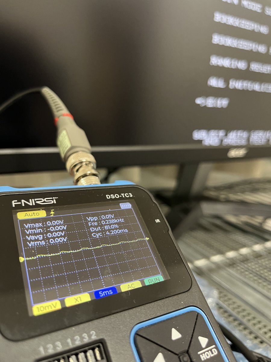

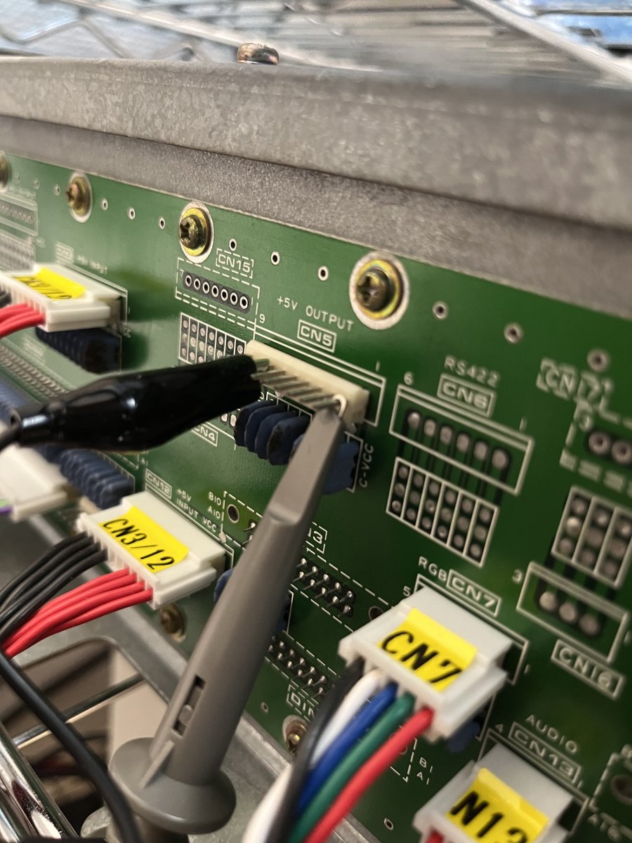

I inspected the +5V output from the board.
While the service menu is displayed, I observed slight noise, but there were no visible lines on the screen.

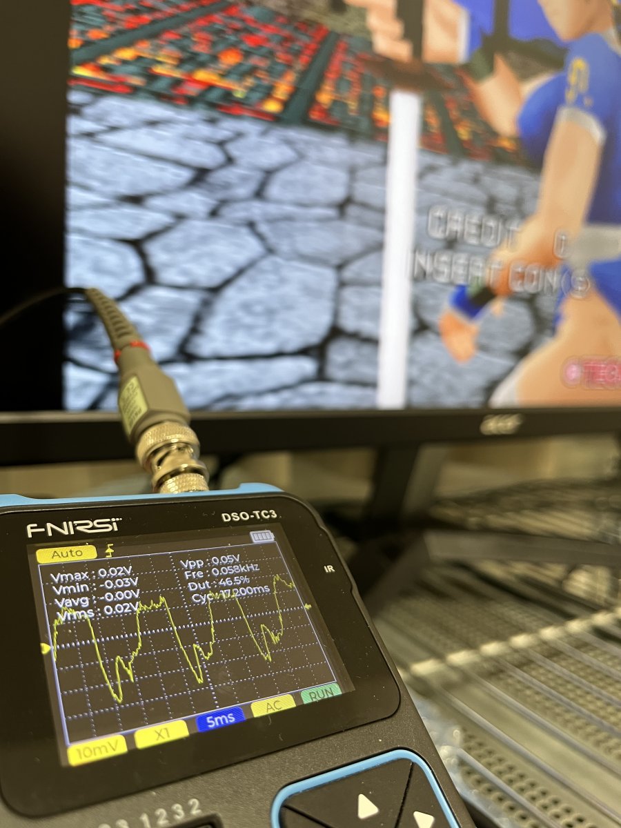

However, when the video board initiates 3D rendering, the noise increases, and the lines become visible.
58Hz frequency seems to be the same as the frame rate of the game.
I guess noise is produced on the video board but I'm not so sure.

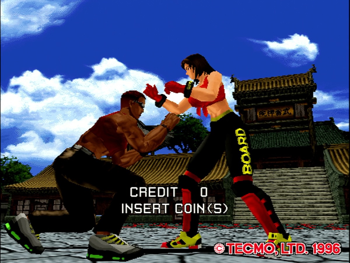

Finally got the flawless image!
Here are what I did.
Shielding SuperGun from EMI
First, I shielded my SuperGun with aluminum foil.
Diagonal lines were weaken.
I guess radiated noise from the PSU or the MODEL2 cage (or both) interfere the SuperGun.

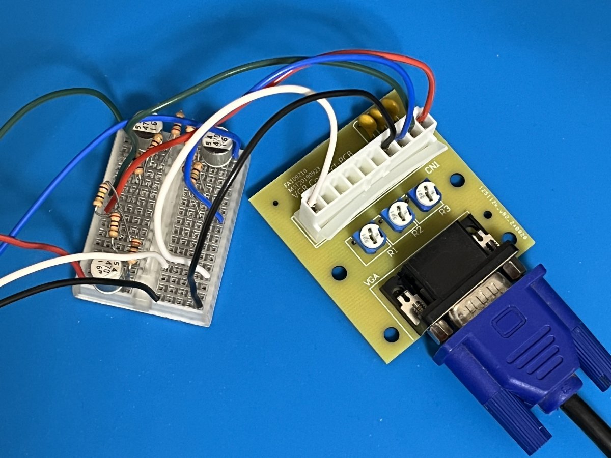

RGB to VGA adapter
Then I created this RGB to VGA adapter.
Video signal(R/G/B) -> 470uF -> 475ohm -> VGA
Perfect! Diagonal lines have been disappeared!
Also edge noise has been decreased, color tone has been richer.
I'm so satisfied with the result.

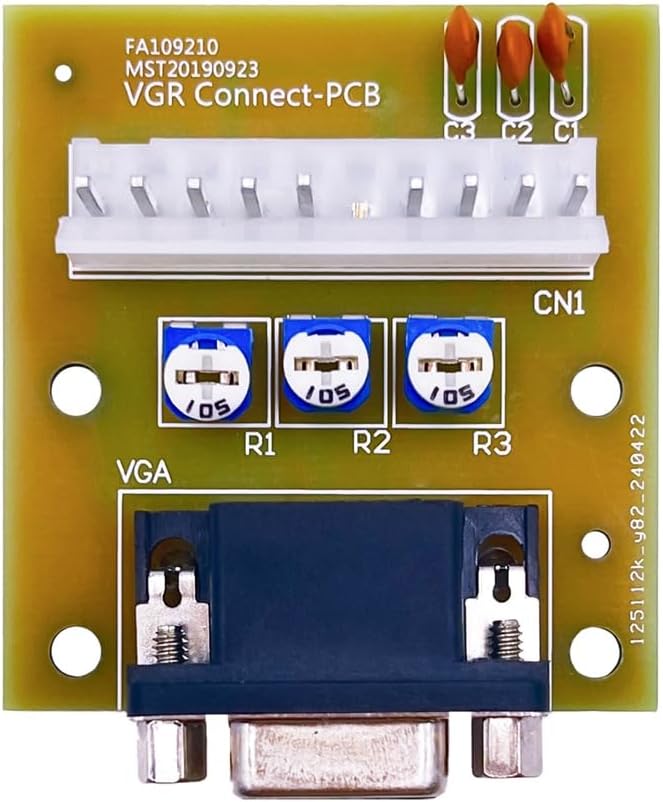

EDIT: Wait, in your photo you have 470uF and 475ohm resistors on the breadboard. The RGB lines already have 470uF (Maybe 470pF actually) caps on the adapter, and the pots should be 500ohm, so you can crank them up to 475, as they appear to be cranked all the way down to 8, lol. You have created a CGA adapter on the CGA adapter where you only needed the additional caps and resistors if you only had a VGA connector.
I am new to electronics so there may be mistakes.
Let me explain a little more.
CGA to VGA adapter
Potentiometers cause a lot of noise on the image, so I set all them to 0ohm. (the adapter was very cheap lol)
Caps on the adapter are bypass caps connected to GND.
Breadboard
I added 475ohm resistors on RGB lines instead of using potentiometers.
470uF caps are decoupling caps to remove DC offsets.

This is also the cheap adapter I use, I believe nearly identical component-wise to what you have, with no issue with a direct connection to a CGA converter. However, I do not own an OSSC either, just a GBS-8220 with GBS-Control adapter.

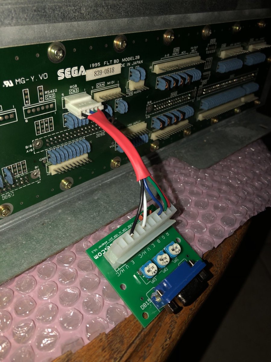

OK, I found the picture of mine.
It looks like components are almost the same as yours, but, in fact, the quality is pretty poor.
I've measured the resistance of potentiometers and found that range of resistance is up to 200ohm. (not 500ohm?()
In short, it's a defective product. (I guess the circuit pattern has some defects too.)
I should have bought the same one as yours. lol
But it just works for me as a D-Sub15 connector.
Just for your reference,

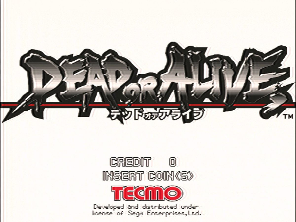

I connected the adapter to MODEL2 directly, set potentiometers to 200ohm and got the terrible image below.
I have OSSC and GBS8200+GBS-control, both result in the same.
When I set resistance to 0ohm, I can get clear but bright image which can be adjusted by potentiometers on GBS8200.

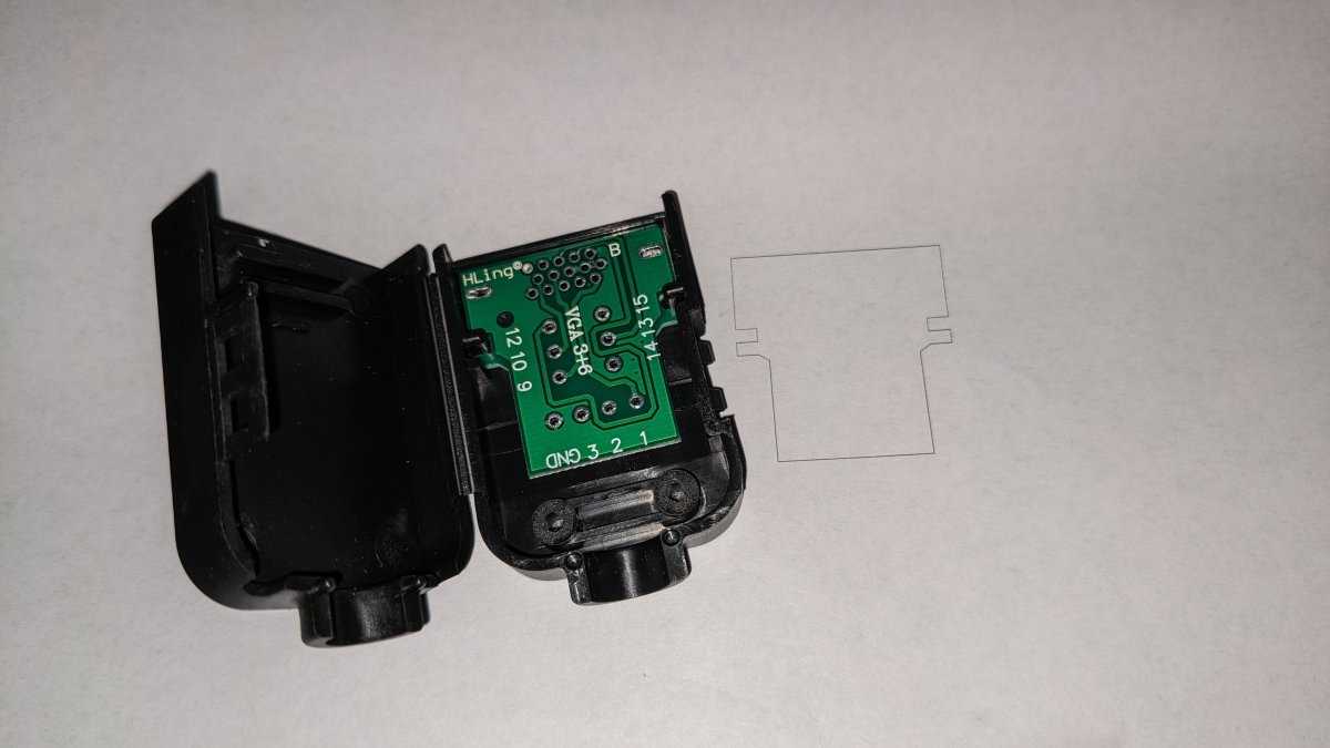

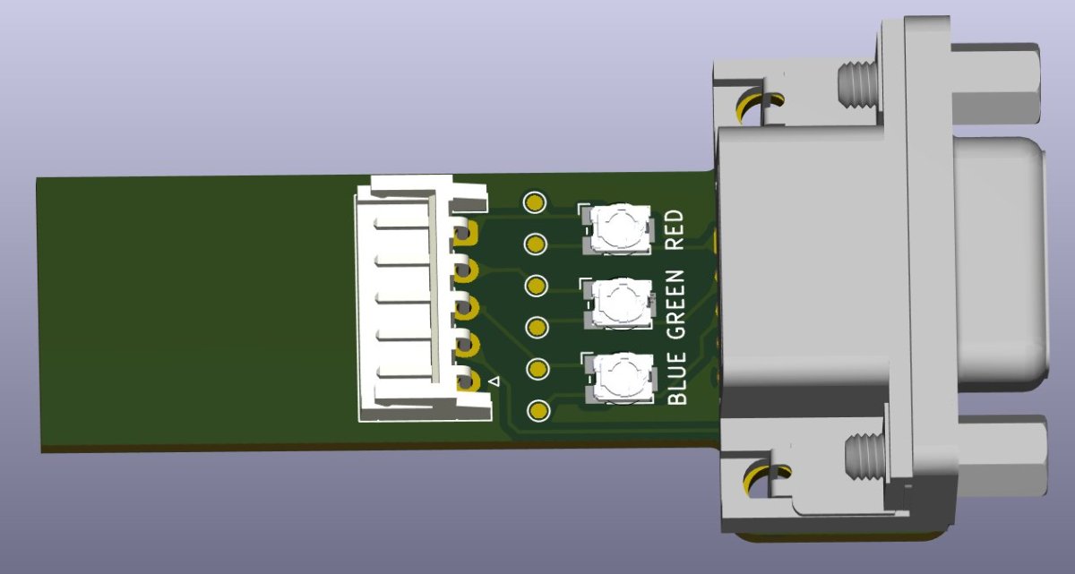

As I soon realized, this adapter I was making will put too much stress on the filter board's connector. I am revising the design and will incorporate the ferrite ring used by Sega for specific looms.
I will still test this adapter, however, as if this combo of pots and caps do not work, I will need to revise those as well.
I feel like you could just use longer wires and be fine, no? Let the PCB rest on the cab floor or bolt it to the wall depending on how the Model is mounted (or isn't).

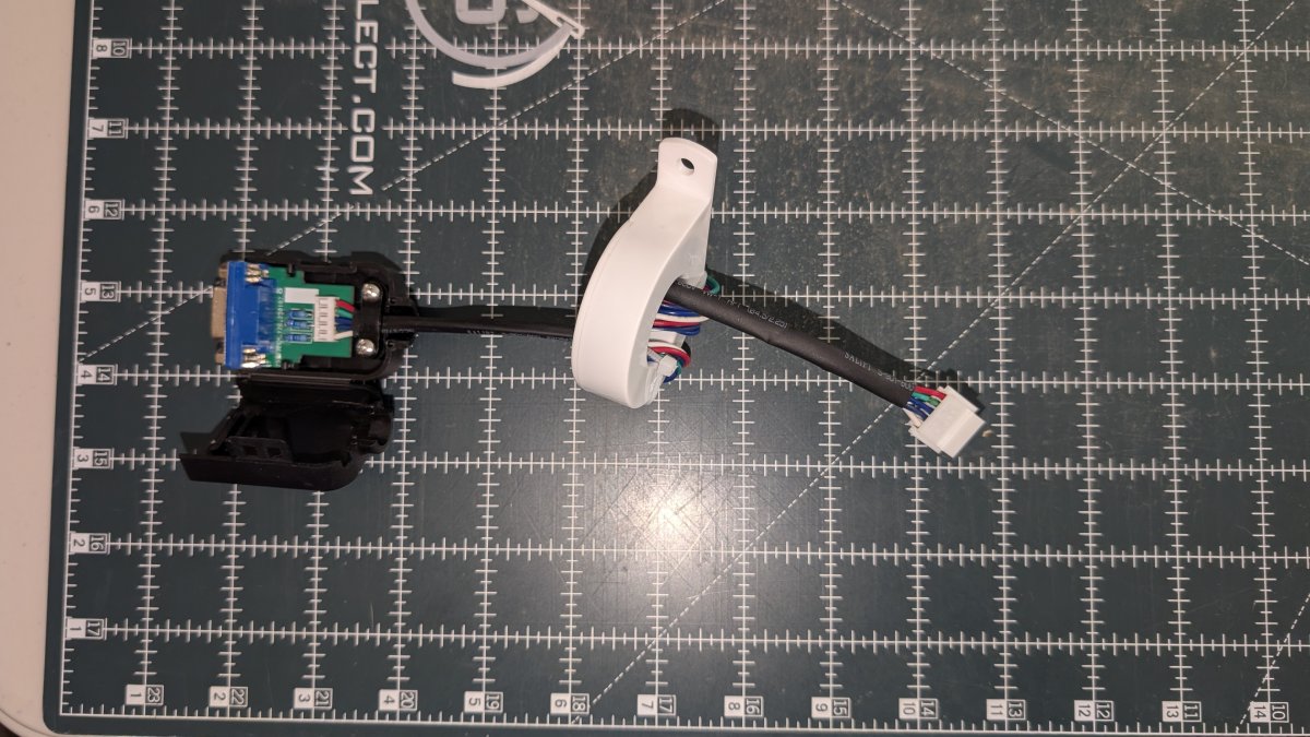

That's actually how I do plan on testing it, but it's not how I envisioned the design. Also, after installing the pots, calibrating them was a really, really painful process.

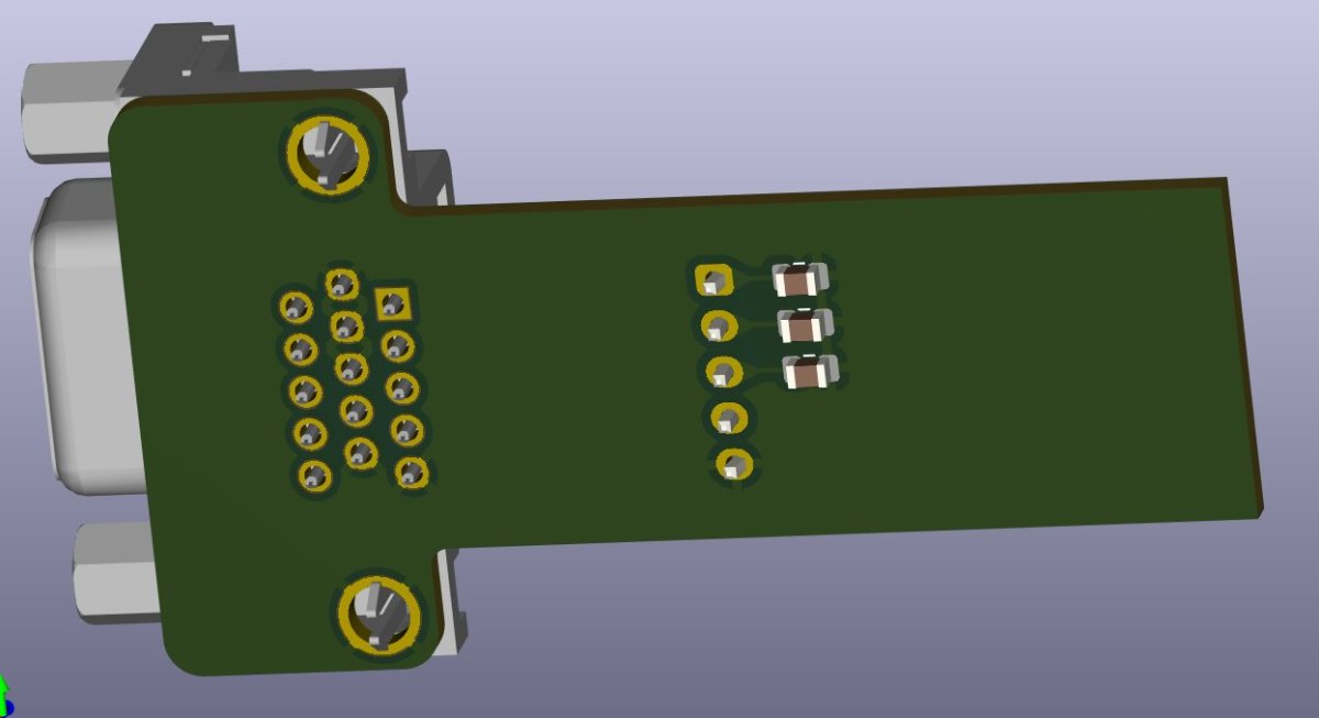

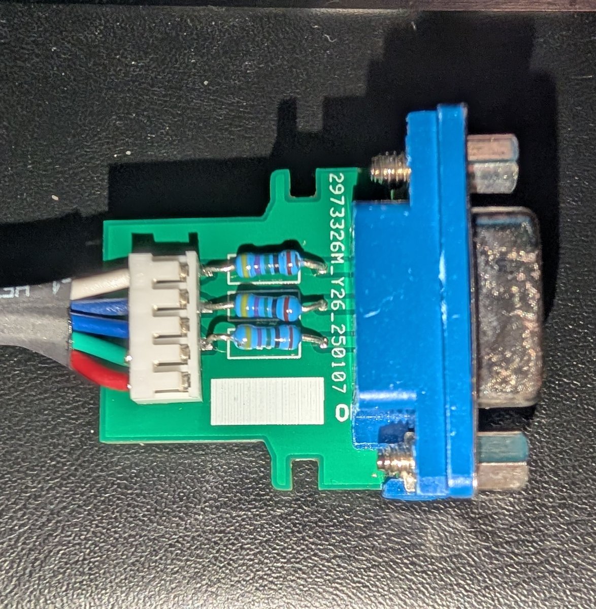

I've decided to skip the pots entirely in the next design and just have footprints for metal film resistors. It seems like most people know what they need (and/or are using resistors already) so I may as well go for high quality resistors in a PCB/Enclosure design rather than variable resistor pots.

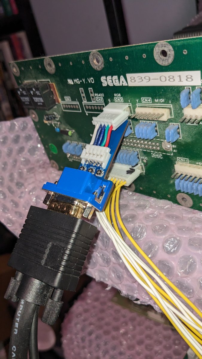

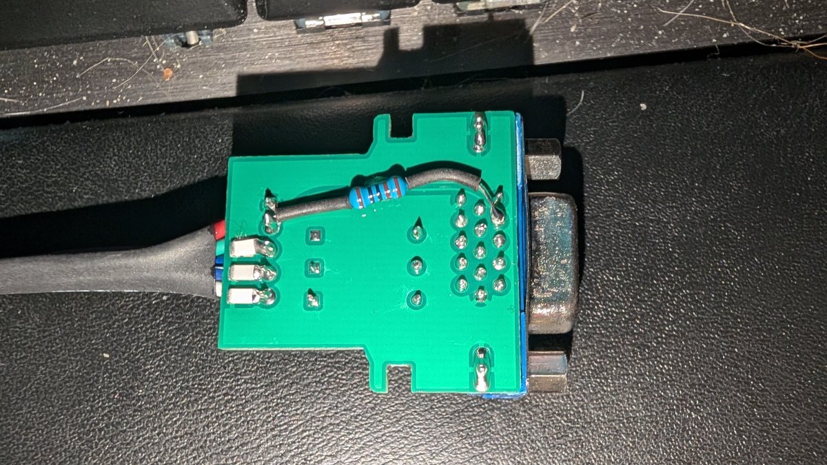

I tried, and failed, lol. Does not work. I am sorry.
Have you tried connecting the CSync from the MODEL2 to the VGA HSync pin? In the picture, it looks like it's connected to the VSync.
